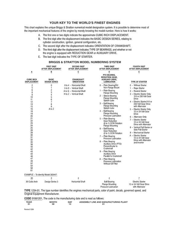

Jeff-C175 7,207 #3 Posted July 23, 2021 (edited) 35 minutes ago, bds1984 said: engine is the 18 HP is has ball bearings I'm not certain about this but I don't believe they all have the THRUST bearing though. A while back someone posted a briggs decoder ring for the engine model number and one of the numbers tells which crank bearing / bushing is installed. Edited July 24, 2021 by Jeff-C175 1 Share this post Link to post Share on other sites
bds1984 1,506 #4 Posted July 24, 2021 I've posed that number chart here many times. Look for the model number. Odds are in your favor it has ball bearings on the crank if it is 18+ HP. 2 1 Share this post Link to post Share on other sites
kpinnc 16,935 #5 Posted July 24, 2021 Got one just like it. If it has a PTO bearing, it is a small one. 1 Share this post Link to post Share on other sites
Jeff-C175 7,207 #6 Posted July 24, 2021 11 hours ago, bds1984 said: Odds are i That's the chart! Thanks for posting again. I need to print that out. Odds are perhaps, but not ALL. 1 Share this post Link to post Share on other sites
bds1984 1,506 #7 Posted July 25, 2021 (edited) As long as the second-to-last digit in the model number is a 2 or 3, the engine has a ball bearing crankshaft. I always look for 422437 or 422447 on the 18s. Edited July 25, 2021 by bds1984 1 1 Share this post Link to post Share on other sites
