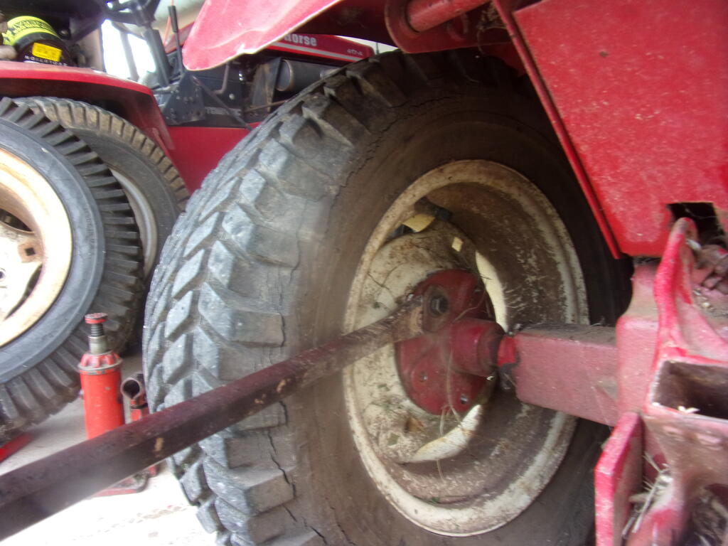

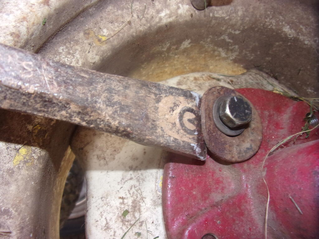

Ed Kennell 42,138 #1 Posted July 21, 2021 I tried loosening the lug bolts and drove in tight circles with no luck. A couple large washers bolted to the back side of the hub and a BFB did the trick. It popped right off. No danger to the axle snap ring. 5 1 1 Share this post Link to post Share on other sites
rjg854 12,243 #2 Posted July 21, 2021 I've used a sledge hammer and bounced it off the tire a few times in different spots, that worked for me. 3 Share this post Link to post Share on other sites
953 nut 60,330 #3 Posted July 21, 2021 inflate the tire to about 30 PSI and stand cler of the rebound of the thirty pound sledge. 1 Share this post Link to post Share on other sites
