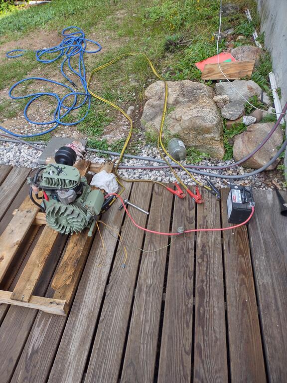

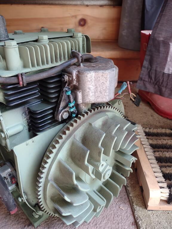

ebinmaine 77,821 #1 Posted July 21, 2021 I was testing the HH100 earlier today to be sure it had spark before I put it all back together. VID_20210721_095002072.mp4 VID_20210721_095002072.mp4 You can see some of how I had it connected in the picture below. Battery positive through the switch to the starter. Negative jumper I ended up moving to the oil drain spout but that was connected to the battery of course. Green wire that goes to the Magneto was connected to the M on the ignition switch. The small wire that comes out from behind the flywheel and goes up to the side of the ignition module was bare metal from being chewed on by a mouse. We surrounded it with electrical tape and zip ties. I believe the back of my ignition switch has the two large terminals for the battery cables which are marked B and S for Battery & Starter, R for Regulator, M for Magneto, L for Lamps? This was working perfectly fine while it was in the tractor. Did I not have enough connections? Did the switch need to be grounded? What am I missing and what can I do to diagnose this before I put the sheet metal on the engine? 2 Share this post Link to post Share on other sites
Thor27 855 #2 Posted July 21, 2021 Was the switch grounded? 3 1 Share this post Link to post Share on other sites
pfrederi 20,062 #3 Posted July 21, 2021 The switch needs to be grounded so it can kill the ignition system. 4 1 Share this post Link to post Share on other sites
ebinmaine 77,821 #4 Posted July 21, 2021 1 hour ago, Thor27 said: Was the switch grounded? 55 minutes ago, pfrederi said: The switch needs to be grounded so it can kill the ignition system. Switch was NOT grounded folks. I thought of that..... after. Super cool. Thanks. 2 Share this post Link to post Share on other sites
