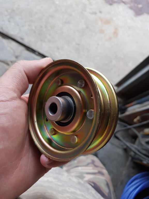

Bentoolong 94 #26 Posted July 29, 2021 If it were mine, I would definitely go after the idler pulley. I see that the belt doesn't ride in the center of that pulley. That may not be a big deal but a bad bearing in the idler would cause the pulley to move around (tip). Also I see the linkage/pedal jumping around a little. With a new belt and straight pulleys, I'm not sure that should be happening. Something is causing the effective length of the belt to shorten and then lengthen. That could be caused by a damaged/dirty/pulley or a bad bearing. Since the idler pulley is the easiest to deal with, take that off and check it. I'm not that familiar with your machine but a vert shaft machine will have the motor pulley supported by the engine bearings (lubricated) Same with the other end (transmission). The idler lives a tough/dirty life. I think you are getting close to getting this working well. Not sure why your engine is doing what it is doing but take care of your drive system. That may be part of your issue. Bentoolong Share this post Link to post Share on other sites
Andrea 20 #27 Posted July 29, 2021 25 minutes ago, Jeff-C175 said: Not sure what you mean by 'backlash' Andrea, could this be interpreted to mean 'resistance to turning' ? That idler pulley should freely turn with no resistance. Smoothly and without any noise or 'rough' feeling. Sorry....i was wrong on translating from italian language to english....backlash was not correct. I suppose that the correct term is "clearance". there's too clearance in in the ball bearing of the idler pulley. The movement is not fluid, it seem to turn the yogurth witha a spoon. 1 Share this post Link to post Share on other sites
Gregor 4,838 #28 Posted July 29, 2021 3 minutes ago, Andrea said: Sorry....i was wrong on translating from italian language to english....backlash was not correct. I suppose that the correct term is "clearance". there's too clearance in in the ball bearing of the idler pulley. The movement is not fluid, it seem to turn the yogurth witha a spoon. Speaking Italian might be better.We can maybe translate that. 1 Share this post Link to post Share on other sites
Bentoolong 94 #29 Posted July 29, 2021 (edited) I would replace the idler pulley. If you don't have experience with what the bearing should feel like, bring it to a trusted mechanic and they will let you know if it is faulty. I'd also check the pin/bolt/shaft that the idler bracket rotates around. make sure that is clean and has a smooth movement. Bentoolong Edited July 29, 2021 by Bentoolong 1 Share this post Link to post Share on other sites
Jeff-C175 7,195 #30 Posted July 29, 2021 5 minutes ago, Gregor said: .We can maybe translate that. I'm not sure what Mrs. Google translate would do with it! Share this post Link to post Share on other sites
Andrea 20 #31 Posted July 29, 2021 3 minutes ago, Bentoolong said: I would replace the idler pulley. If you don't have experience with what the bearing should feel like, bring it to a trusted mechanic and they will let you know it is faulty. I'd also check the pin/bolt/shaft that the idler bracket rotates around. make sure that is clean and has a smooth movement. Bentoolong Ok. I proceed to search for a new belt tensioner pulley. The belt tensioner arm is ok, I have cleaned and greased it. Thank you very much for the advice. Share this post Link to post Share on other sites
Jeff-C175 7,195 #32 Posted July 29, 2021 11 minutes ago, Andrea said: I suppose that the correct term is "clearance". there's too clearance in in the ball bearing of the idler pulley. OK, I think we understand now! In other words, the pulley rattles around, it is loose on, the bolt that holds it to the bar? That should not be. That bearing may show a tiny bit of 'play' or 'movement' about the bolt (or the center part of the pulley bearing) but if that idler pulley is LOOSE on that bolt then it must be replaced. Share this post Link to post Share on other sites
Andrea 20 #33 Posted July 29, 2021 Just now, Jeff-C175 said: OK, I think we understand now! In other words, the pulley rattles around, it is loose on, the bolt that holds it to the bar? That should not be. That bearing may show a tiny bit of 'play' or 'movement' about the bolt (or the center part of the pulley bearing) but if that idler pulley is LOOSE on that bolt then it must be replaced. Yes sir. the ball bearing placed in the idler pulley rattles and move. I think i will proceed with the replacement, thanks! 3 Share this post Link to post Share on other sites
Andrea 20 #34 Posted August 12, 2021 Pulley arrived, tomorrow I will proceed with the replacement 3 Share this post Link to post Share on other sites
Andrea 20 #35 Posted August 13, 2021 I installed the new pulley. The noises have disappeared and the belt now no longer has axial movements. thanks everyone for the help 3 2 Share this post Link to post Share on other sites
