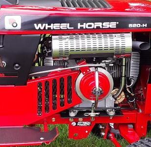

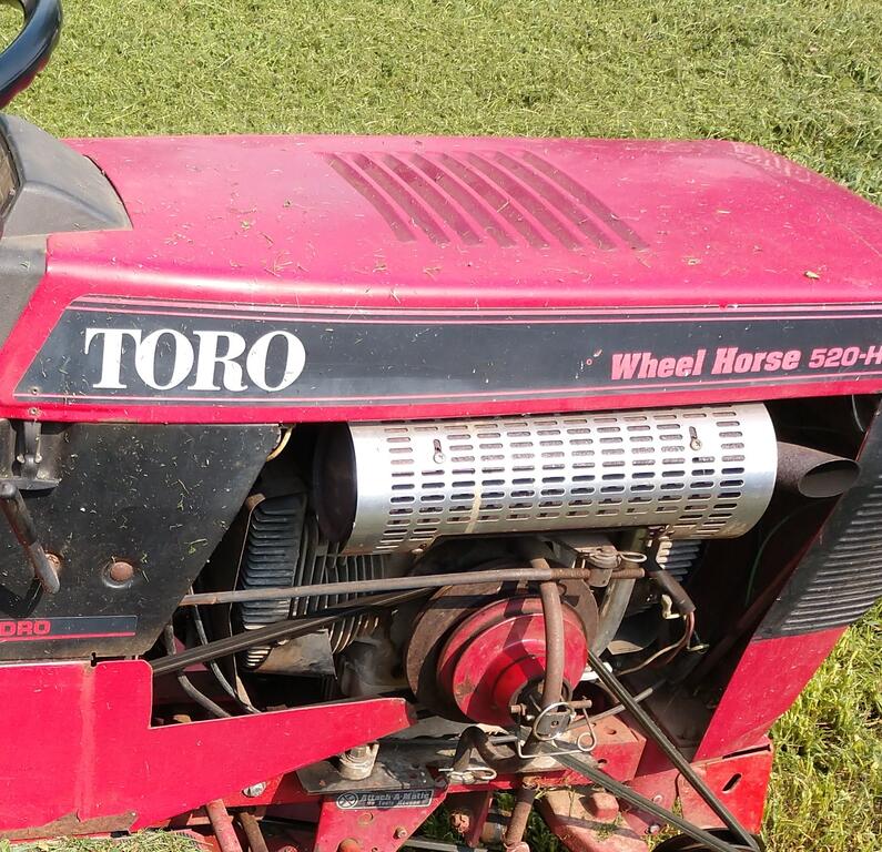

kpinnc 18,756 #30 Posted September 7, 2021 (edited) If the rear rod is broken, you need to check the rear valve seats. This is unfortunately a common failure on a Onan-equipped Wheel Horse. Most common in 20hp models. The theory is that the rear cylinder gets less airflow due to multiple reasons. The location of the oil filter and typical lack of using an air seal around the filter, and the location of the belt guard and top bracket that supports it. Combine this with likely debris on the cooling fins, and you can start to see why the rear cylinder tends to run hotter. When the rear valve seats get hot enough, they come out and bind everything up. As I said, that is the theory. You'll often times see folks cut out some holes in the belt guard to help with airflow. Mine is cut out with the support bracket removed altogether. Using an oil filter grommet is a must as well. The pic below isn't mine, but is a good example. Mine is below, though I don't recommend doing it this way. I've never had an issue with making contact with the belt, but it can certainly happen. Edited September 7, 2021 by kpinnc Share this post Link to post Share on other sites
