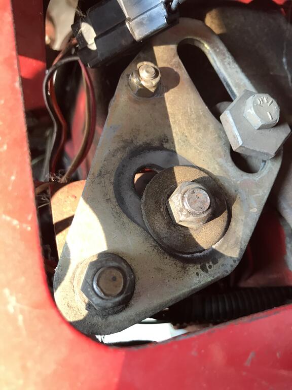

thehorse 221 #12 Posted July 20, 2021 Seems good…no grooves or visible wear….. Share this post Link to post Share on other sites

Handy Don 17,062 #15 Posted July 21, 2021 (edited) 22 hours ago, thehorse said: Seems good…no grooves or visible wear….. Groove seems ok (but the picture doesn't show the tricky spot around neutral--it is under the cam nut). Also, the picture doesn't show the sides of the cam nut shaft to check for wear. Do you have the manual? Have you followed the motion adjustment sequence fully and carefully? Have you inspected the rest of the linkage for wear, maladjustment, damage, or lubrication? What level of mechanical and diagnostic ability do you have? This is the Eaton 1100 manual with the detailed diagnostic and adjustment descriptions. Edited July 21, 2021 by Handy Don Share this post Link to post Share on other sites

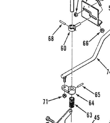

lynnmor 8,939 #21 Posted July 29, 2021 I just lost forward and reverse control on a 520H, the pin in the motion control rod backed out. Detail 65 is the one. Share this post Link to post Share on other sites
Handy Don 17,062 #22 Posted July 29, 2021 3 hours ago, lynnmor said: I just lost forward and reverse control on a 520H, the pin in the motion control rod backed out. Detail 65 is the one. Bummer. That one is not in a very accessible place, either. Share this post Link to post Share on other sites
lynnmor 8,939 #23 Posted July 29, 2021 1 hour ago, Handy Don said: Bummer. That one is not in a very accessible place, either. Yes, it was no fun. I had a stump grinder guy there and was going to use the loader to remove the mulch immediately. I picked up the first scoop and couldn't back up. The motion lever was loose so I removed the console panels and found the problem. Then I started the tractor and drove it back to the barn by operating the linkage in the console. The pin was still sticking out where I didn't see it till I got a mirror and flashlight. After aligning the holes with a nail, Channel Lock pliers was used to push the pin back in. This will not be a permanent fix but it should hold for a short time till I drive a new pin in while forcing the old one out. I might buy a cheap C-clamp and modify it to allow the old pin to go thru the fixed end. Wheelhorse uses a 7/32" X 1" Spirol pin that should last forever, but they wear and chip away over time. Share this post Link to post Share on other sites
Handy Don 17,062 #24 Posted July 29, 2021 3 hours ago, lynnmor said: ...Channel Lock pliers used to push the pin back in. This will not be a permanent fix but it should hold for a short time till I drive a new pin in while forcing the old one out. I might buy a cheap C-clamp and modify it to allow the old pin to go thru the fixed end. Wheelhorse uses a 7/32" X 1" Spirol pin that should last forever, but they wear and chip away over time. What, is this something you can't fix with duct tape? Or you could just leave the C-clamp on there, right? Great that you didn't actually lose the pin so you can operate pending the good fix. Share this post Link to post Share on other sites
