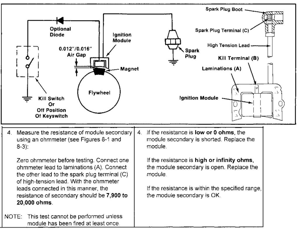

oldlineman 1,551 #10 Posted July 19, 2021 Yes I believe the coil is bad I removed the grounding (kill) wire from the coil and had very little spark. Does anyone know the ohm values for this horse M12S. and test procedure for testing. Coil # is 4758403s. Thanks again Bob Share this post Link to post Share on other sites
gwest_ca-(File Mod) 11,560 #11 Posted July 19, 2021 Looks like this test can be done without taking anything apart. The laminations (A) are bolted to the engine block so any good clean ground would make a test connection. Only thing not verified is the ignition wire insulation that can not be seen behind the tinwork. Taken from Service manual page 8-3 Share this post Link to post Share on other sites
