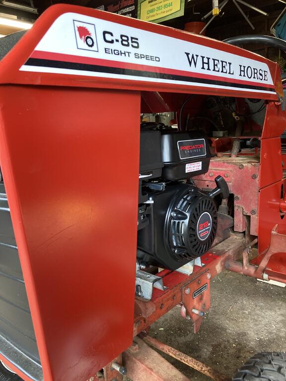

Achto 30,205 #3 Posted July 17, 2021 I put a 6.5hp Predator engine in to replace a 4hp Kohler & never drilled a hole. 1 Share this post Link to post Share on other sites
Preston88 10 #4 Posted July 17, 2021 1 hour ago, Achto said: I put a 6.5hp Predator engine in to replace a 4hp Kohler & never drilled a hole. 1 hour ago, oldlineman said: I'm not sure but shouldn't be too hard to fab something up. Bob I was thinking 1 inch square tubing 2 layers as a riser. It was a old kohler cast iron 7-11 hp mounting holes are like 2 in wider and longer then a standard predator 212. 1 Share this post Link to post Share on other sites
Preston88 10 #5 Posted July 17, 2021 Note vanguard and predator 212 are same bolt pattern. 1 Share this post Link to post Share on other sites
