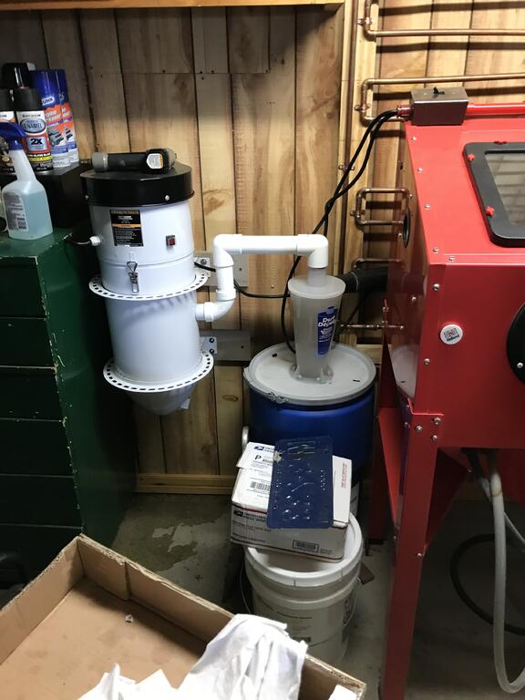

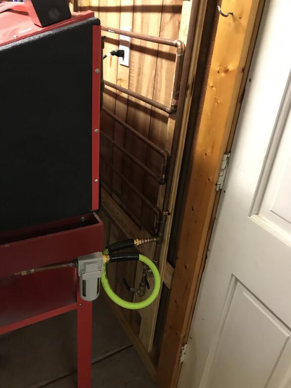

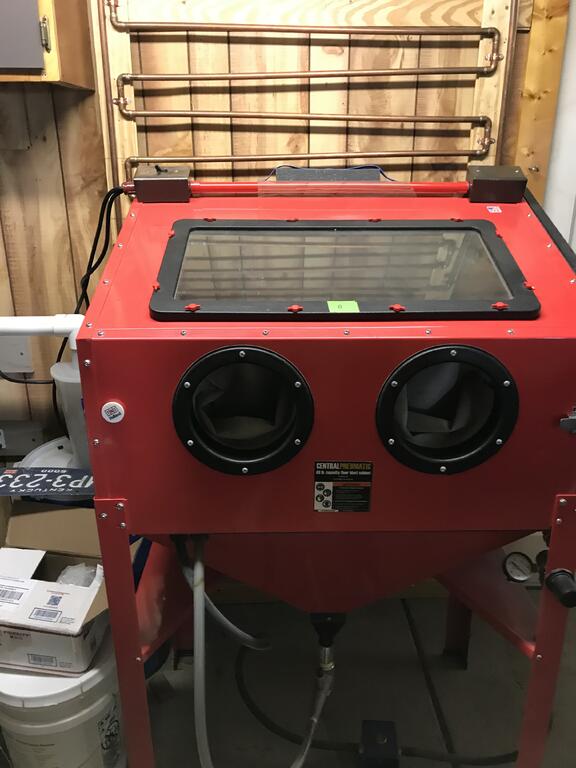

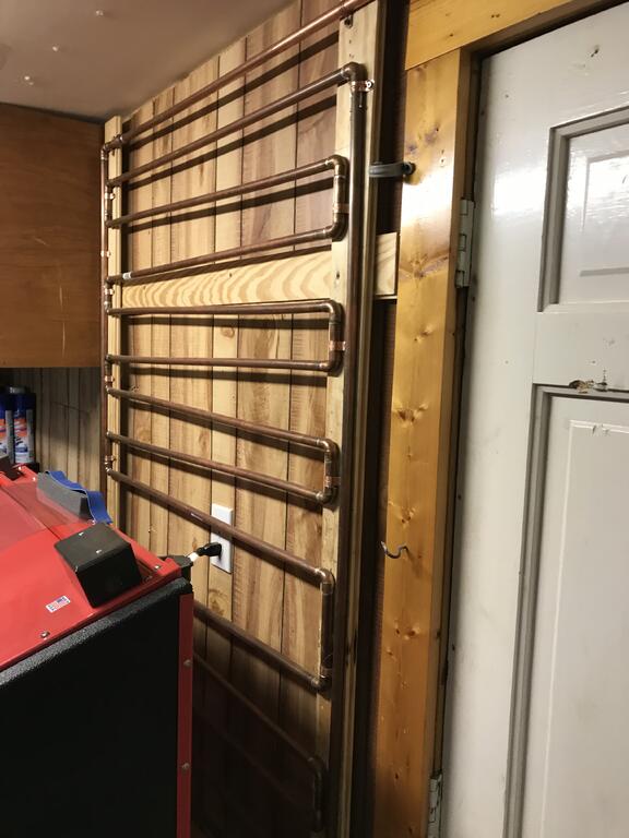

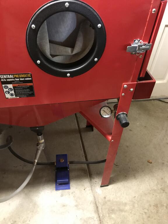

Pops 18 #37 Posted July 30, 2021 (edited) My setup a cheap harbor freight cabinet (the actual part that I used). Changed to high volume low pressure, I set mine at 45, and use a high grade media. I changed the setup from siphon to pressure with foot peddle, and higher grade nozzle. I changed the viewing window used the double strength glass that comes with cabinet got rid of plastic sheets and use glass from Lowes $4.00 as the sacrificial glass. Changed the window so it can be change from the outside. Sealed each piece of the sheet medal as it went together and used appropriate screws and bolts that actually fit. Changed the air and vacuum ports (swapped positions). Their setup pulls media out to a greater extent, tried shops vacs did not do a good job. I took a chance on the dust and media collector from Harbor freight with a cyclone, works great no dust escape. Before I made the air after cooler the system would get stopped up with wet media after about 5 minutes. After researching several ways I went with simplest, had a lot of the material (Copper pipe) on hand. Changed the lights,these were the majors changes. The changes were not cheap, but it is now a pleasure to use, Only if it was bigger. Edited July 30, 2021 by Pops I realize now that I put this in the wrong area, sorry guys 4 1 Share this post Link to post Share on other sites

Jeff-C175 7,211 #39 Posted July 30, 2021 53 minutes ago, Pops said: Sorry guys I now realize that I put this in the wrong area I don't think you did? That's what we're talking about, the 'after cooler', isn't it? I'm looking at all the designs that I can find. Many employ VERTICAL piping with a drip loop at the bottom of each one and I'm not sure why they would be vertical. I like Pops' design with the horizontal, and a slight pitch to each pipe so the water flows down hill to a single collection point. 1 Share this post Link to post Share on other sites

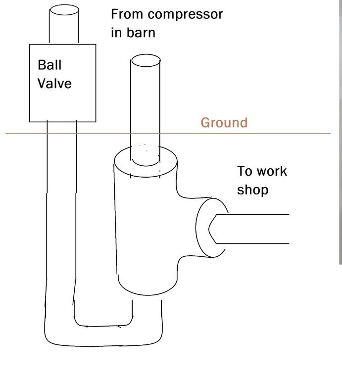

953 nut 69,555 #41 Posted August 1, 2021 The line from my compressor has a low-point drain outside the barn. Moisture in the hot air from the compressor will condense out in the underground line and work its way back to the trap where it can be blown out by the air pressure. All it takes is a "T", two 90s and a ball valve. 4 Share this post Link to post Share on other sites

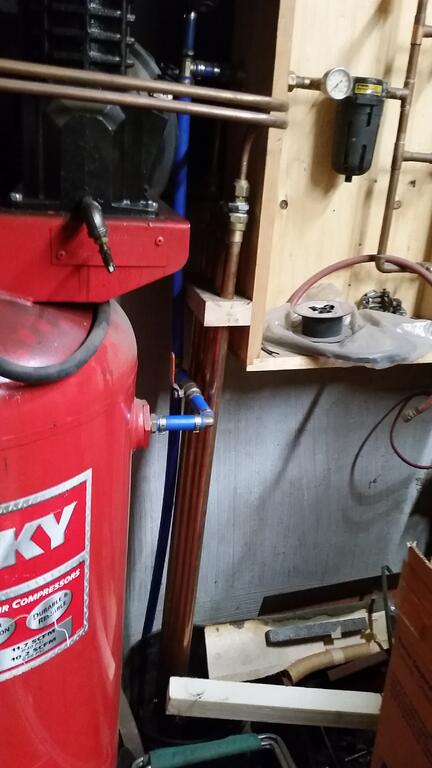

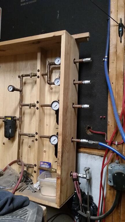

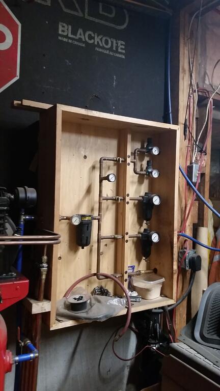

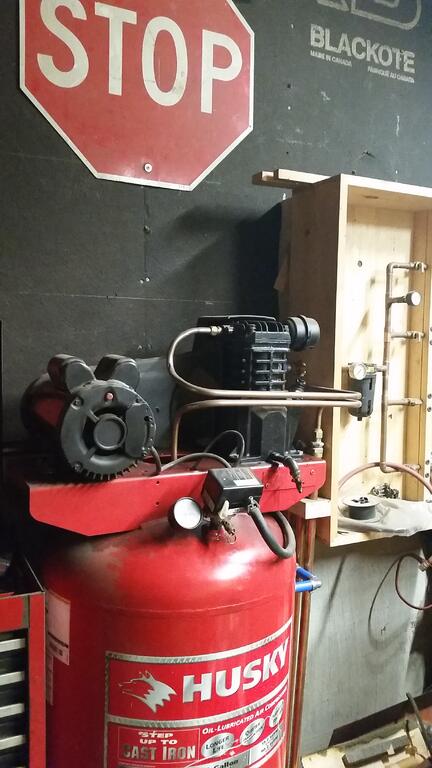

MikMacMike 494 #42 Posted September 5, 2021 I still plan to add another bottle dryer ahead of the dryer yu see there. I used and bent soft copper over to the 4- 3/4" hard copper tubes mounted vertically on side of regulator cabinet. At the bottom of the 4 hard copper tubes is a bucket filled with water. After the 4 copper tubes i went back in to the air tank again with soft copper. From the tank i used blue plastic to the regulator cabinet. 1st entering the bottle dryer them soldered a 1 into 4 header which has a pressure guage indicating header pressure. Starting at the top of cabinet i split the line to 2 small regulators for air brushing. Below that 1 line goes to 2 more larger regulators. The bottom regulator i plan to add an automatic oiler for power tools. The upper large reg will be used for painting...no oil. At the very bottom is just a straight through line using full pressure straight from tank for blowing full pressure. In the last pic it showes all 5 lines with quick connects that run to my variouse flexable hoses. Oh there is also a guage i fogot to mention ahead of the bottle moisture separator....this way i can see by using the 2 guages when my separator has to be cleaned by seeing the difference in the 2 guages pressures. So far after 20 years all is still working perfect. 1 Share this post Link to post Share on other sites
