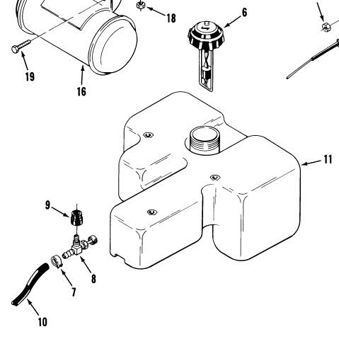

Chris Craig 0 #1 Posted July 15, 2021 I'm trying to remove the fuel tank on my 252-H . I have everything loose but two bolts . They look like they go into tank but I can't see to get anything on it to get it out . I tried to loosen and they just keep spinning Share this post Link to post Share on other sites
Crazyredhorse 296 #2 Posted July 15, 2021 They have nuts in the plastic of the tank I think there were 3.might have to cut the bolts off to get it off dont know how you would mount it again though. but sounds like there spinning in the plastic. Share this post Link to post Share on other sites
