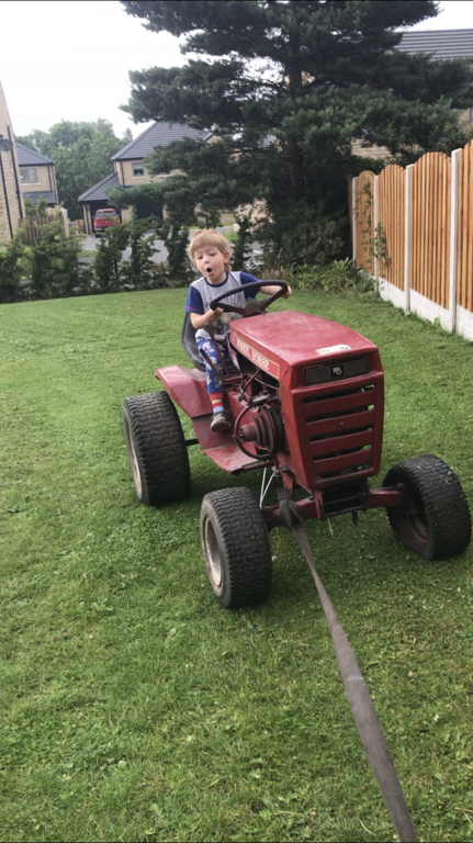

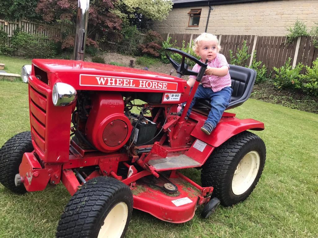

Felix 145 #1 Posted July 14, 2021 Hi guys. I’ve acquired a c120 auto that needs a fair amount of work. Engine not running but looks in good order. the half shaft also keeps popping out of the left hand side. I’m wondering if the 12hp Kohler engine will fit straight in my B80 4 speed with out any mods. I’m thinking I could make one nice tractor out of the pair I have. Here’s a picture of them both. 4 1 2 Share this post Link to post Share on other sites

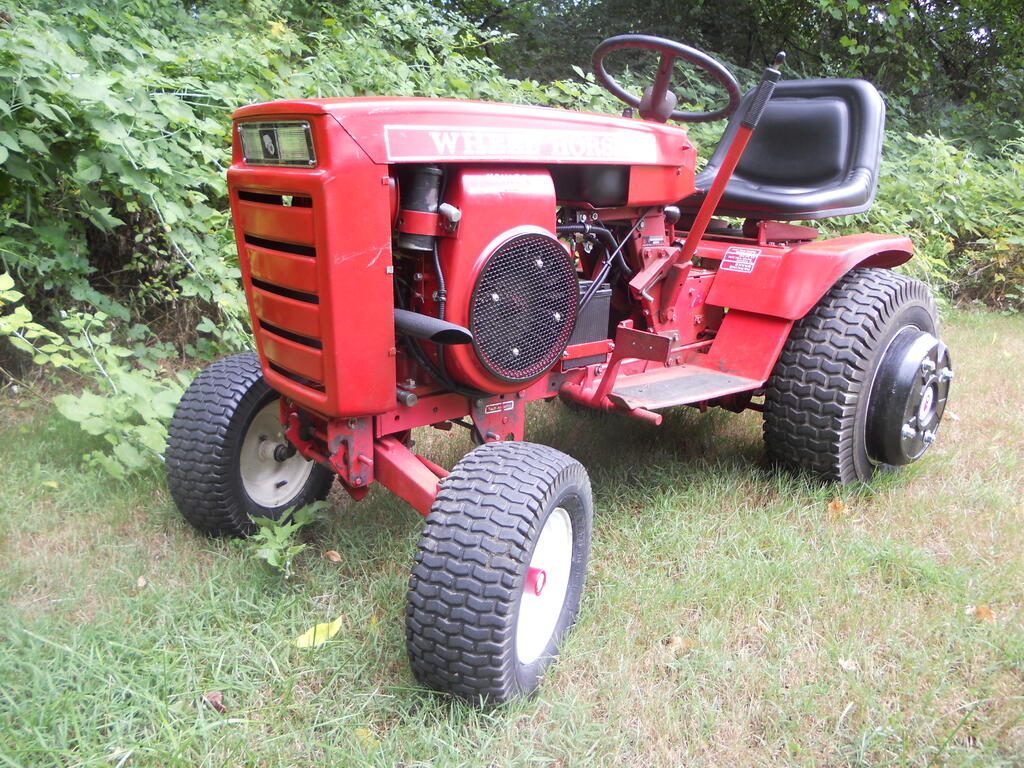

Racinbob 13,135 #15 Posted July 14, 2021 I'm in total agreement with the others. The axle is a simple fix. If you still want to do the swap it's quite easy. Do not use the riser plate that the K-181 sits on. Use the PTO from the K-341.There's a bearing race inside for the larger shaft. A little bit of tinkering with the control cables and you're off and running. Here's my "B-160". I bought it new as a B-80 and swapped in a K-341. 3 3 Share this post Link to post Share on other sites
