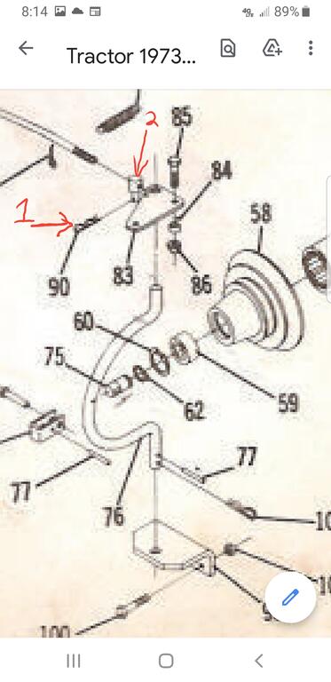

Jeff-C175 7,207 #7 Posted July 14, 2021 5 minutes ago, heysavoy said: OK There's a triangular plate at the top of the PTO hoop. That hunk of metal on the threaded rod that goes into the dash is the trunion. Remove the pin and lift tne trunion out of the plate and screw onto the rod one turn at a time and try again. Only tighten just enough to eliminate the slippage. Share this post Link to post Share on other sites

gt14rider 1,055 #11 Posted July 14, 2021 #1. Remove pin #2. Turn trunnion 1 or 2 turns,clockwise. #3. Replace trunnion, insert pin,check clutch, adj as necessary. 1 1 Share this post Link to post Share on other sites
