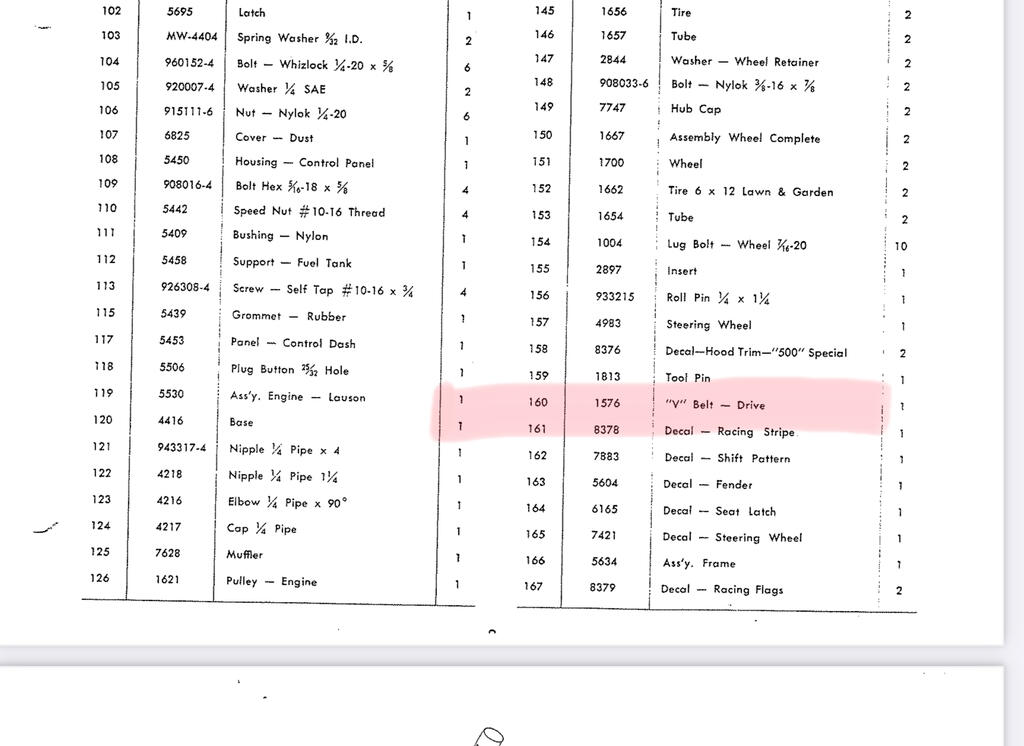

D_Mac 9,333 #1 Posted July 13, 2021 Can anyone help me with getting the correct drive belt size for the 500 Special ? Share this post Link to post Share on other sites
Pullstart 68,682 #2 Posted July 13, 2021 https://www.wheelhorseforum.com/search/?q=500 special&quick=1&type=downloads_file&search_and_or=and The IPL says this... drive belt 1576 a search on 1576 says this... #1576 replaced by 9691 - 1/2" x 70" 1 1 Share this post Link to post Share on other sites
