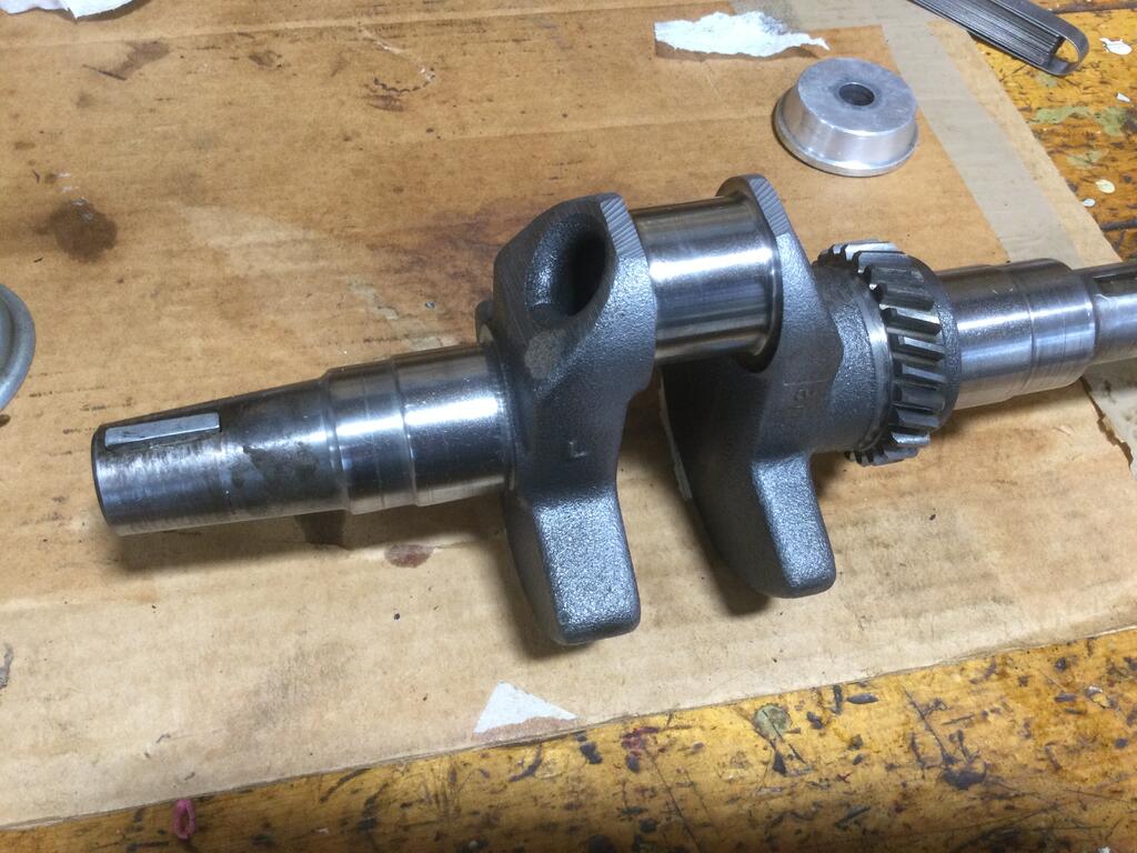

squonk 48,322 #32 Posted July 18, 2021 2 hours ago, 68 raider 12 said: I had an old timer in my town dissect the engine and it's confirmed the connecting rod snapped and the crank is a little busted up, the cylinder walk is surprisingly still in good condition no crack, scratch, or chips. Only problem is I'm having a hard time finding a replacement crankshaft for the Kohler k301s engine model. Anyone have one or know where to find one? I think I may have a 301 crank here.It will probably need turning Share this post Link to post Share on other sites
68 raider 12 3 #33 Posted July 18, 2021 4 hours ago, squonk said: I think I may have a 301 crank here.It will probably need turning What do you mean by turning?? Share this post Link to post Share on other sites
squonk 48,322 #34 Posted July 18, 2021 48 minutes ago, 68 raider 12 said: What do you mean by turning?? The crank came out of an engine with a broken rod. It had some aluminum melted on to the journal. I polished it but it may be out of round and need to be turned .010" undersize by a machine shop. Share this post Link to post Share on other sites
68 raider 12 3 #35 Posted July 23, 2021 On 7/18/2021 at 1:45 PM, squonk said: I think I may have a 301 crank here.It will probably need turning Do you have a picture of it?? Share this post Link to post Share on other sites
squonk 48,322 #36 Posted July 23, 2021 (edited) 5 hours ago, 68 raider 12 said: Do you have a picture of it?? Actually it belongs to a friend of mine who had the blown engine. i thought I had it here but he must have it. I'll get it tomorrow. Edited July 23, 2021 by squonk Share this post Link to post Share on other sites

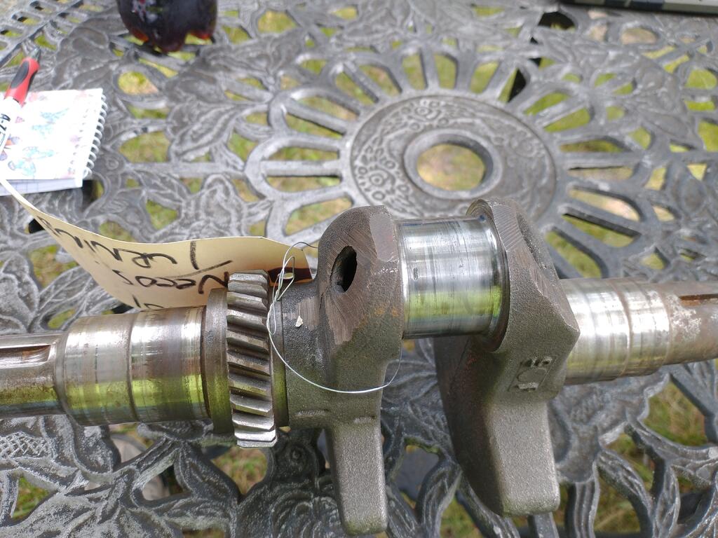

squonk 48,322 #37 Posted July 24, 2021 (edited) Crankpin is out of round and depending on the accuracy of my old micrometer the crank cannot be turned down any more to use with an undersized rod. It would have to be built back up and re-machined or a rod machined for bearing inserts. You can read about this here:http://gardentractorpullingtips.com/engine.htm Edited July 24, 2021 by squonk 1 Share this post Link to post Share on other sites

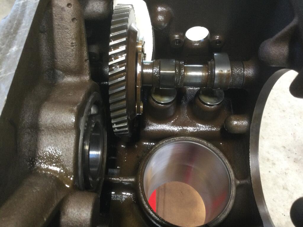

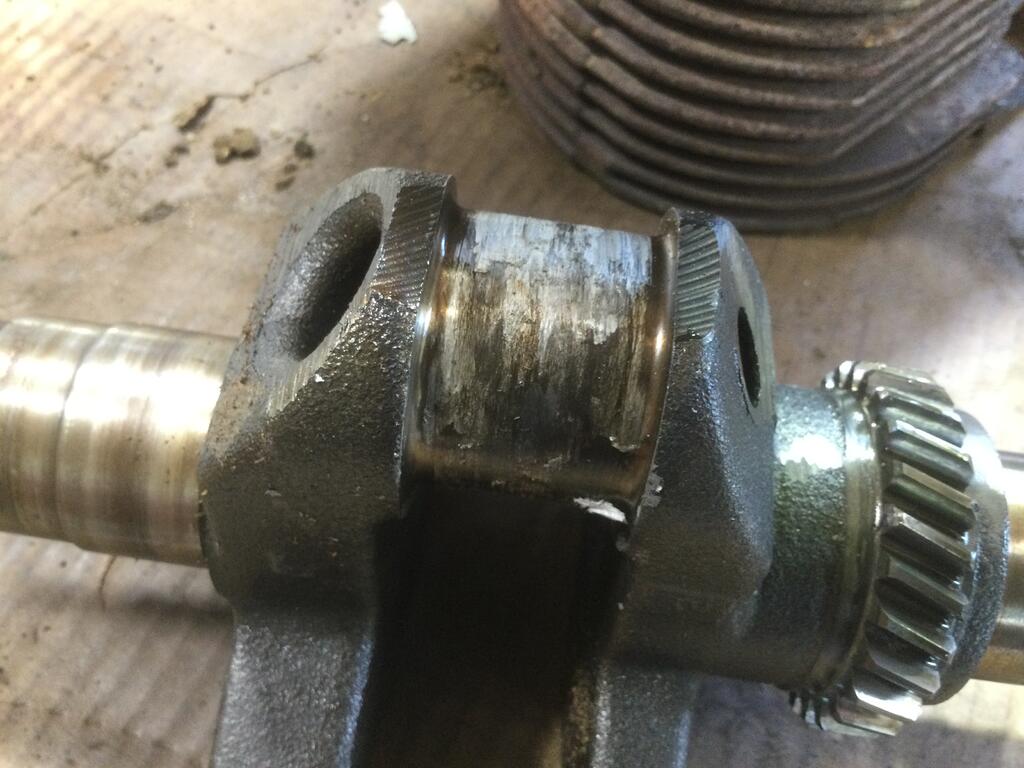

Gregor 4,848 #42 Posted August 1, 2021 On 7/13/2021 at 7:58 AM, squonk said: The crank will most likely be torn up where the rod used to be connected to it. That looks an awful lot like my MV-16. Share this post Link to post Share on other sites
richmondred01 2,393 #43 Posted August 1, 2021 95% of the engines I get with broken rods the crank looks like that. They generally clean up fine at .010 or .020. 40% of the engines I get that rods have broken have the chipped apron skirt. I’ve got several core blocks so I use them or put a sleeve in. 1 Share this post Link to post Share on other sites
squonk 48,322 #44 Posted August 1, 2021 5 hours ago, richmondred01 said: 95% of the engines I get with broken rods the crank looks like that. They generally clean up fine at .010 or .020. 40% of the engines I get that rods have broken have the chipped apron skirt. I’ve got several core blocks so I use them or put a sleeve in. Can you get .020" rods Mark? Share this post Link to post Share on other sites
richmondred01 2,393 #45 Posted August 1, 2021 I have .020 rods for 10hp through 16hp. I can’t get them any more for 8hp down. 1 Share this post Link to post Share on other sites

Gregor 4,848 #47 Posted August 1, 2021 12 minutes ago, richmondred01 said: I have .020 rods for 10hp through 16hp. I can’t get them any more for 8hp down. Do you have anything at all for an MV-16S, spec # 56506 Share this post Link to post Share on other sites
richmondred01 2,393 #48 Posted August 1, 2021 6 minutes ago, Gregor said: Do you have anything at all for an MV-16S, spec # 56506 I don’t but I will PM you where you can get them. 1 Share this post Link to post Share on other sites
richmondred01 2,393 #49 Posted August 1, 2021 Before and after. I’m able the get most of them cleaned up. Share this post Link to post Share on other sites
Gregor 4,848 #50 Posted August 1, 2021 OK Mines not THAT bad. Share this post Link to post Share on other sites
