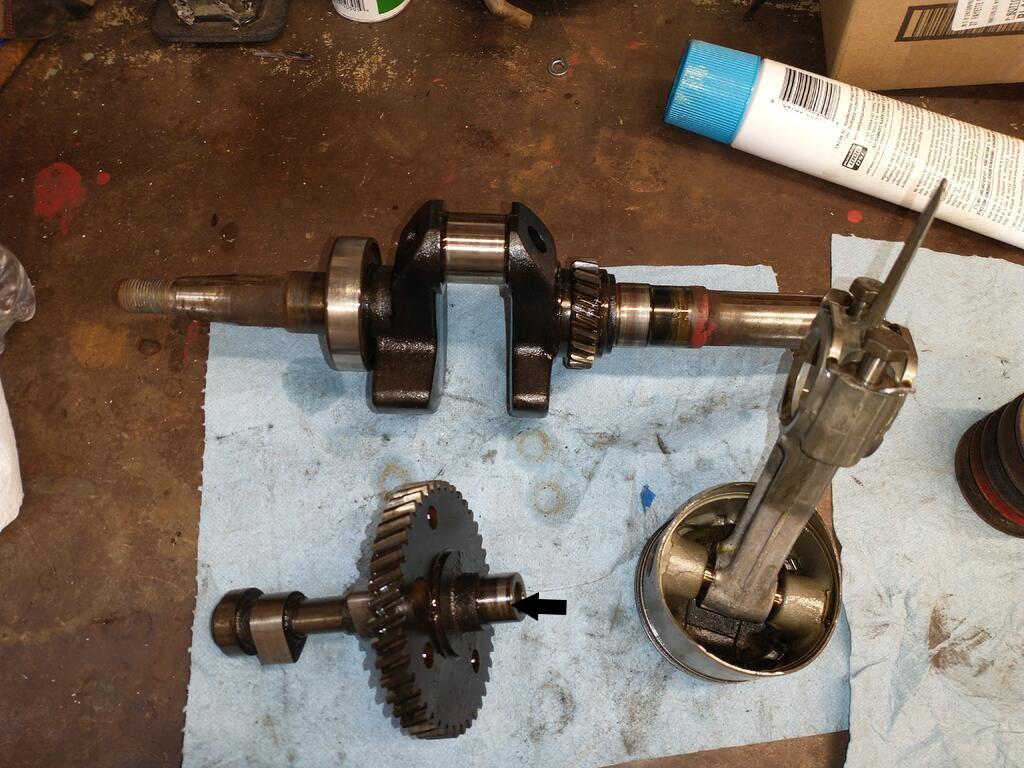

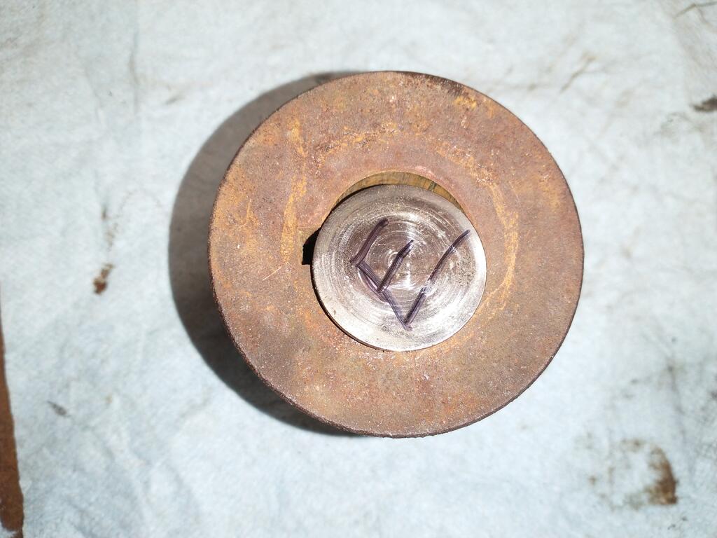

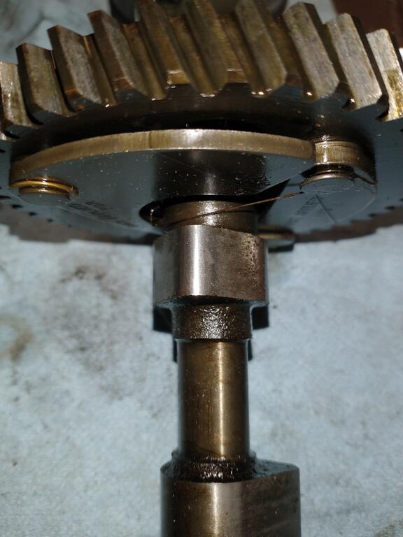

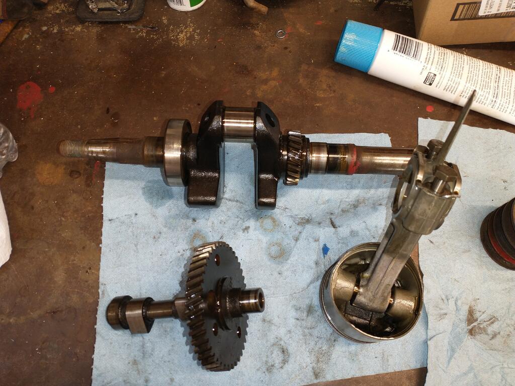

squonk 48,322 #128 Posted August 7, 2021 Tore down the"parts" engine. Looks pretty good except the oil was last changed when Lucy was a twinkle in Desi's eye. I have started to clean the inside of the block to apply the handyman's secret crack detector, carb cleaner. Crank looks good. The camshaft came right out. No sign of the shim! I am not sure if I'm going to use this cam. There is an imprint of the exhaust lobe on the tappet that you can feel with your fingernail. I was always taught not to use a tappet or lifter from one cam to another. You can just make out the impression from the middle of the "E" to the middle of the bottom line of the "E" Share this post Link to post Share on other sites
ebinmaine 81,139 #129 Posted August 7, 2021 I'd agree with not using the cam having been taught the same. That cam might be saved and even enhanced a little by grinding. Someone like @Greentored could comment there. AS a side note you have (2) 8 HP Kohler engines with broken governors. I found today that the one that is original to The Military Tribute Tractor has a broken governor and the exhaust valve sticks. I won't be able to get into that engine for quite a while. I'll be looking forward to seeing your outcome on this project. Share this post Link to post Share on other sites

Greentored 3,221 #133 Posted August 9, 2021 (edited) On 8/7/2021 at 2:54 PM, ebinmaine said: I'd agree with not using the cam having been taught the same. That cam might be saved and even enhanced a little by grinding. Someone like @Greentored could comment there. Keeping the lifters and corresponding cam lobes 'matched' is absolutely correct, especially in the automotive world. Same for rockers, pushrods, etc... New lifters on old cam= ok. New cam and old lifters= no no. I'll be honest with you guys- I have never done it on a small engine, and never matched pushrods and rockers in an automotive application either and never had any issues. BUT, keeping them in order IS the recommended way to do it. In this case, id slap a new set of lifters in it just for peace of mind and send it. If you do want some more oomph, a custom grind on that cam will really wake it up. I tried doing it on my own, the payoff was impressive but the labor was painstaking and not repeatable. Edited August 9, 2021 by Greentored Share this post Link to post Share on other sites

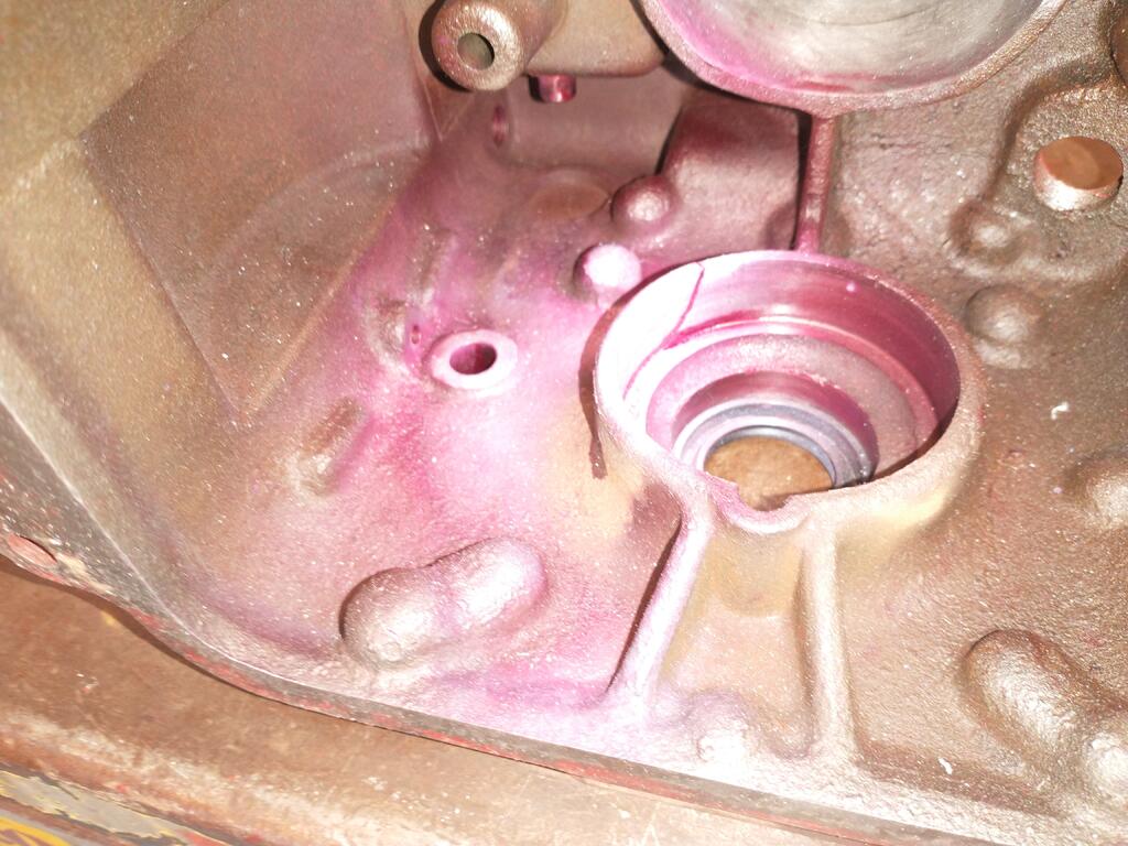

squonk 48,322 #134 Posted August 9, 2021 For the curious, here is the picture of the cracked bearing boss. 2 1 Share this post Link to post Share on other sites
Handy Don 17,670 #135 Posted August 9, 2021 1 hour ago, squonk said: For the curious, here is the picture of the cracked bearing boss. So that took a serious impact to break. Share this post Link to post Share on other sites
ebinmaine 81,139 #136 Posted August 9, 2021 6 minutes ago, Handy Don said: So that took a serious impact to break. Dropped perhaps? Share this post Link to post Share on other sites
squonk 48,322 #137 Posted August 9, 2021 27 minutes ago, ebinmaine said: Dropped perhaps? I'm thinking it happened when the "previous owner installed the bearing. Probably got it wedged and whacked it . 2 1 Share this post Link to post Share on other sites
ebinmaine 81,139 #138 Posted August 9, 2021 1 minute ago, squonk said: . Probably got it wedged and whacked it . Ahhhh yes. Share this post Link to post Share on other sites
pfrederi 21,301 #139 Posted August 9, 2021 Don't need no magna flux to see that... Share this post Link to post Share on other sites
Gregor 4,848 #140 Posted August 9, 2021 What is the red stuff on there to make it show up like that? Share this post Link to post Share on other sites
squonk 48,322 #141 Posted August 9, 2021 (edited) 3 hours ago, Gregor said: What is the red stuff on there to make it show up like that? Dye and developer. We wanted to see if the crack continued around the base of the boss. Edited August 9, 2021 by squonk Share this post Link to post Share on other sites
Gregor 4,848 #142 Posted August 11, 2021 On 8/9/2021 at 5:54 PM, squonk said: Dye and developer. Maybe another stupid question. Are you talking hair dye? 1 Share this post Link to post Share on other sites
richmondred01 2,393 #143 Posted August 11, 2021 I’ve only seen those bosses broken once or twice in 40 years. I agree my guess is someone got heavy handed knocking in the bearing. I always put the bearing in the freezer over night. Same with the guides. learned that from the model A’s and flathead fords. 5 Share this post Link to post Share on other sites
Snoopy11 5,731 #144 Posted August 12, 2021 You know what I see... a little less obvious I know... but Wear on the cam... pointed out in the picture... Perhaps a little bit of oil loss there. What is odd is... my cams don't show wear like that, even with thousands of extra rpms. Perhaps someone used a cheap... and/or crappy oil? Don Share this post Link to post Share on other sites
squonk 48,322 #145 Posted August 13, 2021 9 hours ago, Snoopy11 said: You know what I see... a little less obvious I know... but Wear on the cam... pointed out in the picture... Perhaps a little bit of oil loss there. What is odd is... my cams don't show wear like that, even with thousands of extra rpms. Perhaps someone used a cheap... and/or crappy oil? Don The shim that rides on that end was missing. Share this post Link to post Share on other sites
