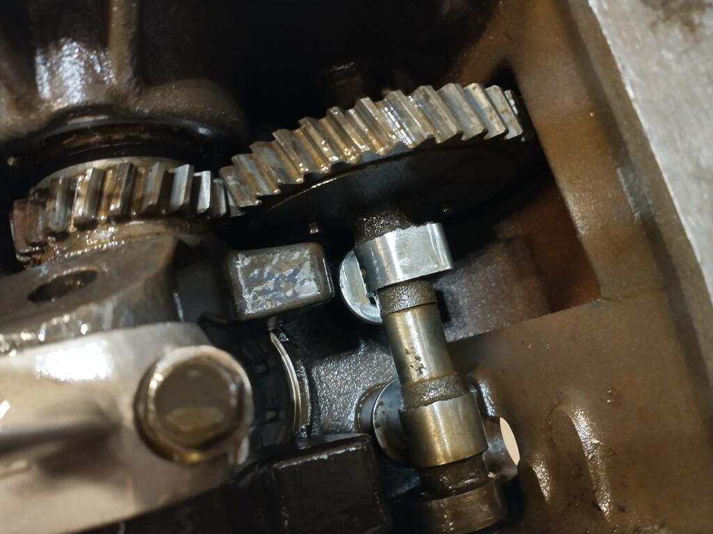

squonk 47,898 #26 Posted July 12, 2021 (edited) 9 minutes ago, oldredrider said: If that engine were mine, I'd take it completely down. Metal in the gears is a bad sign. Actually Paul it isn't metal. I picked some of it out and it's almost like gasket material but gunk non the less. Got to tear it all apart to fix the rod cap. everything's gotta get cleaned. Checked the stroke. 2.75" so it's an 8. That's the only thing this kid was truthful about I'm afraid. Edited July 12, 2021 by squonk 1 1 Share this post Link to post Share on other sites
stevasaurus 23,805 #27 Posted July 12, 2021 It does look like the 2 piece...need to see outer side of the gear. There was something in that thread, I linked to, that mentioned a different length of exhaust tappet for the 2 piece cam shaft without the ACR. Something to check when you open the other engine. Share this post Link to post Share on other sites
squonk 47,898 #28 Posted July 12, 2021 (edited) My cam looks like the one pictured in the thread as the 2 piece. I wonder if the advance is stuck? Gotta tear the whole ball of wax apart any way. Picture from the thread 2 piece cam: Now the cam I have: Edited July 12, 2021 by squonk 1 Share this post Link to post Share on other sites
stevasaurus 23,805 #29 Posted July 12, 2021 Does it look like someone has been in there Mike?? You might need to take the other one apart to compare if you have the one piece in that one. Wish I was there playing bar-tender while sitting on the tail-gate. I can do that from Illinois, but it is not the same. 1 Share this post Link to post Share on other sites

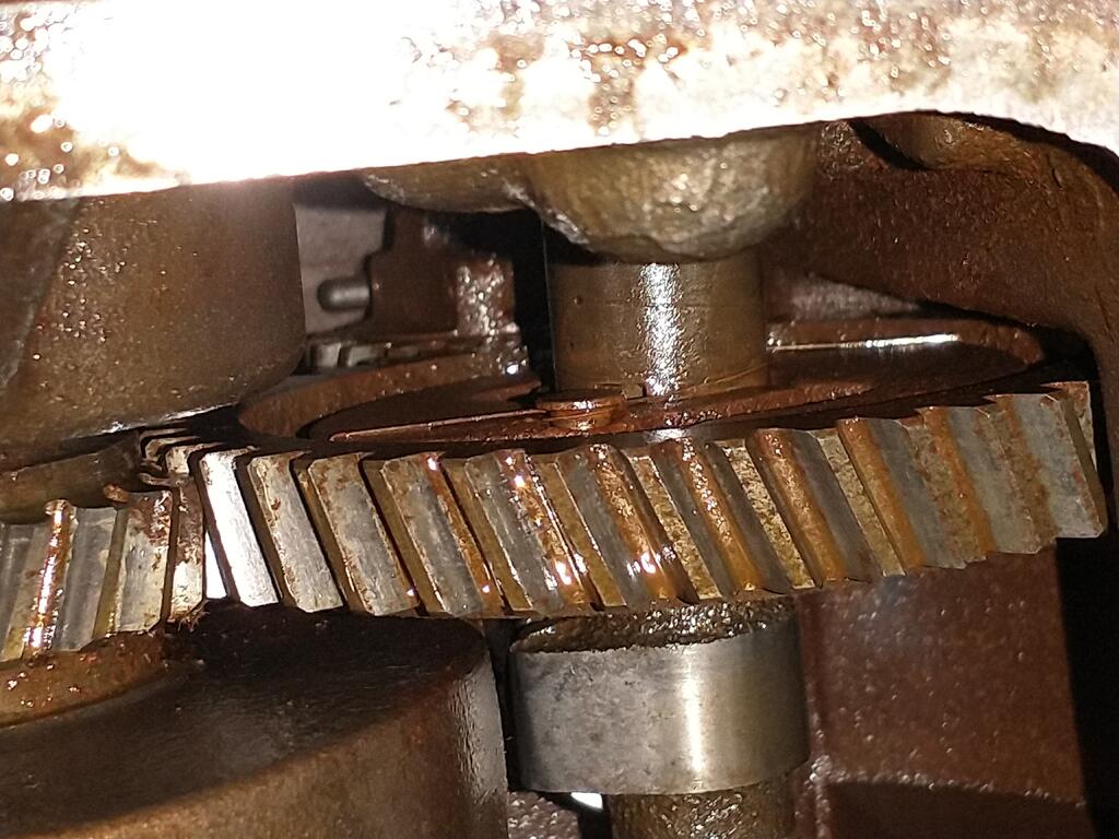

squonk 47,898 #33 Posted July 12, 2021 (edited) Found this from Brian miller's site About the 2 piece cam: If you choose to reuse this camshaft to keep the engine "all original," when reinstalling the cam in the engine block, make sure the timing marks on both the cam gear and ignition cam (points lobe) are aligned, or the ignition timing will be 180º off and the engine will not start! Sound exactly what I have!!!! Edited July 12, 2021 by squonk 5 Share this post Link to post Share on other sites
Gregor 4,848 #34 Posted July 12, 2021 (edited) In the above pics, it doesn't look to me like the cam lobes are lining up with the center of the valve stems. Seems to me they should. Or maybe it;s an optical "contusion" ! Edited July 12, 2021 by Gregor 1 Share this post Link to post Share on other sites
Jeff-C175 7,211 #35 Posted July 12, 2021 12 minutes ago, Gregor said: doesn't look to me like the cam lobes are lining up with the center of the valve stems I think it's so that the tappets will rotate around. Might be as it should be? Share this post Link to post Share on other sites
Jeff-C175 7,211 #36 Posted July 12, 2021 (edited) 1 hour ago, stevasaurus said: the gear and lobes are one piece. If that is so, how would the advance mech work? Doesn't the gear stay with the short piece and ride on a 'drum' of sorts which is part of the long piece? The gear would have to be able to move with respect to the cam lobes, yes? OR, does the VALVE timing remain constant WRT the crank and it's only the SPARK timing that varies? So those weights are similar to the advance weights in an auto distributor (remember those anyone?) NVM, I think I answered it on my own self... So only the SPARK timing is changed then. The lobe on the right in the pic is the mechanical fuel pump lobe? Edited July 12, 2021 by Jeff-C175 1 Share this post Link to post Share on other sites
buckrancher 2,697 #37 Posted July 12, 2021 points lobe is 180 out of time you have to take the cam out and rotate the point lobe 180 on the front of the cam 3 1 Share this post Link to post Share on other sites
squonk 47,898 #38 Posted July 12, 2021 1 minute ago, buckrancher said: points lobe is 180 out of time you have to take the cam out and rotate the point lobe 180 on the front of the cam Yup pretty much what I concluded. Points lobe 180 off and connecting rod 180 off. Freakin Kids! 2 1 Share this post Link to post Share on other sites

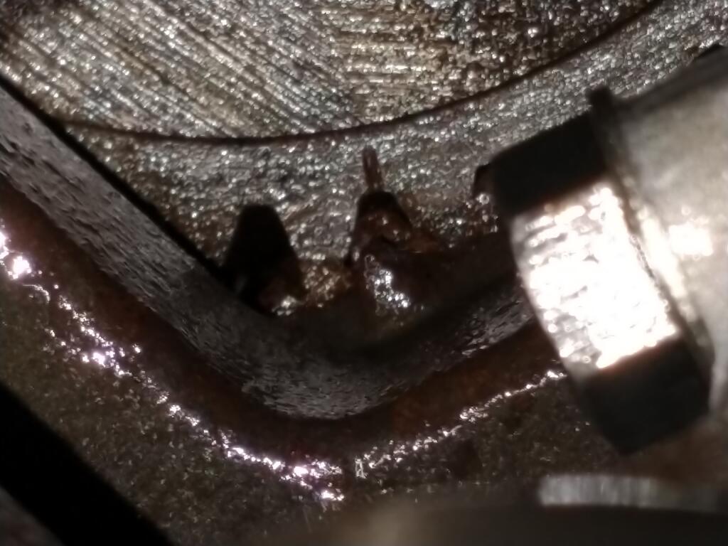

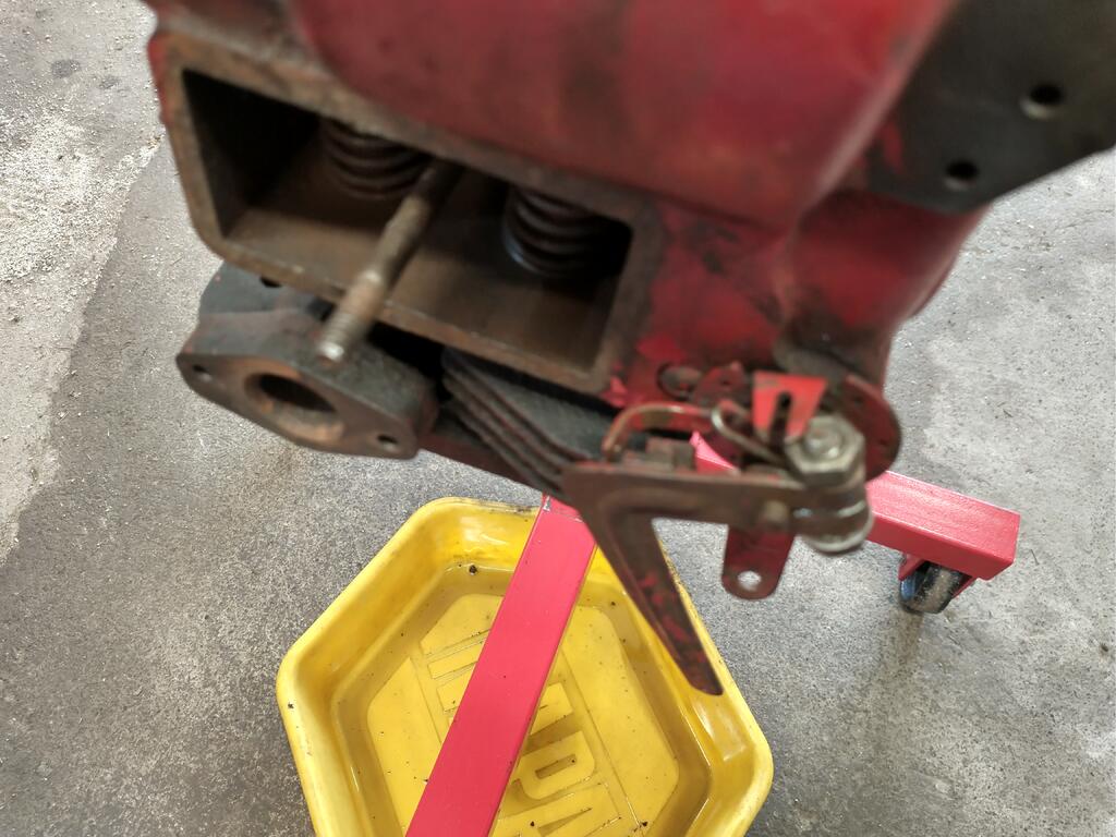

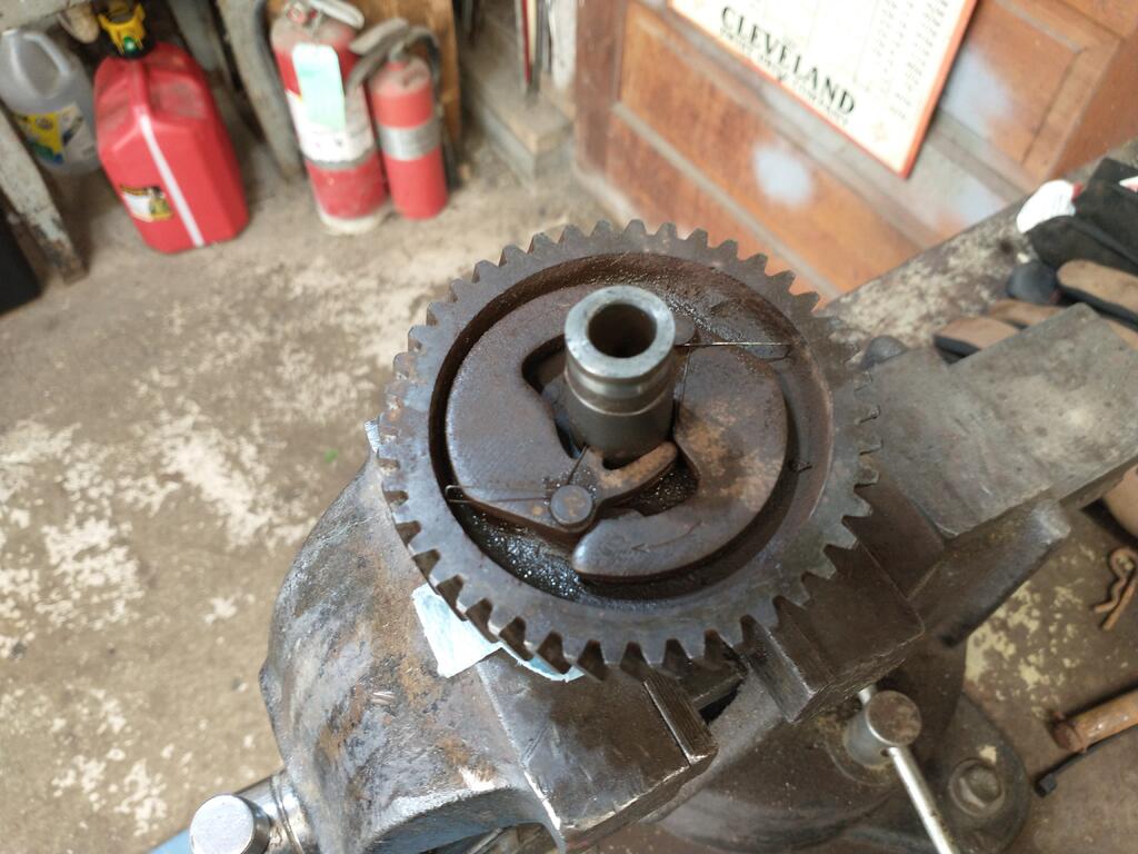

squonk 47,898 #50 Posted July 13, 2021 Well folks all I can say is WOW FREAKIN WOW!!!! I REALLY AM GLAD this thing didn't start. I'm beginning to think I should just cut bait on this thing and just peddle the good parts that are there. Started to tear into it. Opened the bearing plate without incident. Cam was aligned with the crank so they did at least one thing right. By the way for reference when the marks are together the engine is at TDC beginning the intake stroke. Got the cam out. Yes the cam shim WAS MISSING!!! And unfortunately the points lobe fell off so I have no idea if it was on wrong or not but pretty sure it was. I noticed one of the governor gears was seized open. Went to take it out. 1st the spring on the linkage wasn't connected to the arm. Pulled out the rod AND THE FINGER THAT OPERATES THE GOVORNER IS GONE! You can see the little arm/tab in this pic from prondzy's thread I couldn't even get the gear out. The welch plug in the block is so far in there isn't enough room to get the gear off the shaft. I did manage to get the weight free. So to recap this "REBUILT ENGINE": The points lobe on wrong Cam washer missing Broken governor arm and it's gone Stuck governor weight Governor linkage spring unhooked Valves leaked by ( they did a quickie lap job and that was it) Rod on backwards so the oil hole was on the wrong side 3 Share this post Link to post Share on other sites
