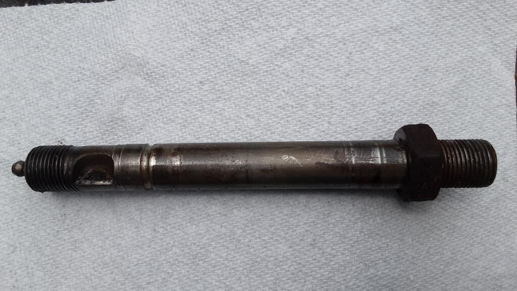

Jon925mn 39 #1 Posted July 10, 2021 Replacing bearings on 05-42MR02 deck spindle assembly and found this shaft with broken key slot. Anyone have a spare or know where to get one? Part # is 108849. 7" x 3/4. Share this post Link to post Share on other sites

Jeff-C175 7,209 #3 Posted July 11, 2021 (edited) 5 hours ago, MNDIESEL said: Anyone have a spare I have one with the large nut on the bottom. Message me if you're interested. How's the pulley? Edited July 11, 2021 by Jeff-C175 Share this post Link to post Share on other sites
Goldnboy 1,117 #4 Posted July 11, 2021 Actually you do not have to use a woodruff key. You can remove the key place a lock washer on top of pulley and fasten down There is a service bulletin that explains this in more detail. Share this post Link to post Share on other sites
Jon925mn 39 #5 Posted July 11, 2021 Thank you Goldnboy for possible future information. I actually have a replacement being sent thanks to Jeff-C175. The shaft in picture is worn now and no longer serviceable. Share this post Link to post Share on other sites
Jeff-C175 7,209 #6 Posted July 11, 2021 51 minutes ago, MNDIESEL said: shaft in picture is worn now Which is why I'm sending the pulley also. I know you said the pulley is ok but wear like that makes me doubt that the pulley bore is not worn. But I just thought of something... I think this pulley is from a 48" deck and the 42" deck might use a different one. I know the shaft will work though. Share this post Link to post Share on other sites
Jon925mn 39 #7 Posted July 11, 2021 Yep. Checked and shaft is loose. Looks like 85mm on that pulley. Share this post Link to post Share on other sites
Jeff-C175 7,209 #8 Posted July 11, 2021 5 minutes ago, MNDIESEL said: Yep. Checked and shaft is loose. Looks like 85mm on that pulley. I hope the 42 uses the same pulley then! Share this post Link to post Share on other sites
Jon925mn 39 #9 Posted July 11, 2021 Diagrams list same for both decks. Thanks Jeff. 1 Share this post Link to post Share on other sites
