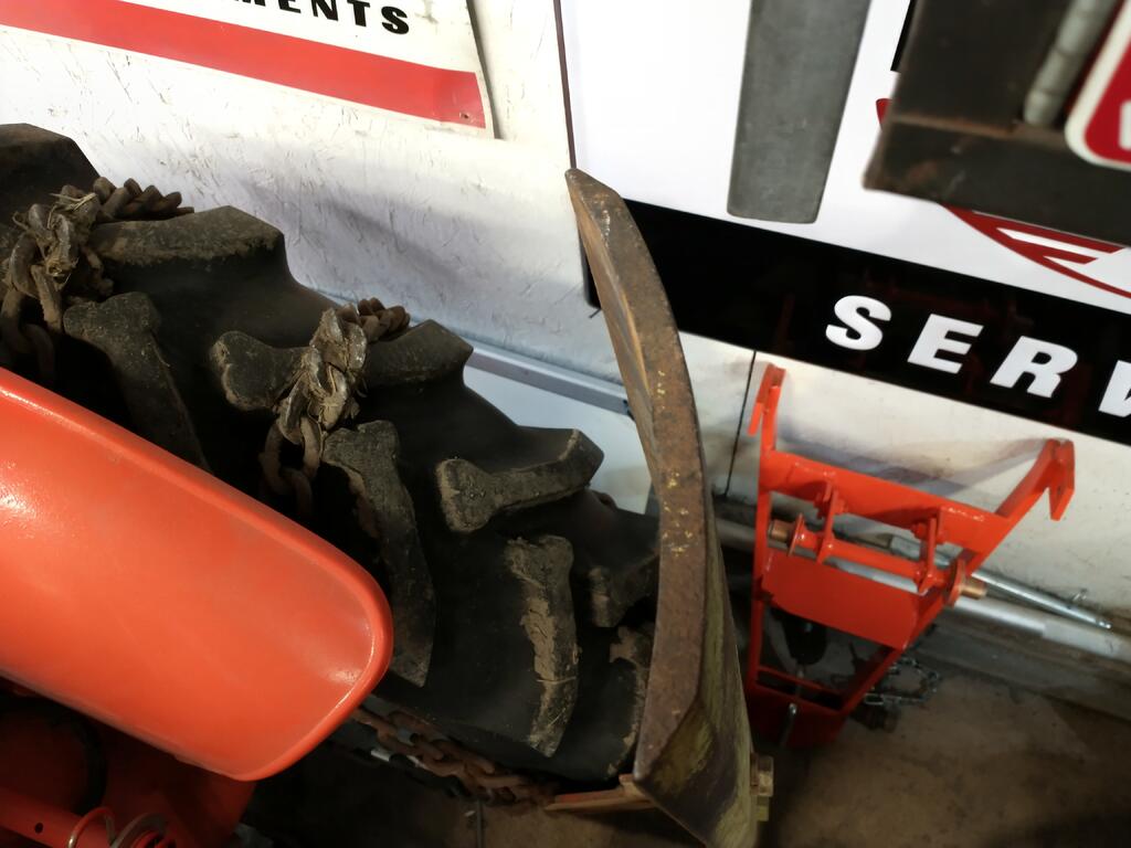

squonk 47,887 #26 Posted July 7, 2021 Actually this blade is closer to 1/2" 1 Share this post Link to post Share on other sites

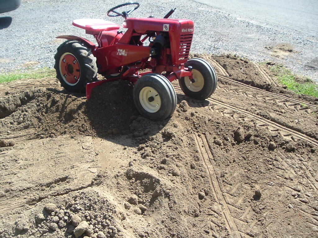

clueless 3,436 #27 Posted July 7, 2021 1 hour ago, squonk said: The problem with the grader is it's way too light for what we want to do with it. Years ago I got my hands on an Allis-Chalmers mid mount blade and modified it to use on a WH. The blade part alone is close to 60 lbs. 3/8" solid iron. I foolishly got rid of it when I found a WH grader. Well I got another Allis blade last month and sold the WH one. This is a pic of the 704 I had with the first Allis blade. Mike, I tried to get the blade back with the 704 a couple of times but Bruce wouldn't let it go . Maybe some day . 2 Share this post Link to post Share on other sites
