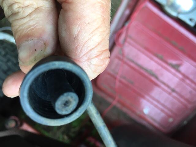

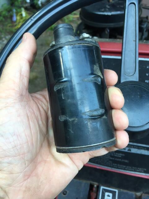

Bill Winn 157 #1 Posted July 4, 2021 Saturday my c175 quit on me. It gets fuel and air and the little bit of spark it was getting was so weak it was orange not blue. I measured the voltage from the closed ignition circuit to the coil and it was about 12.4vdc. I checked the coil and it measure from pole to pole 4.7ohms. However from the + side of the coil to the plug wire sockets there was nothing. I tried the 2000, 20k, and the 200k setting. I also cleaned and gapped the points at .020 and the plugs at .025. The points are quite worn by the way. One thing I noticed was what appeared to be heat/ pressure deformation on the coil housing where the engine's mounting surface had imprinted. And check out the final picture. I have never seen plug wires without metal clips on the ends. I did not find them inside the coil like I expected either. Weird. I plan to replace it all... coil, condenser, plugs, wires, and points. I promise to update. Opinions, advise, well-wishes, and cautionary tales welcomed! Bill Share this post Link to post Share on other sites
squonk 45,811 #2 Posted July 4, 2021 Coil got hot. It's possible that wire was still able to fire but it would have increased secondary resistance considerably. Damaging the coil. 4 Share this post Link to post Share on other sites
ebinmaine 77,824 #3 Posted July 4, 2021 38 minutes ago, squonk said: Coil got hot. It's possible that wire was still able to fire but it would have increased secondary resistance considerably. Damaging the coil. I could see that. The plug wire may have been sending an arc to the plug to fire it. 1 Share this post Link to post Share on other sites
