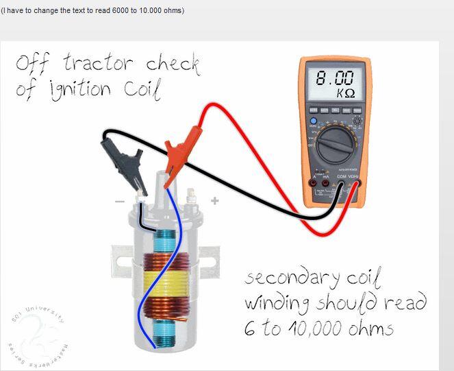

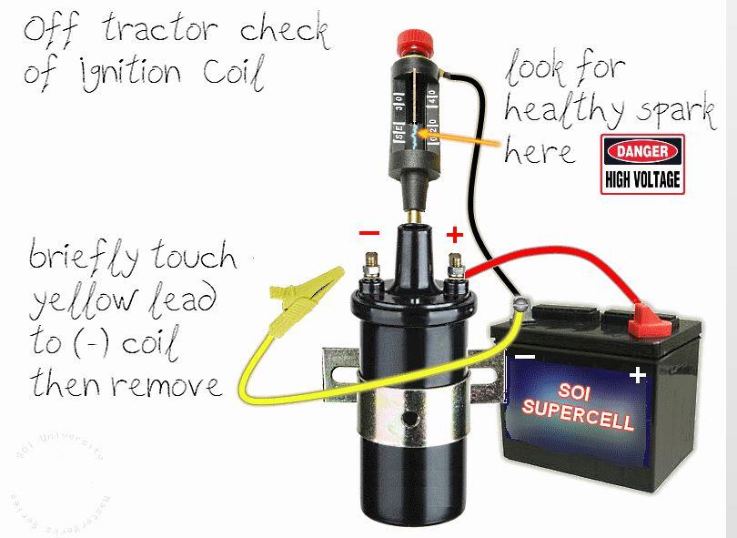

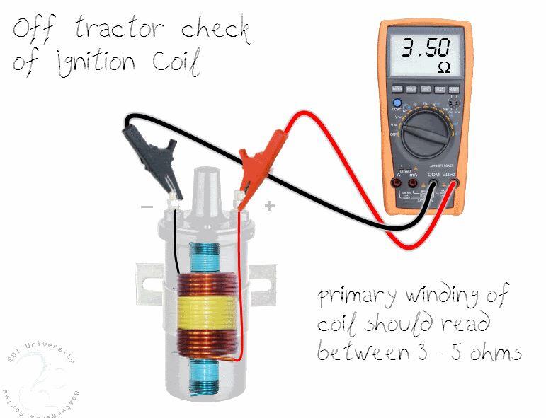

pfrederi 19,888 #10 Posted July 4, 2021 Great!! But don't junk that old coil would be willing to bet it was the plug. Coils fail out right (unusual) or act up when they get hot. You can test them. 4 Share this post Link to post Share on other sites
