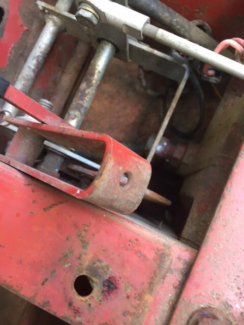

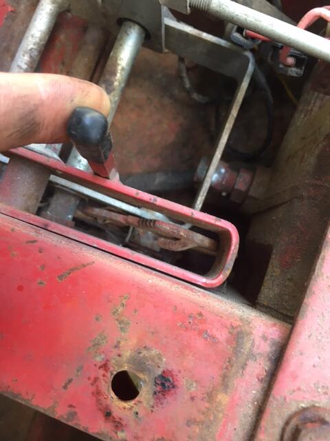

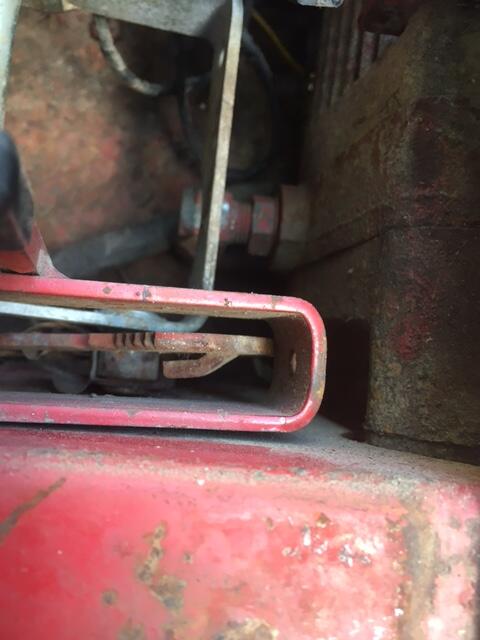

Bill Winn 157 #1 Posted June 28, 2021 Good afternoon Red Riders, My c175's parking brake does not latch. The brake itself works just fine. (in fact it works so much better than the brake on my 1988 Servistar that I nearly threw myself off due to being accustomed to having to stomp on the brake). I have attached pictures of my PB assembly for public review/ comment. Bill Share this post Link to post Share on other sites
Jeff-C175 7,206 #2 Posted June 28, 2021 (edited) Step hard on the brake pedal, pull the lever back and let go of the brake pedal. When you do that, the edge of the U shaped bracket should catch on one of the teeth. It doesn't 'latch' ? @Bill Winn Edited June 28, 2021 by Jeff-C175 Share this post Link to post Share on other sites
Bill Winn 157 #3 Posted June 28, 2021 16 minutes ago, Jeff-C175 said: Step hard on the brake pedal, pull the lever back and let go of the brake pedal. Yes, I figured that is the way it was supposed to operate the issue is that the teeth do not rotate rearward far enough to catch the u shaped bracket. Is there an adjustment to rotate the part with the teeth on it? Share this post Link to post Share on other sites
Jeff-C175 7,206 #4 Posted June 28, 2021 (edited) 9 minutes ago, Bill Winn said: No, but maybe the brake is actually adjusted too tight? Try loosening up the brake adjustment. Loosen the brake adjustment until you can engage the parking brake. With the brake engaged, tighten the adjustment so the brake stops the tractor. You should have to press the brake down pretty far to stop. Sounds like someone adjusted it too tight. Edited June 28, 2021 by Jeff-C175 1 Share this post Link to post Share on other sites
Bill Winn 157 #5 Posted June 28, 2021 30 minutes ago, Jeff-C175 said: No, but maybe the brake is actually adjusted too tight? Try loosening up the brake adjustment. Loosen the brake adjustment until you can engage the parking brake. With the brake engaged, tighten the adjustment so the brake stops the tractor. You should have to press the brake down pretty far to stop. Sounds like someone adjusted it too tight. I'll give that a try Share this post Link to post Share on other sites
Bill Winn 157 #6 Posted June 28, 2021 1 hour ago, Jeff-C175 said: Sounds like someone adjusted it too tight. Bingo, Adjusted almost totally in. I adjusted it out until the teeth caught the bracket and now we're back in parking mode. No wonder the crazy thing almost threw me off when I hit the brake. Now it feels much more normal. Thank you Jeff-C175 1 1 Share this post Link to post Share on other sites
