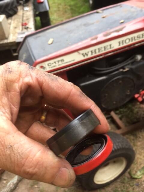

Bill Winn 157 #30 Posted July 1, 2021 (edited) Okay so here's a comparison of my old seal and the new one that arrived today from Wheel Horse Stable. Is this a problem or can I just flush fit the new seal and roll on? Edited July 1, 2021 by Bill Winn forgot picture Share this post Link to post Share on other sites

Jeff-C175 7,207 #34 Posted July 1, 2021 (edited) 8 minutes ago, Bill Winn said: Is this a problem or can I just flush fit the new seal and roll on? Not a problem. I wish we could still get the wider OEM seals but all that's available now is what you got. I've had the skinny ones installed for years now and they're just fine. Edited July 1, 2021 by Jeff-C175 Share this post Link to post Share on other sites

stevasaurus 23,662 #38 Posted July 1, 2021 You need to have the needle bearing set back far enough to accept that new seal. Most likely it is not back far enough. Look for the SKF seal not the National seal. You can measure to see if that seal will fit before it hits the bearing...it needs to be flush with the outside of the axle housing. 2 Share this post Link to post Share on other sites
stevasaurus 23,662 #39 Posted July 1, 2021 You can not tap the bearing in more to accept that seal without opening the transmission...find the 1/8" depth seal if that is the room you have for a seal. If you mess up your bearing, you are dropping the trans and replacing a bearing. 1 Share this post Link to post Share on other sites
lynnmor 8,740 #40 Posted July 1, 2021 I set the seal in a bit, having it flush will have the hub rubbing it. Share this post Link to post Share on other sites
Jeff-C175 7,207 #41 Posted July 1, 2021 56 minutes ago, lynnmor said: I set the seal in a bit, having it flush will have the hub rubbing it. Bill, the new seal was the skinny red one, right? If so, you're fine. I suspect that Steve is thinking the wider one is the new one. 1 Share this post Link to post Share on other sites
Bill Winn 157 #42 Posted July 2, 2021 11 hours ago, Jeff-C175 said: Bill, the new seal was the skinny red one, right? If so, you're fine. I suspect that Steve is thinking the wider one is the new one. Yep. New ag tires mounted, new seals in, hubs painted, rims painted, and pictures soon after this rain clears. 2 Share this post Link to post Share on other sites
stevasaurus 23,662 #43 Posted July 2, 2021 Yes, I was thinking the wider one was the new one. 1 Share this post Link to post Share on other sites
Bill Winn 157 #44 Posted July 2, 2021 25 minutes ago, stevasaurus said: Yes, I was thinking the wider one was the new one. I figured that was the case. My fault for not showing the side I had to roll up and destroy with pliers to get it out. LOL 1 Share this post Link to post Share on other sites
