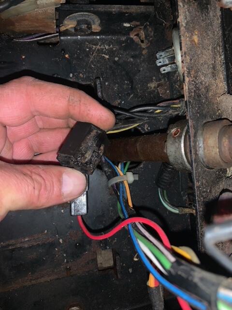

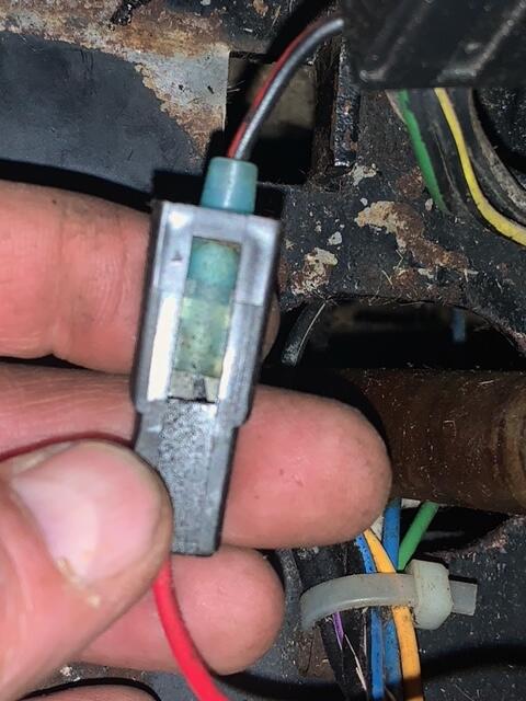

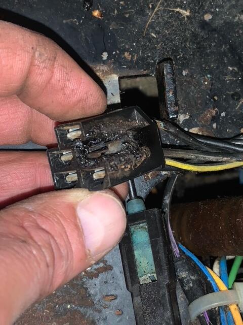

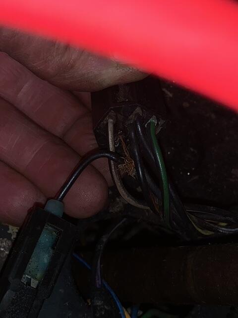

I just picked up this 317A and the hour meter and voltage meter are not working. Upon my investigation there are some issues at the ignition plug (melted) and the top terminal wires are frayed. they did not put fuse back in and it goes to the test button. anyone have a wiring  diagram for this model? I am going to have to either replace the harness or plug each circuit directly into the switch.
Is there any way to get the wires out of the plug and just replace the plug without buying the whole harness?

I think you had the problem at the ignition switch.  You should be able to get a pigtail at NAPA and a new switch.
Edited by lynnmor

Yes the terminals can be removed from their holder.
Here is the switch and connector
Once you get your first one out the mystery is solved.

thank you. discovered more issues. Mouse nest and wires chewed. All of them from the hour meter. Have to figure out that mess. I am thinking it is a junction point since there should only be pos and neg connections.
