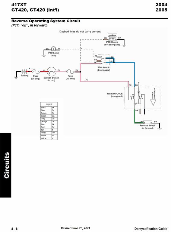

Hello,
I have a 2003 417xt with a PTO that won’t engage. Midway thru mowing the lawn, after I backed up, it would not re-engage. I can’t on initial inspection find any obvious shorts/frayed wires and I bought a new switch but that didn’t help. Any suggestions would be greatly appreciated.

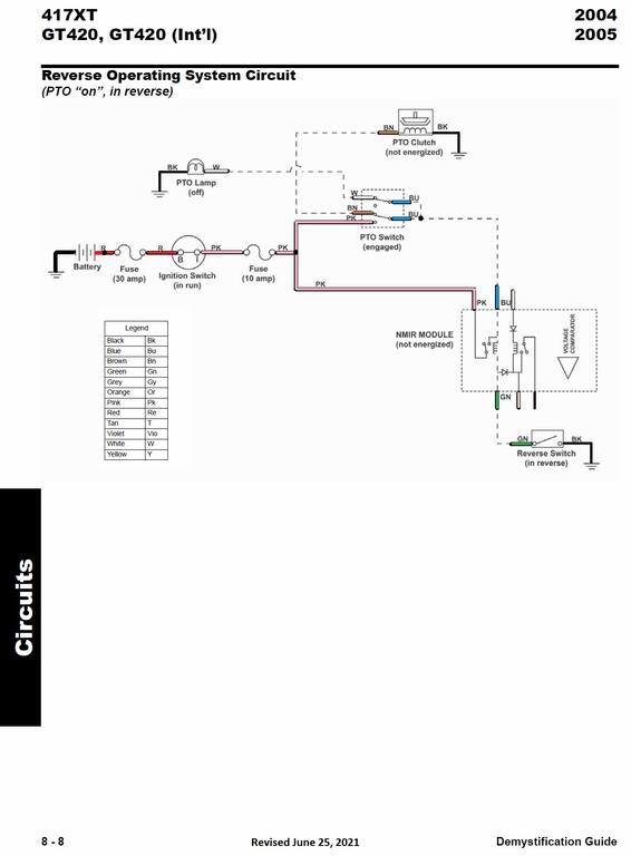

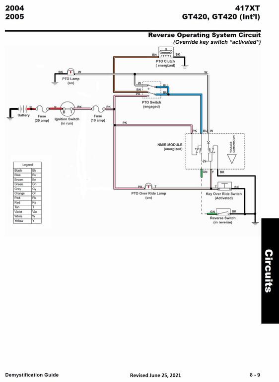

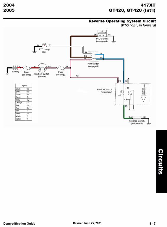

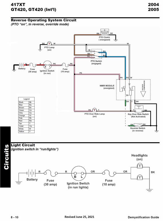

One I have not added any color to yet but working on it. Two of the pto pages included with more to follow

gwest_ca
After all that I did the wrong year but looking back 1993 is the same.
Can be downloaded in pdf format if you want larger image
  • Thanks 1

gwest_ca
If the reverse switch can't close the pto will not work.
Here is the complete 2003 file

Wheel Horse312-8
I needed to replace the NMIR module, all good, while I was down there I replaced all the belts, running great!
