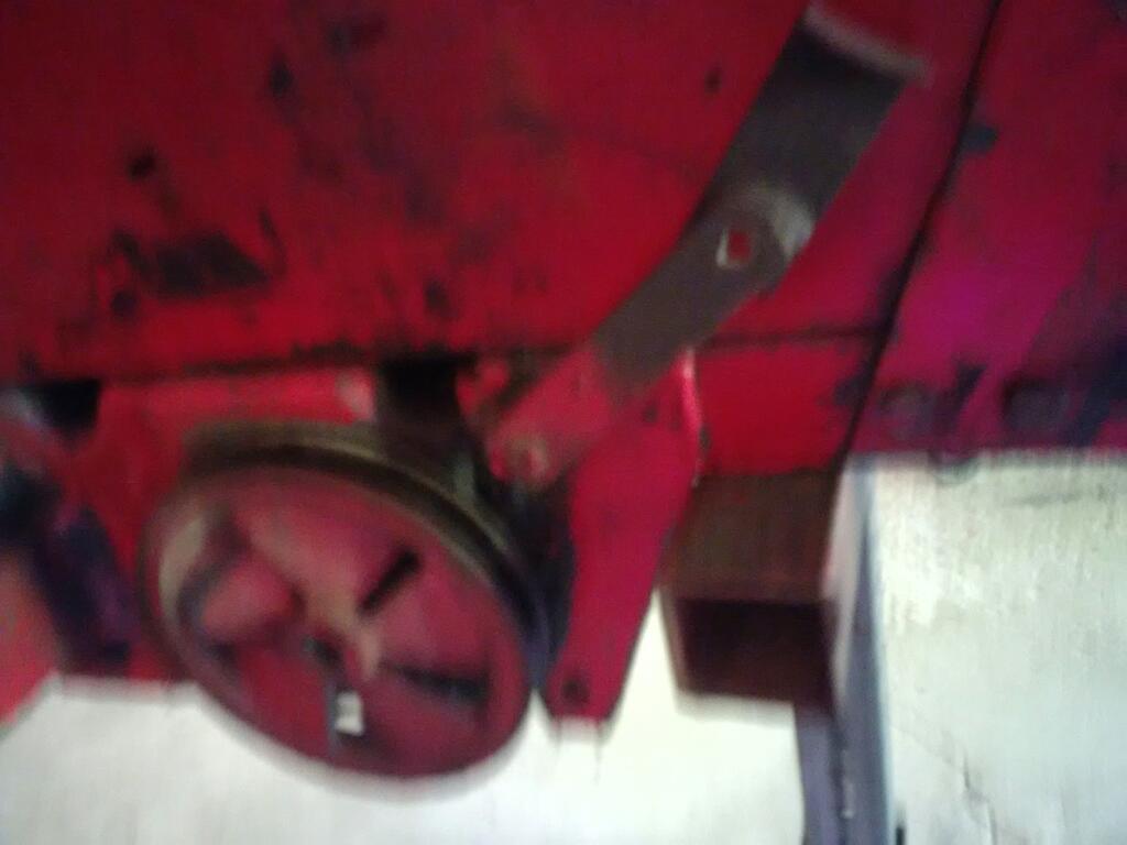

Uxtractor 8 #1 Posted June 24, 2021 Good day all , Recently I picked up a 1969 Wheel Horse 12 hp Raider in rough shape it is missing a fair bit right now I am looking for the travel pulley that would have been on the arm that is moved by the clutch brake pedal . I don,t know if the missing pulley was flat or a vee type or the diameter . Could some one when they have time please tell me the diameter and type of pulley , the arm where it was is right beside the transaxle drive pulley then I can pick one up .The picture is not very clear sorry . Thanks Mike Share this post Link to post Share on other sites
pfrederi 19,131 #2 Posted June 24, 2021 (edited) It is a V pulley WH # 7451 updated toToro 95-7668 Or Stens 280-362 or Stens 280-313 also available for less from one of our vendors wheel horse parts and more. https://wheelhorsepartsandmore.com/product/95-7668-7451-toro-wheel-horse-pulley/ Welcome!!!! Edited June 24, 2021 by pfrederi 2 1 Share this post Link to post Share on other sites

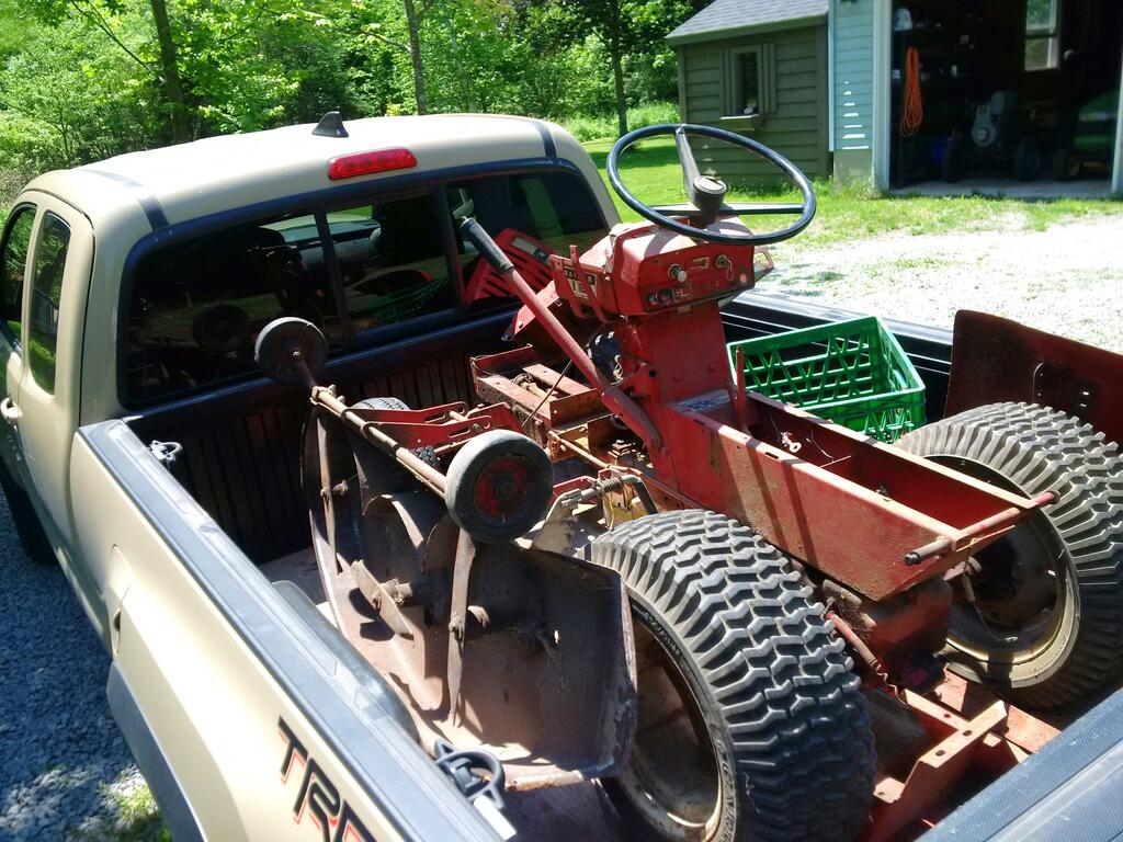

oliver2-44 11,033 #3 Posted June 25, 2021 of the whole tractor Share this post Link to post Share on other sites

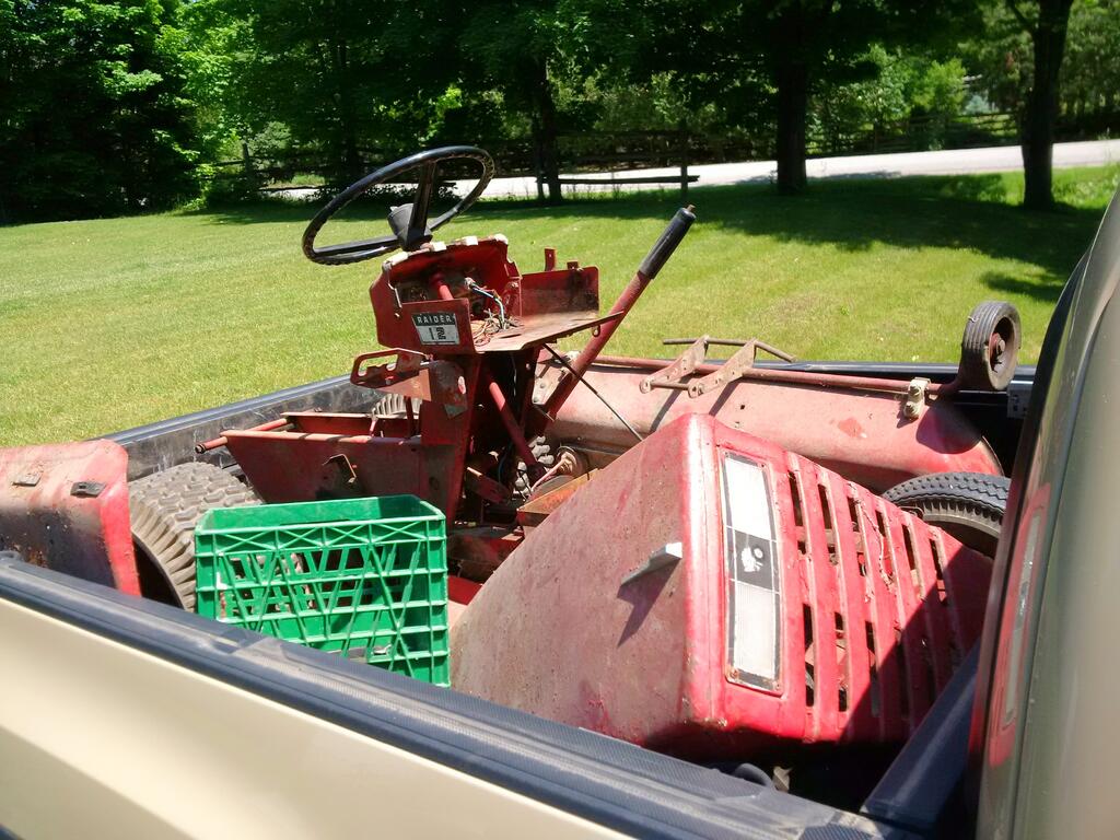

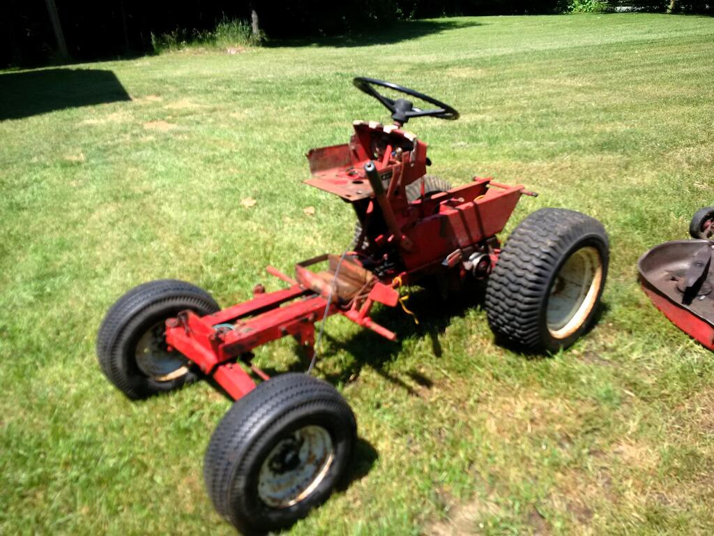

Uxtractor 8 #4 Posted June 25, 2021 Thank you gents for what I am sure is not the last time ! Tis a ugly beast missing much but it keeps me busy I always wanted one because of the I believe there was a connection to AMC and I liked their vehicles . I managed to find most of a Kohler 12 hp and working on that too the deck seems okay although the J lift bolt was chopped with bolt cutters .They even had monogrammed front tires they must have been a big concern at one time certainly look well made .I post back back as I got to be sure they will be more questions .Cheers Mike 1 Share this post Link to post Share on other sites
Uxtractor 8 #5 Posted July 7, 2021 Good day everyone , The ilder drive pulley came and I also got a drive belt and everything went together fine put the side cover and right side floor board on and it is starting to look like a tractor again . Hopefully the transalxe is okay because I found a semi complete 12 kohler and a 14 hp Kohler so now I have a mounted engine .Thanks for help . Cheers Mike 1 Share this post Link to post Share on other sites
