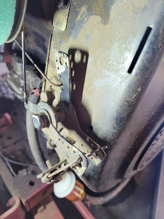

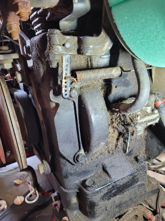

BIGxBUBBA94 0 #1 Posted June 24, 2021 Hello, I've inherited a WheelHorse 310-8 from my grandfather years ago. Its been a project to get it back to running after sitting for years. Currently it idles with the walbro carb but at half throttle it sounds like its rpms are way to high. I'm wondering if they sell a different carb for it that had a throttle adjustment or if I'm missing something on the current carb. Rear fender says 2110k806 Thank you Share this post Link to post Share on other sites
gwest_ca-(File Mod) 11,921 #3 Posted June 24, 2021 Welcome to Red Square Here are 2 pages of files for the 21-10K806 https://www.wheelhorseforum.com/search/?&q=21-10k806&type=downloads_file&page=1&search_and_or=or&sortby=relevancy They are in no particular order so look through them all. Sounds like the governor is not working correctly. The Kohler service manual should help. Let us know what you find out. Garry 1 Share this post Link to post Share on other sites
BIGxBUBBA94 0 #4 Posted June 24, 2021 I was informed today that someone attempted to adjust these years ago and they do not know if they put them back right. I am currently going through the manual to see if they are correct. Share this post Link to post Share on other sites
