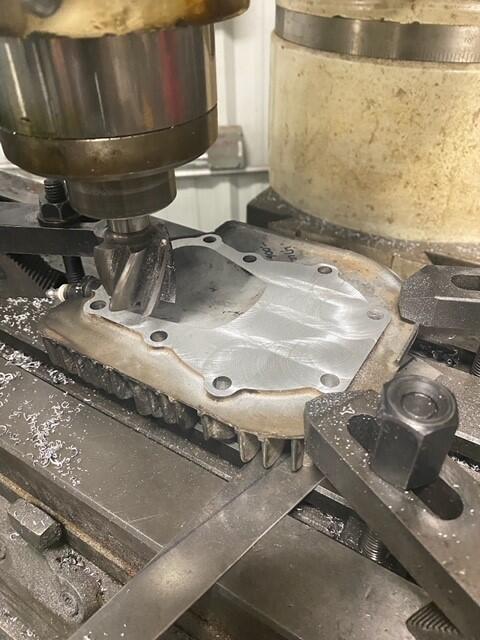

Greentored 3,220 #5 Posted June 24, 2021 I have done many, but have no way to hold the heads and run a fly cutter across- just using a 1.5" end mill with multiple passes, and touch them up on a marble surface plate with 180 grit. Never had a problem, its just not 'technically' the right way its normally done. Share this post Link to post Share on other sites

Greentored 3,220 #7 Posted June 24, 2021 2 hours ago, 305 said: I have a fly cutter , just don’t know how to hold it......thus the need for special tooling. I imagine one could be made very simply same issue haha. I get picked on whenever posting a pic, cutting one with an end mill....but the end result is the same Share this post Link to post Share on other sites

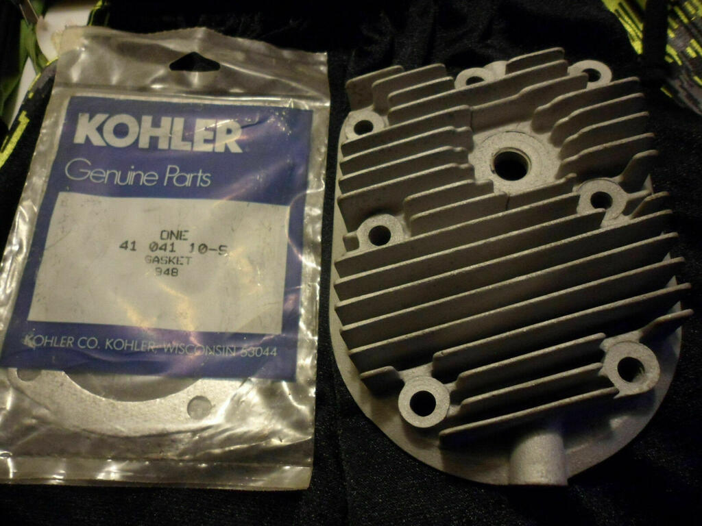

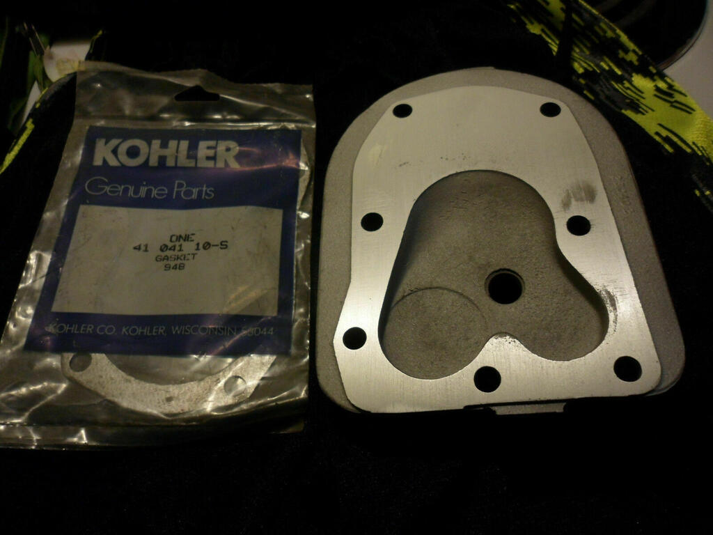

305 380 #8 Posted June 24, 2021 (edited) i'm not familiar with Kohler engines so i stole a couple pictures of a NOS head for a K181...just for an example as it seams to be a very common engine on Wheelhorses if all those machined surfaces for the headbolts are the same height a simple fixture could be made to index off them. clamp through the sparkplug hole with a bolt and washer put it in the mill with a fly cutter and you would be done in minutes Edited June 24, 2021 by 305 2 Share this post Link to post Share on other sites

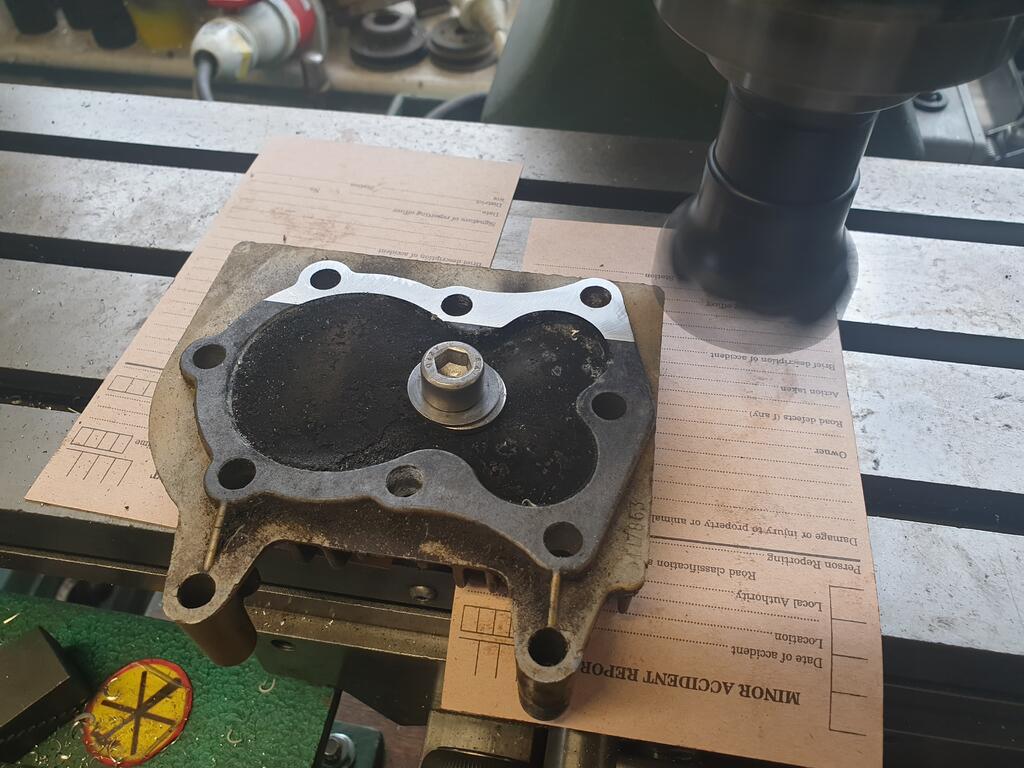

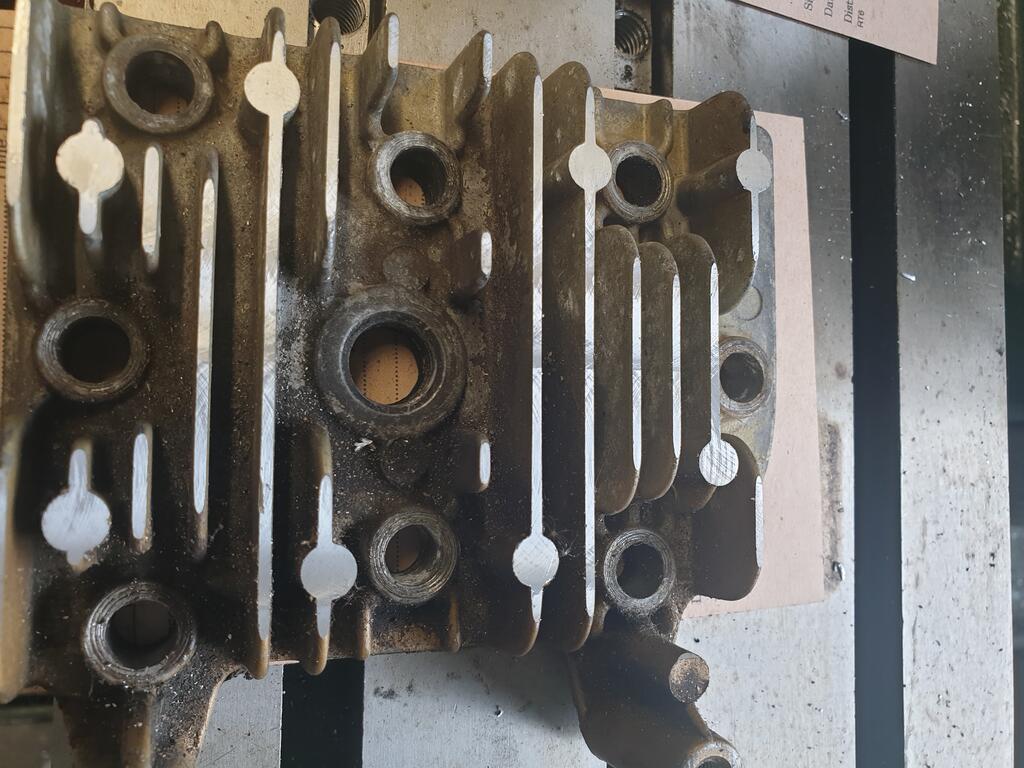

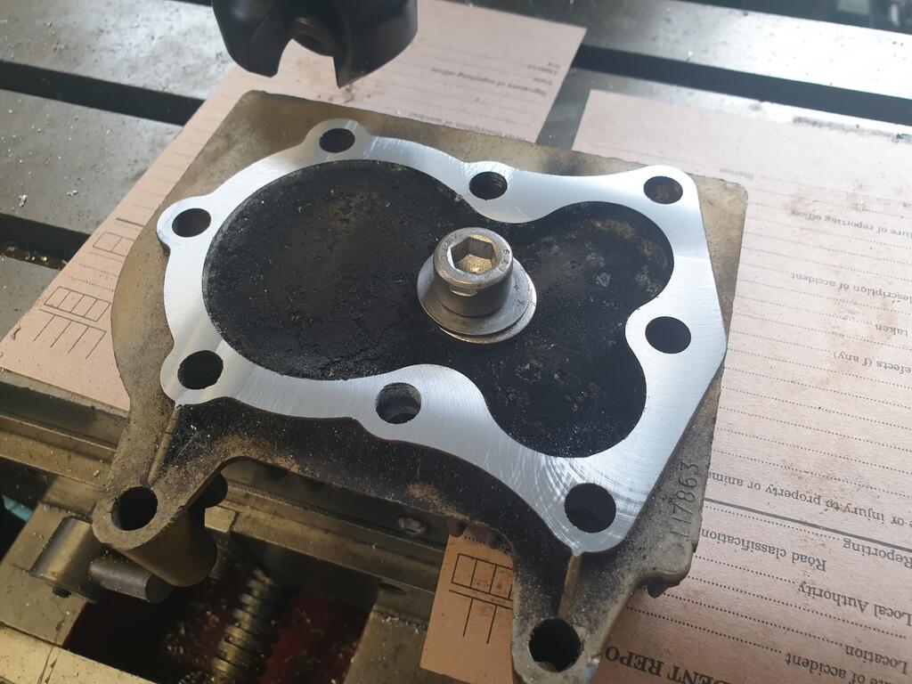

Mickwhitt 5,246 #12 Posted June 25, 2021 This is a bit down and dirty but I only had a scruffy little cylinder head to play with. As this head had a series of posts cast into the cooling fins I decided to clamp the head gasket side down and skim the top of the fins to get a flat reference surface. Then I flipped the head over and clamped it through the spark plug hole using thin card as a cushion to help grip. I used an insert face mill to do several passes with just enough cut to remove any warp. Finished result looks ok. A little hone on a flat surface plate and its good to go. If the head can't be milled flat on the top surface then appropriate spacers would have to be made to sit under the stud holes to get it level. Mick 1 2 Share this post Link to post Share on other sites
