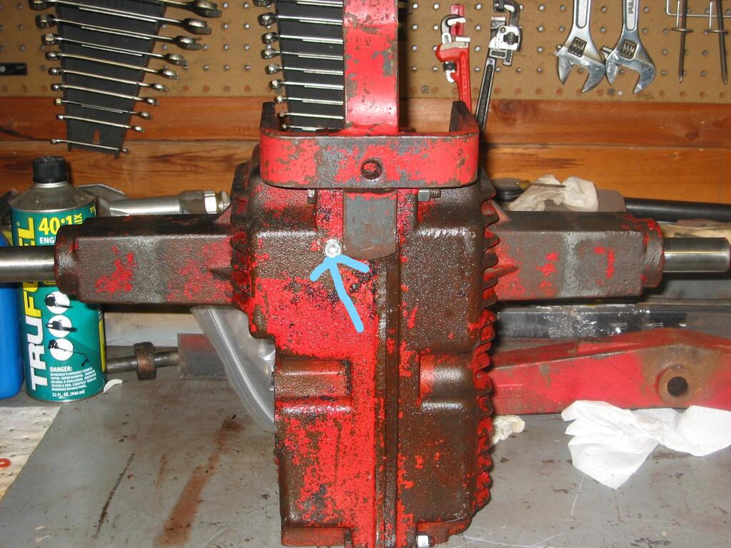

DCwom 78 #1 Posted June 24, 2021 (edited) So I've finally got to the transmission on my dad's old Raider 12. I took the trans oil fill plug out and water came gushing out, lots of clear water until it slowed to a trickle then a mixture of oil & water, not really unexpected other than the volume of water at the oil fill level, this has sat for a while outside. But my real question is the drain plug on the bottom of the trans, I can't really see it, but after a bunch of blurry phone pictures I think its a set screw type of plug, since a 1/2 wrench slips on it but a 7/16 doesn't fit. I tried my largest Allen key but I think its too small. Anybody have an idea what size Allen this pug could be? Also Its a 6 speed, 3 speeds with a hi/low lever. Dennis Edited June 24, 2021 by DCwom update trans type Share this post Link to post Share on other sites
pfrederi 18,638 #2 Posted June 24, 2021 1/4" ALLEN WRENCH 3 1 Share this post Link to post Share on other sites
Jeff-C175 7,206 #3 Posted June 24, 2021 (edited) Dennis, I've probably got one you can have. I'll trade it for a lift flag. Wanna come pick it up? @DCwom Yes, I've got a long handle one (which you will need for leverage) that you can have. I'll message you my address if you want it. Bring lift flag... Edited June 24, 2021 by Jeff-C175 Share this post Link to post Share on other sites
oliver2-44 10,688 #4 Posted June 24, 2021 That transmission should really be split and cleaned. But if you've had it running and it is shifting freely, you might try a couple of flushes with diesel or kerosene. Then drive it around in all gears to warn it up and then drain, refill, drive, drain repeat until fairly clean fluid comes out. When draining remember to lift the front of the horse as high as possible to drain the area in front of the hump. Fill with 2 quarts of 80/90 gear oil of the brand of your choice. 1 1 Share this post Link to post Share on other sites

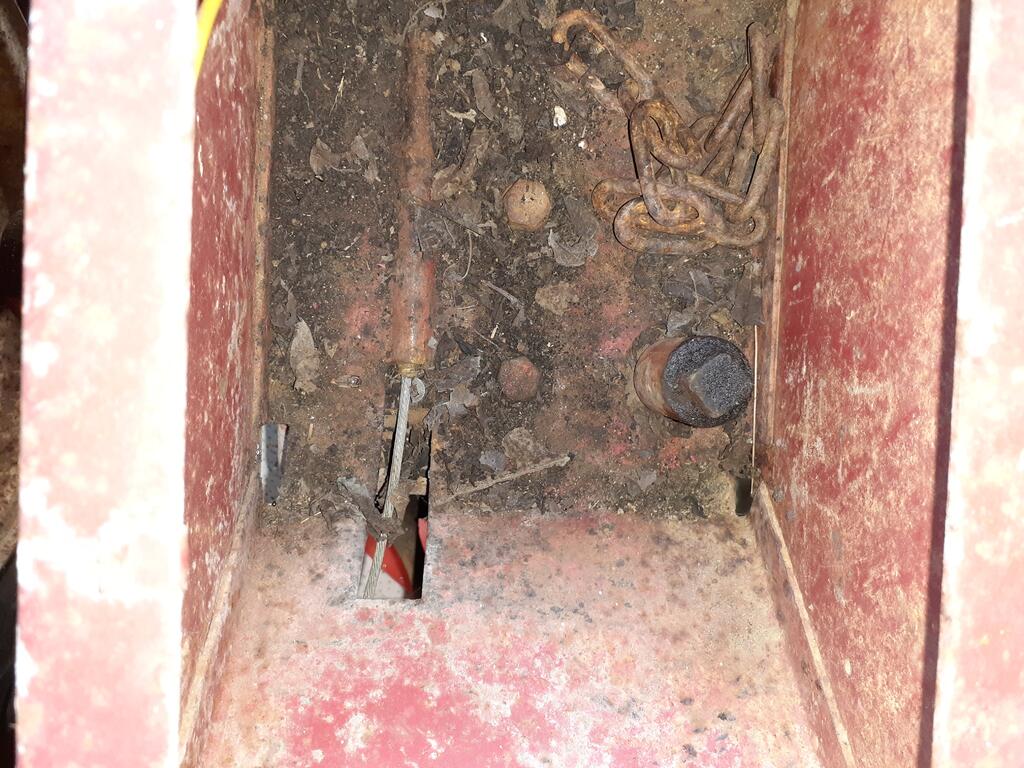

DCwom 78 #6 Posted August 1, 2021 (edited) Ok, I managed to flush the trans a couple of times with Kerosene and now thanks to Jeff-C I've got some gear oil to do a final flush, however I've got a new problem, I've been using the side fill hole plug on the transmission then I found the fill plug/tube under the seat under a bunch of leaves, but I can't get it loose, its 1/2 square but there isn't any room to maneuver an open end wrench in the seat box and I can't use a socket on a square head, any ideas? I was only able to get about a quart in using the side hole. Edited August 1, 2021 by DCwom Share this post Link to post Share on other sites
gwest_ca-(File Mod) 11,449 #7 Posted August 1, 2021 They do make 8-point sockets but may be hard to find. Water in the oil gets there by following the shifter down to a damaged boot. Should be replaced. With the shifter out of the transmission that is another good place to add oil. Garry Share this post Link to post Share on other sites
Jeff-C175 7,206 #8 Posted August 1, 2021 Dennis, I have (but need to find then) some 8 point sockets. Can you get a measurement on that? Or maybe someone already knows the size. I hope I can find those sockets and they didn't get thrown out! Share this post Link to post Share on other sites
953 nut 59,774 #9 Posted August 1, 2021 10 hours ago, DCwom said: ound the fill plug/tube under the seat under a bunch of leaves, but I can't get it loose, its 1/2 square A 12 point socket should work. 1 Share this post Link to post Share on other sites
oldredrider 2,553 #10 Posted August 1, 2021 Why not just use a crow's foot? Share this post Link to post Share on other sites
squonk 43,734 #11 Posted August 1, 2021 12 pt socket will fit but on stubborn plugs they may break and slip. 8 pt sockets can be ordered thru NAPA, Grainger, & McMaster-Carr. I have a complete set from working on pumps. Share this post Link to post Share on other sites
DCwom 78 #12 Posted August 1, 2021 8 hours ago, Jeff-C175 said: Dennis, I have (but need to find then) some 8 point sockets. Can you get a measurement on that? Or maybe someone already knows the size. I hope I can find those sockets and they didn't get thrown out! Jeff, It's definitely 1/2", I was able to get a 1/2" wrench on it. Share this post Link to post Share on other sites
DCwom 78 #13 Posted August 1, 2021 1 hour ago, oldredrider said: Why not just use a crow's foot? I thought of that, but don't have a set, I wasn't sure it there was some trick I might have overlooked. Share this post Link to post Share on other sites
Jayzauto 89 #14 Posted August 1, 2021 If that plug has a 1/2" head on it, Try using a 1/2" socket extension on it, upside down. Use a length that will clear the tool box, then use an adjustable wrench, or a Long 1/2" wrench on the male end of the extension. Save's running around looking for hard to find sockets to fit the application. That trick also works for reaching up under lawn mower decks to drain the oil. GLuck, Jay 1 Share this post Link to post Share on other sites
Handy Don 13,980 #15 Posted August 1, 2021 5 hours ago, squonk said: 12 pt socket will fit but on stubborn plugs they may break and slip. 8 pt sockets can be ordered thru NAPA, Grainger, & McMaster-Carr. I have a complete set from working on pumps. Consider deep reach if you are getting a second set of sockets in sizes you already have but with 8 pts. I got a set of deep 6 pts. that I use on all "tough" nuts and bolts--they are stronger, impact capable, and I've yet to round off a nut or bolt using them. Share this post Link to post Share on other sites
