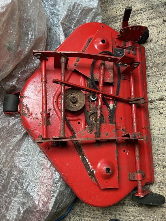

Graham529 16 #29 Posted July 1, 2021 Hi Garry, Its a 3 blade, 36 inch cut reach discharge. I have attached a picture, there is no serial numbers visible. many thanks Graham Share this post Link to post Share on other sites
gwest_ca-(File Mod) 12,535 #30 Posted July 1, 2021 Here is a list of the decks in the order they were produced Mower DNA 1972 model 5-0620 replaced by 1973-1974 model 5-0621 1975 model 5-0622 1976 model 65-36XR01 1977 model 75-36XR01 1977 model 75-36XR02 1978 model 85-36MR01 1979 model 95-36MR00 (Blades up to this point have the 5/8" x 3/4" double-D center hole unless the spindle has been upgraded) --------------------------------------------------------------------------------------------------------------------------------------------------------------------------- (These decks used blades with a 3/4" center hole) 1979 model 95-36MR01 replaced by 1980-1982 model 05-36MR01 - Last year for bearings with 3/4" ID 1983-84 model 05-36MR02 - First year for bearings with 17mm ID unless older spindles were updated. 1985 model 05-36MR03 1986-1990 model 05-36MR04 1991-1993 model 05-36MR05 1993-2006 model 78305 1 Share this post Link to post Share on other sites
