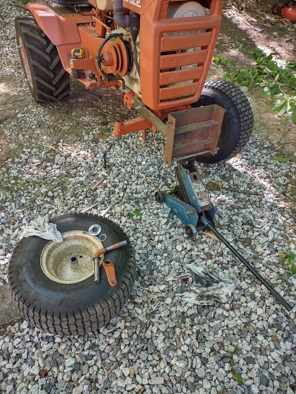

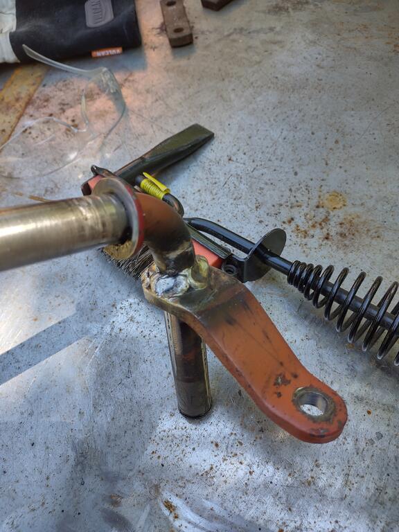

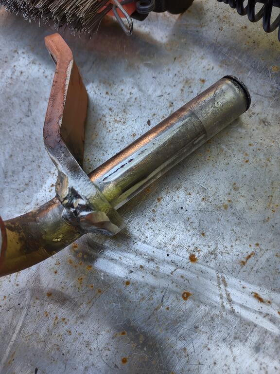

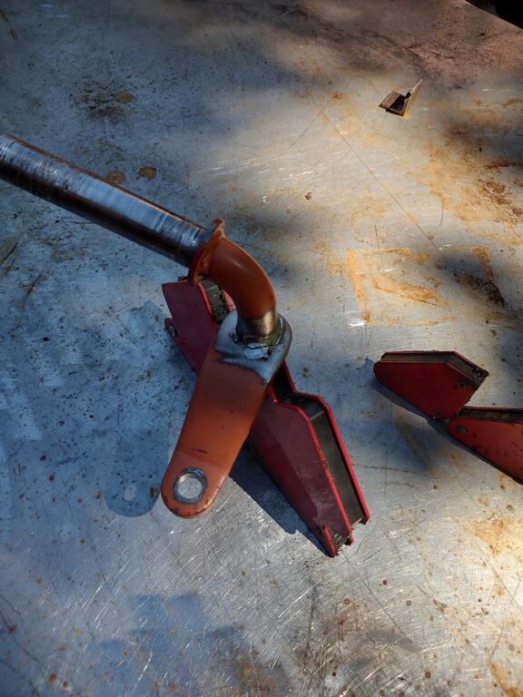

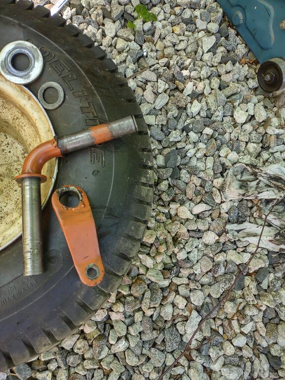

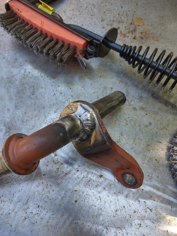

ebinmaine 77,309 #1 Posted June 20, 2021 Yesterday while coming up out the forest the right side spindle arm welds snapped. As one could imagine this causes some fair difficulty steering due to lack of connection to the steering system. Turns out there was barely half a weld there. I'm really surprised it lasted this long. I got it all disassembled and cleaned up intending to get welding this morning. Had some fun lining things up but got it to set ok eventually. Here's post-weld. I'll be needing someone with access to a lathe to drill 3/4" holes into some trailer stubs so I can upgrade to the 4 or 5 lug trailer wheels. @Achto @Wheel Horse 3D @Oldskool Any of you help me out for a small fee? 8 1 Share this post Link to post Share on other sites

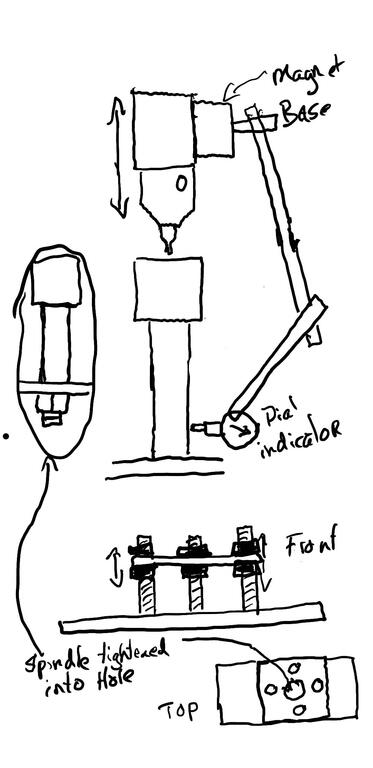

Wheel Horse 3D 3,823 #3 Posted June 20, 2021 Looks like the original welds were 2 tiny straight lines. Once we get through big show im debating getting an extension for my mini lathe just for that purpose. My other option is an adjustable plate that I can precision align on the drill press with my dial indicator and do it that way. Share this post Link to post Share on other sites
ebinmaine 77,309 #4 Posted June 20, 2021 1 hour ago, Wheel Horse 3D said: My other option is an adjustable plate that I can precision align on the drill press with my dial indicator and do it that way. I have a full sized stand up drill press of some age and moderate accuracy. I'd like to drill them myself if I could get ahold of the tools to do so. What is it you'd do? Share this post Link to post Share on other sites
Wheel Horse 3D 3,823 #5 Posted June 20, 2021 Hopefully this helps. The idea is to get the spindle perfectly vertical, by running the indicator up and down the bearing surface with the drill press. Align with a short bit so you have room to run up and down, and the bit can still indicate center of the drill axis. Within .005 top and bottom should be possible, and this measurement should be done on one side, and then the front(90 deg). It will take careful tuning but once lined out should be able to remove one spindle, fasten in the next, do a check of alignment and pretty much go. Share this post Link to post Share on other sites

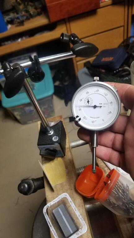

Wheel Horse 3D 3,823 #6 Posted June 20, 2021 Got my dial indicator and base at HF for i think about 35 all together. Share this post Link to post Share on other sites

ebinmaine 77,309 #11 Posted June 20, 2021 @Wheel Horse 3D Grey that's about what I had in mind. I can't get anywhere close to that precisenessess with this old drill press. Share this post Link to post Share on other sites
ebinmaine 77,309 #12 Posted June 20, 2021 On other news, the lame horse is all healed up and back in the stable resting. 2 8 Share this post Link to post Share on other sites
Wheel Horse 3D 3,823 #13 Posted June 20, 2021 1 minute ago, ebinmaine said: @Wheel Horse 3D Grey that's about what I had in mind. I can't get anywhere close to that precisenessess with this old drill press. Nice thong about the lathe is it self centers . 2 Share this post Link to post Share on other sites
