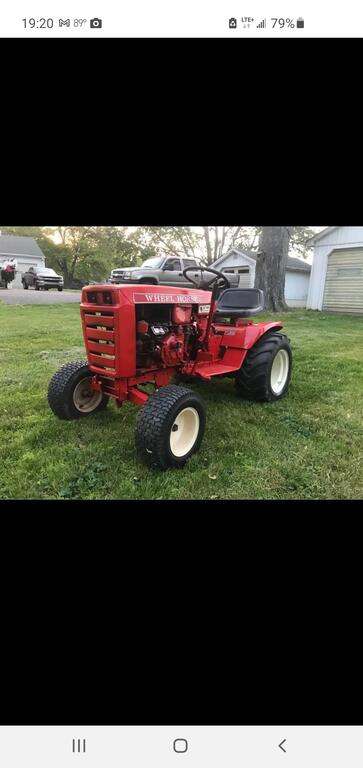

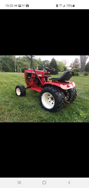

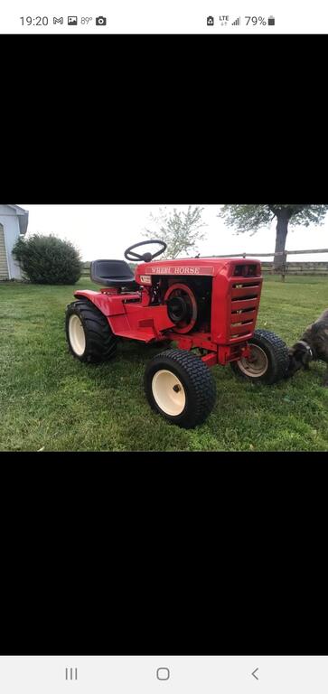

mrodgers 2 #1 Posted June 19, 2021 Hello All, I recently acquired a C-160 that I am working on restoring most things are minor and I may ask questions later. The biggest problem I have is that someone before me swapped the Kohler 341 for a Yanmar TS50C diesel engine (5 hp). Because of this I can't run anything off the PTO. In addition parts are impossible to find because it was an imported engine from the 70's. Does anyone know where I can find a new or rebuilt engine? I would really like to bring this tractor back to as close to original as possible. Also any advice anyone has for replacing the engine would be greatly appreciated. Thanks in advance! 2 Share this post Link to post Share on other sites

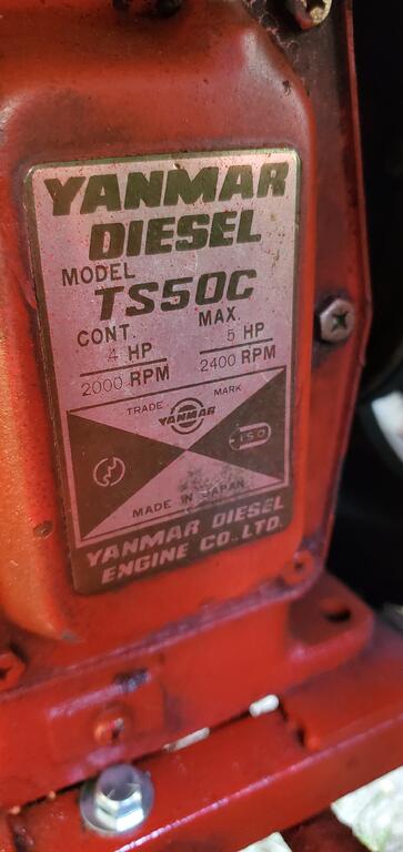

mrodgers 2 #5 Posted June 20, 2021 There is a filter missing, a cover for the intake is missing as well. I also wanted to Reroute the muffler/exhaust up. I don't mind keeping the engine I just don't know where to find parts. I will upload some close up pictures when I get home. Here is the engine plate. Share this post Link to post Share on other sites
Maxwell-8 4,370 #6 Posted June 20, 2021 https://yanmarengines.com/find-a-distributor-united-states/ 1 Share this post Link to post Share on other sites
