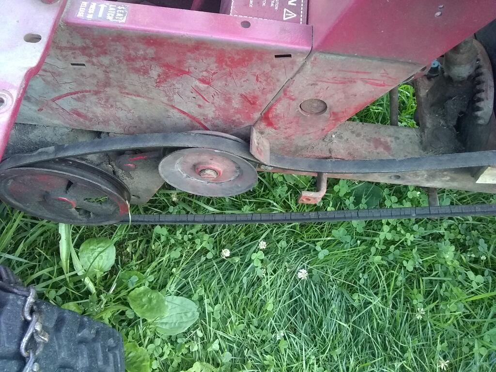

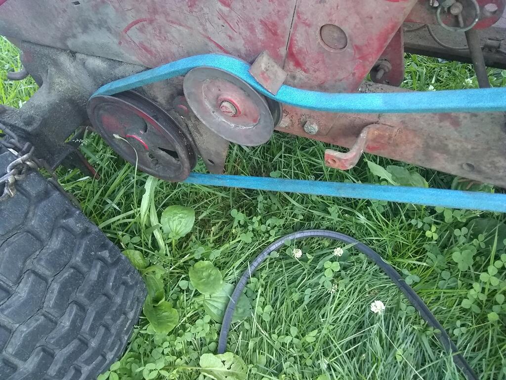

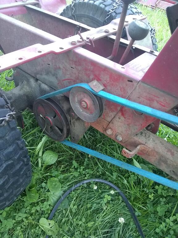

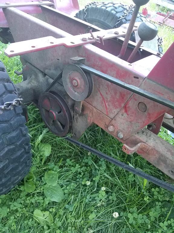

vogli 90 #1 Posted June 18, 2021 (edited) I've got a 1973 Raider 12, and I've replaced the drive belt, with a 7473 belt (as per the IPL). It is far too tight, it seems. The metal piece over top of the tensioning pully rides the top of the belt constantly, and because of the angle, never really allows the belt to detension. As a result, it's constantly driving the transmission - I can't stop it. A 7478 belt is too loose, and even with the tension pulley back as far as it can go, there is insufficient tension to keep the belt from slipping. I've tried it with and without the shield in place (it appears that is supposed to help pinch the belt, when the clutch is depressed). It seems obvious to me that I must be doing/missing something stupid/obvious, but I can't quite determine what it is. Any advice? Edited June 18, 2021 by vogli clarification Share this post Link to post Share on other sites
ebinmaine 77,516 #2 Posted June 18, 2021 Have you double checked the stamping number on the new belt? Being blue that isn't a Toro belt. Looks like Stens or maybe TSC? Best bet would be to bring the old belt and that incorrect new belt back to where you bought it and maybe the pictures above. Have them measure it in a belt gauge. 2 Share this post Link to post Share on other sites
daveoman1966 3,882 #3 Posted June 18, 2021 The blue belt you show is NOT and OEM belt. The geometry of it is NOT the same as OEM design either....especially with these older babies. The blue belt is either too wide, too thick, or just unable to drop into the V pulleys and precisely MATCH to shape of the pulley. Accordingly, the blue belt rides higher in the pulleys...effectively causing a 'shorter' belt. Go get a OEM 7473 belt here...your problems will go ghost on you. https://www.psep1.biz/arinet.asp?aribrand=TO# 4 Share this post Link to post Share on other sites
oliver2-44 11,258 #4 Posted June 18, 2021 Do a quick compare of the width of the top of the old and new belt and I from the pictures it looks like what Dave said is spot on. 1 Share this post Link to post Share on other sites
squonk 45,591 #5 Posted June 18, 2021 (edited) I use those blue belts all the time. No issues at all. Just put an 82" on a Raider 14. Works perfectly. Back out that bolt on the idler and move that guide off the pulley some. How about a pic with the pedal depressed. Edited June 18, 2021 by squonk 2 Share this post Link to post Share on other sites

vogli 90 #14 Posted June 18, 2021 4 hours ago, squonk said: I use those blue belts all the time. No issues at all. Just put an 82" on a Raider 14. Works perfectly. Back out that bolt on the idler and move that guide off the pulley some. How about a pic with the pedal depressed. Here's with the clutch depressed. Sorry, the angle is a bit different in each, and not sure if I had the clutch in equally. I'd be fine with the belt rubbing some, if the I could disengage the transmission. As it is, it starts a little harder, and I can't shift into gear. If that guide could move...I think my problem would disappear. Note that I still have the brake fairly loose. Perhaps if I tightened that up, I could use the brake to slow the transmission enough to shift, and eventually the belt will wear enough to make that easier. Previously I could shift with just the clutch, before the brake kicked in. Share this post Link to post Share on other sites
