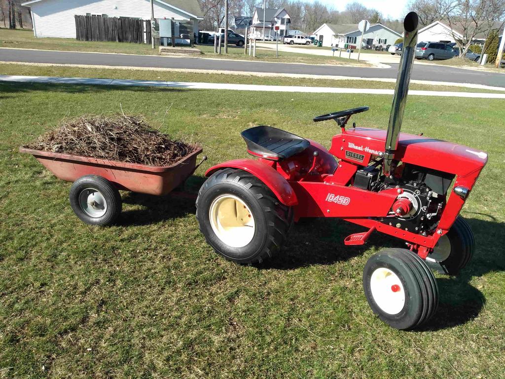

Achto 29,798 #2 Posted June 16, 2021 (edited) Awesome. I really like using my 1045D that I built. It's a horse of many years and models, but it came together well. Some day I just might find some kind of job that will slow the 9.9hp Hatz engine down. Edited June 16, 2021 by Achto 3 Share this post Link to post Share on other sites
JUSS10 250 #3 Posted June 16, 2021 19 minutes ago, Achto said: Awesome. I really like using my 1045D that I built. It's a horse of many years and models, but it came together well. Some day I just might find some kind of job that will slow the 9.9hp Hatz engine down. Thats awesome! Did you do a build thread on this? Looks like you had to raise the hood a bit to make it fit? Would love to hear what issues you ran in to on the swap. Is that just a straight stack for the exhaust? I know I'll have to make some mods to the exhaust to make it all fit. Share this post Link to post Share on other sites
Achto 29,798 #4 Posted June 16, 2021 19 minutes ago, JUSS10 said: Did you do a build thread on this? I did raise the dash and the hood hinge 3" to make the engine fit. The stack does have a baffle inside, still a little load though. Stretching the wiring harness, adding a return port to the fuel tank, making a drive belt guard, and fitting the hood were the only real challenges that I can remember off hand. Here is a link to the build. It's kind of in reverse order as I introduced Radpferd first and then added some build pictures later. 1 Share this post Link to post Share on other sites

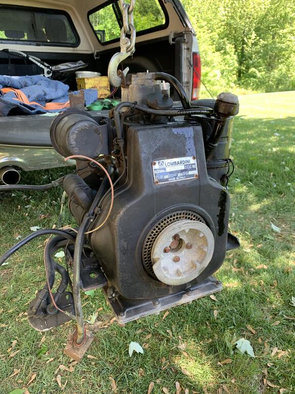

Maxwell-8 4,367 #5 Posted June 16, 2021 (edited) 1 hour ago, JUSS10 said: 7HP Lombardini diesel engine bellicimo! Great engine made in Italy, think they to moved to china a couple off years ago. Since Kohler bought Lombardini. 7 hp but pulls like a 10-12 hp. 40Hours!!! That means it is still running on the break-in oil. They need oil every 100 hours (yanmar diesels anyway) They last for tousands of hours. Tat is why they are used on all high-end walkbehind tractors (Goldini) here in Belgium. New price of such an engine here is an equivalent of 2250$ Edited June 16, 2021 by Maxwell-8 Share this post Link to post Share on other sites
JUSS10 250 #6 Posted June 16, 2021 2 minutes ago, Maxwell-8 said: bellicimo! Great engine made in Italy, think they to moved to china a couple off years ago. 7 hp but pulls like a 10-12 hp. 40Hours!!! That means it is still running on the break-in oil. They need oil every 100 hours (yanmar diesels anyway) They last for tousands of hours. Tat is why they are used on all high-end walkbehind tractors here in Belgium. New price of such an engine here is an equivalent of 2250$ Yeah that was my thought. In general, it seems like these older diesels, and diesels in general are "under rated" compared to gasoline engines. I was amazed at how clean the oil was when I checked the dip stick, I assumed it had been changed till I found the hour meter in the control box and saw it only said 40 hrs. The engine hasn't even been broke in yet if thats accurate. The other nice thing about this engine is it has an external larger oil filter which is a nice touch. Pretty sure this is a legit Italian one. It came from a construction sign and here in the US, those got swapped out to all electric 10-15 years ago I'd guess. This one may have been at the tail end of the diesel powered ones? 2 Share this post Link to post Share on other sites
Maxwell-8 4,367 #7 Posted June 16, 2021 1 minute ago, JUSS10 said: external larger oil filter All "older" diesel ask for a 100 hour oil interval so is my Hatz diesel. But they all have small internal filters. 2 minutes ago, JUSS10 said: Pretty sure this is a legit Italian one Yes it is. couple years ago you had Hatz, Deutz, Yanmar. All european made. B&S, Kohler USA made. Only Yanmar still produces in Italy all the rest-> China. Not to be political or anything just find it hard things are going this way. And I have bad luck with chinees made stuff. 3 minutes ago, JUSS10 said: "under rated" compared to gasoline engines. They make the rated Horsepower, but the torque is just way better. And so is fuel economy (3x better?). That heavy flywheel doesn't stop easily. 1 Share this post Link to post Share on other sites

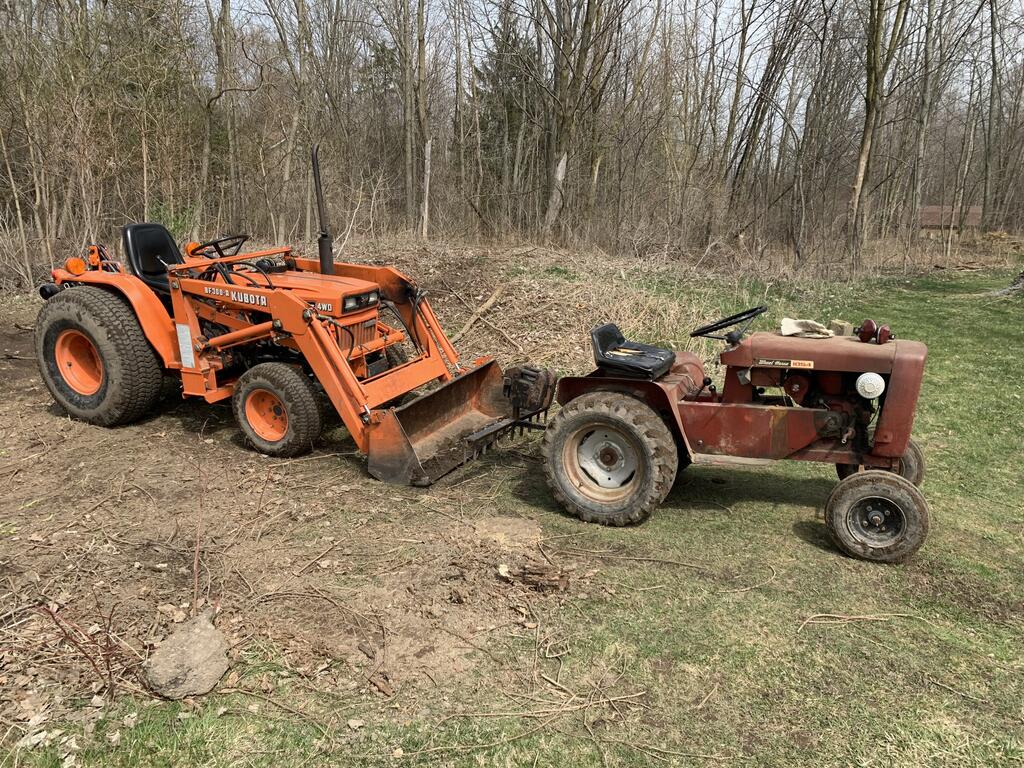

JUSS10 250 #10 Posted June 16, 2021 This is the 1054 I plan to put it in, next to the Kubota that does the heavy heavy work. 3 Share this post Link to post Share on other sites
ebinmaine 74,531 #11 Posted June 18, 2021 On 6/16/2021 at 2:34 PM, JUSS10 said: This is the 1054 I plan to put it in, next to the Kubota that does the heavy heavy work. Sounds like a good project. Looking forward to it. On 6/16/2021 at 11:20 AM, Achto said: It takes about 10hrs to burn through 1.5gal of fuel with my Hatz 1B40. Are you kidding me?? On my Cinnamon Horse C160 I go through a gallon of gas in somewhere between 2.5 and 3.5 hours depending on what I'm doing with it. 1 Share this post Link to post Share on other sites

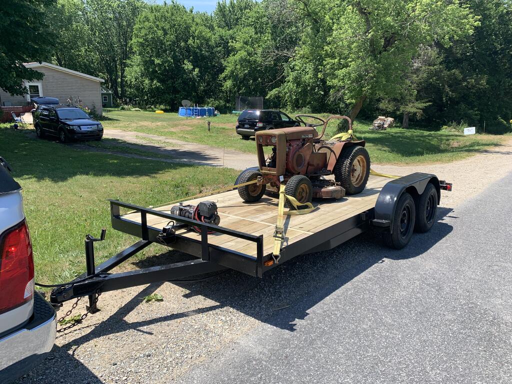

JUSS10 250 #17 Posted June 20, 2021 Well went and picked up the 953 I was talking about. Little rougher than I was expecting from the photos, but for $100 and a 30 minute drive, it’s still a no brainer. Going to get the deck off and give it a good pressure washing and see what I’m working with. 2 1 Share this post Link to post Share on other sites

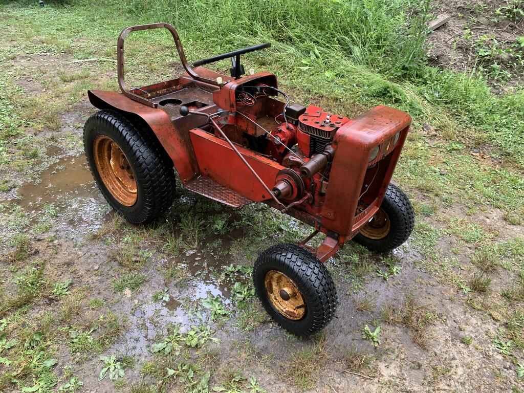

JUSS10 250 #18 Posted June 20, 2021 After a little bath. couple things I noticed. Do all 953s have the Saginaw steering box or just the early ones? This thing has one. Also the headlights are different than my 1054 but they seem correct. Lots of rust in the rear sheet metal. A few parts will need to be cut out abs repatched. Also, like any tractor that’s almost 60 years old, there have been some “modifications”. Always amazed at how folks could just drill holes or cut things up so easily. Anyway, most of the import things are there so this will be a Survivor for sure. guy said the engine didn’t run, and frankly I plan to use the diesel per the point of this thread, but is there a way to identify with big block Kohler it has without the tag on the fan shroud. The paint looks newer on the engine and I’m assuming it’s been replaced. Share this post Link to post Share on other sites
19richie66 17,763 #19 Posted June 21, 2021 Early model 963’s had the Ross steering box and smaller headlights. Looks like a solid tractor for $100. Both of mine had holes cut in the sheetmetal below the seat. Whats the steering wheel look like. Early ones had a triangularish center cap. Share this post Link to post Share on other sites
JUSS10 250 #20 Posted June 21, 2021 so is that square rough cut hole in front of the gas tank from the factory?! This one also has a cut up the inside of the left fender. this one has all the tell tale signs of the early 953 but the steering wheel matches what is on my 1054. Could this be a weird between transition model? Serial number was 63-5XX (forgot the last digits). Share this post Link to post Share on other sites
