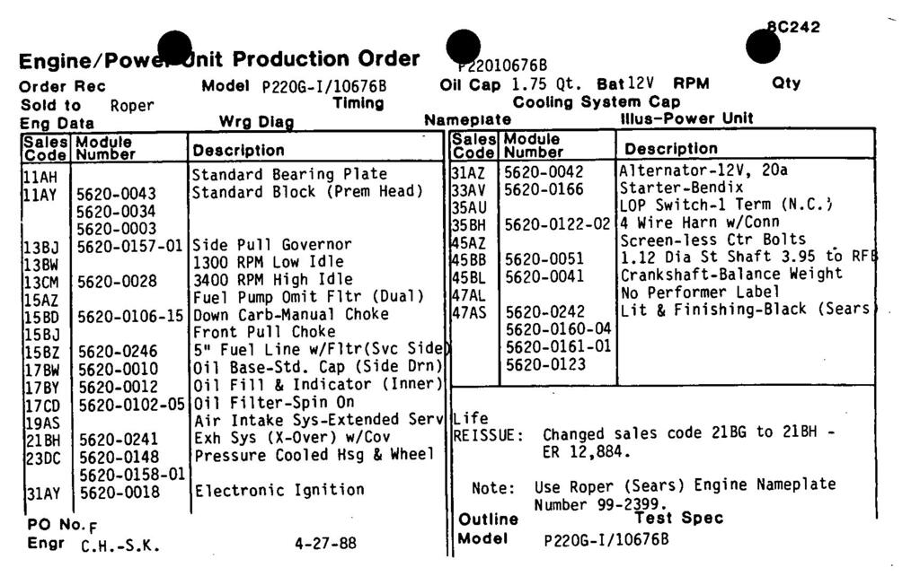

crazy passworD 3 #1 Posted June 15, 2021 I have a 20hp craftsman tractor that i bought in 1990. It has a onan engine,but i cant read the decal about the engine. There is a number stamped in the metal at the top of engine.The number is 3282426 would this give me any info ? And how would i find out. any help would be appreciated crazy passworD 1 Share this post Link to post Share on other sites

onanparts.com 185 #4 Posted June 17, 2021 On 6/14/2021 at 5:11 PM, crazy passworD said: I have a 20hp craftsman tractor that i bought in 1990. It has a onan engine,but i cant read the decal about the engine. There is a number stamped in the metal at the top of engine.The number is 3282426 would this give me any info ? And how would i find out. any help would be appreciated crazy passworD You have an Onan P220G-I/10676B. This is the Onan production order for it. Ignore the dates as they were reissued many times. :) Share this post Link to post Share on other sites
crazy passworD 3 #5 Posted June 18, 2021 onan parts.com THANK you very much.that s exactly what i need Share this post Link to post Share on other sites
