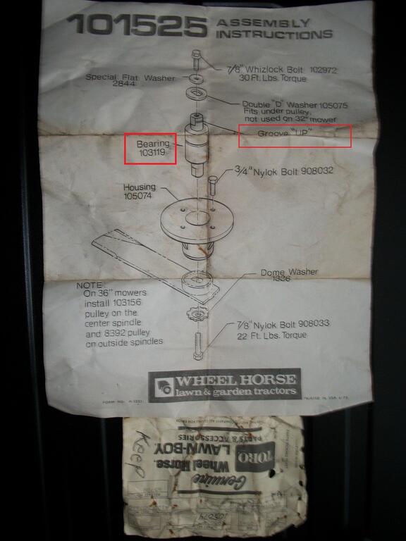

don from mystic 3 #1 Posted June 13, 2021 My '74 C-100 has a 36" mower deck with non-greaseable spindles. I'm replacing one and would like to know if the longer 3/4dia. end goes into the pulley or the blade? Just want to make sure I get it right, didnt realize the ends were different till it went into the part bin. thanks. Share this post Link to post Share on other sites
daveoman1966 3,883 #2 Posted June 13, 2021 fits like this... 2 Share this post Link to post Share on other sites
