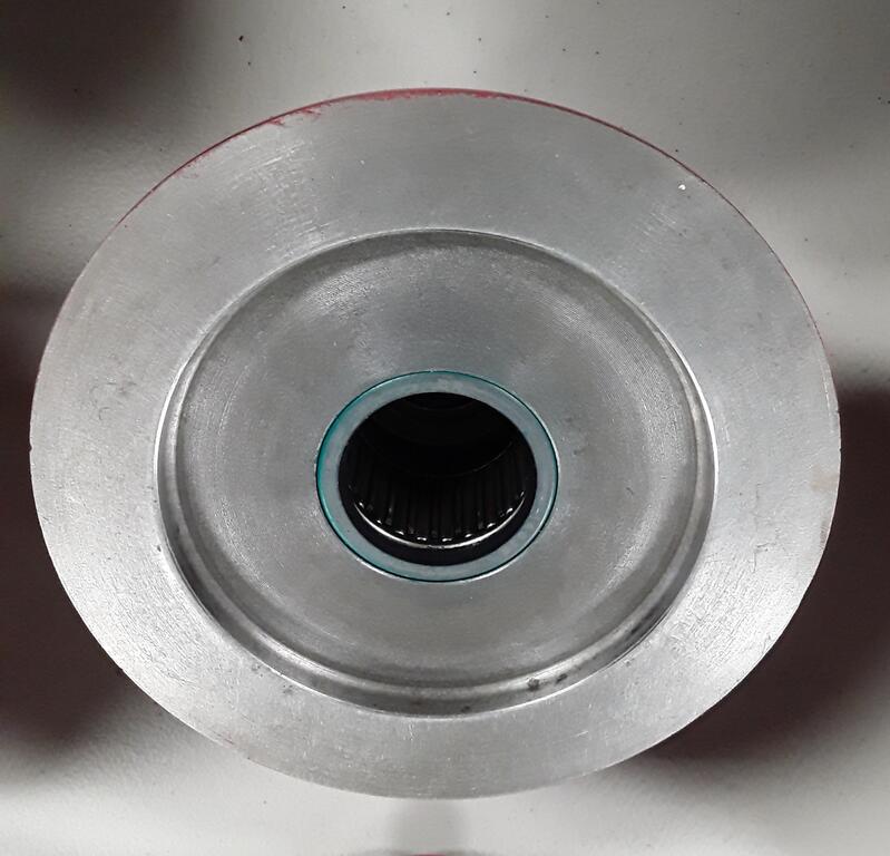

76c12091520h 3,917 #2 Posted June 12, 2021 Clean it good, apply a light coating of a good quality high temp grease to the needle bearing inside the PTO and you can also clean and grease the bearing race on the engine shaft. There should be a seal on the backside of the PTO pulley toward the engine (see the green ring in the photo) . Don't be afraid to clean the clutch mating surface also: de-grease and possibly hit it with some 80-120 grit sandpaper on a sanding block to clean it up and remove some of the glaze that typically builds up. 7 1 Share this post Link to post Share on other sites
