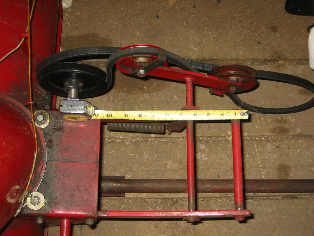

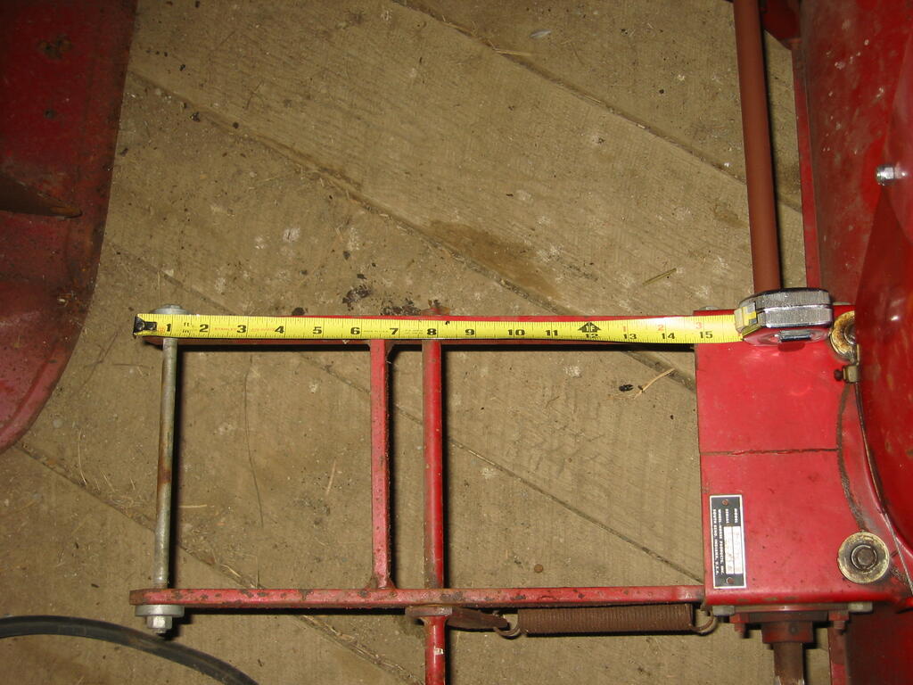

gwest_ca-(File Mod) 11,881 #2 Posted June 11, 2021 The 6-6212 is the basic unit. Is that all there is less the completing kit? You have it figured out. You should be able to drill 5/8" holes and slide a round bar in secured with cotter pins. How much shorter they are I think I can measure. Some of the hitch flat side bars are straight and others are bent I've noticed so the snowthrower sits lower than the tractor frame but do not know why. Garry Share this post Link to post Share on other sites

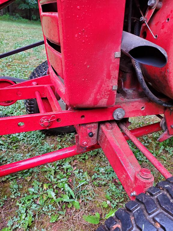

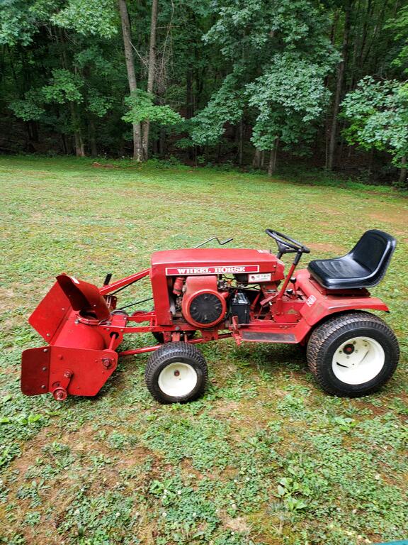

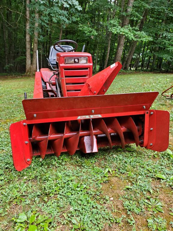

fred1369 3 #5 Posted June 12, 2021 Thank you everyone for the help. I did get a chance to fit the snow thrower today... it works. My C-120 has the drill holes in the frame to work with the existing 6-9112 completing package. I don't know if the completing package 6-9113 (attaching to the tach-a-matic) makes installing easier. Installing the snow thrower was pretty easy. Here's a few pics... 1 1 Share this post Link to post Share on other sites

fred1369 3 #7 Posted June 12, 2021 The only disadvantage that I can see with the earlier bolt on to frame completing package is, the lift is not as high... the mounting bracket will make contact to the hood if you install the flag on the third hole up. With the Tach-A-Matic completing package, the snow thrower can be lifted higher (in "stow"). Share this post Link to post Share on other sites
