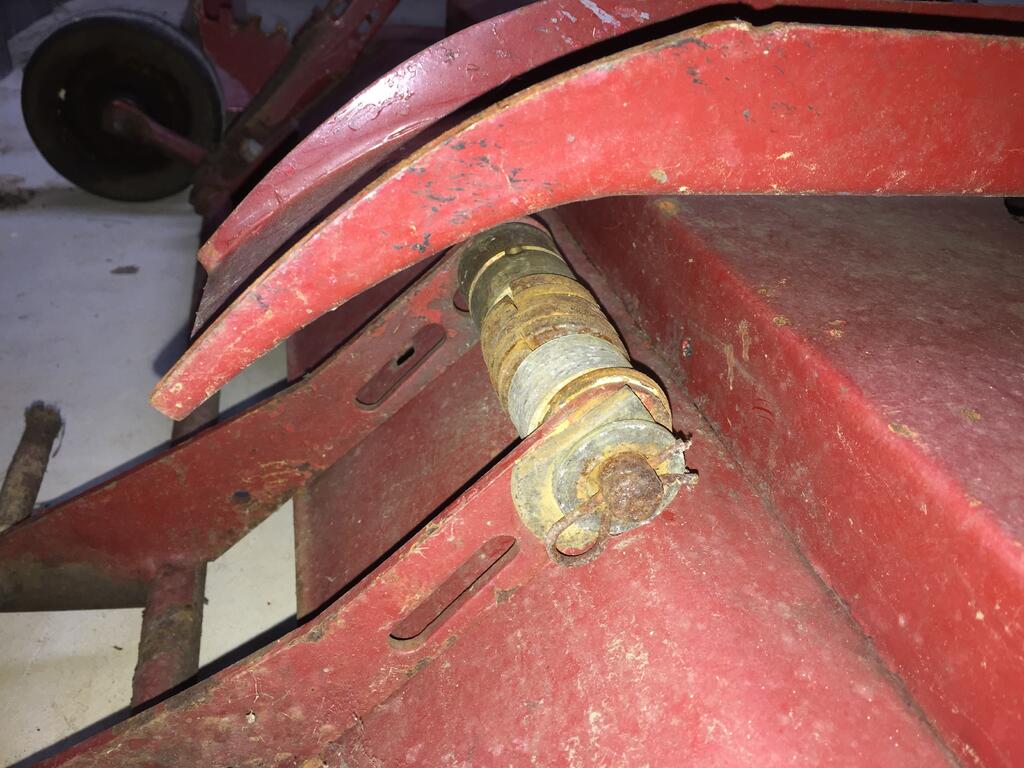

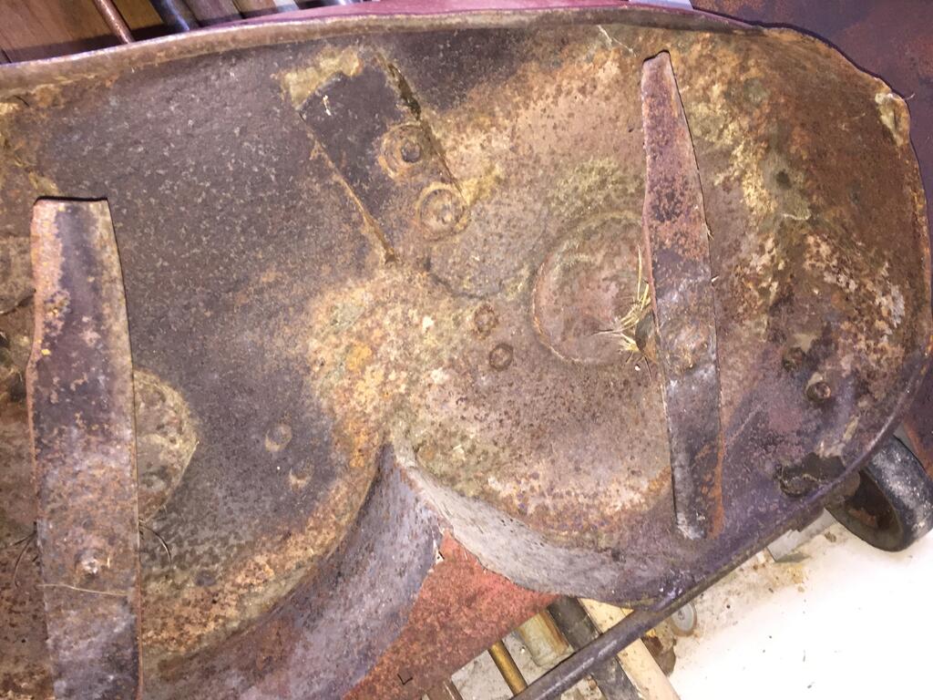

JimSraj 566 #1 Posted June 9, 2021 I recently bought a GT14 with a dozer blade mounted and a mower deck came along with the deal. I’d like to get the deck functioning and mounted. Does anyone know the correct model # and/or have a diagram of the deck for this year? Is it the same as for the 1970? I know I need a rear roller and a lift rod for sure. The center channel is twisted and has a cracked and bent portion near the center of the right side ( from seated on the tractor). I’m gonna try to get the twist out and if successful, repair the cracks. Oh yeah, I’m guessing the stacked lock washers in the second photo are not original equipment. Otherwise may need to source that part too. Exploded diagram would be helpful. Share this post Link to post Share on other sites
daveoman1966 3,882 #2 Posted June 9, 2021 (edited) I looked at all the 48" decks for the GT-14 and the schematics look identical. Go tho the TORO PARTS MASTER website https://lookup3.toro.com/partdex/index.cfm?xCaller=Toro Enter GT-14 as the model. Then search on "Attachments & Accessories". Here is 48" deck model 5-1200 Edited June 9, 2021 by daveoman1966 1 Share this post Link to post Share on other sites
