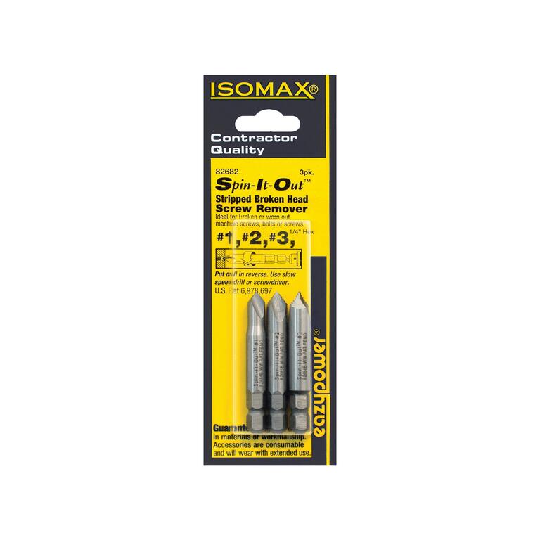

Crazyredhorse 296 #4 Posted June 8, 2021 (edited) if you have access to a welder maybe tack a bolt to them?I've used these before with luck.but you would need to get some kinda hole started.maybe dremel with a good tip.if its aluminum plate heating real good should loosen it up. Edited June 8, 2021 by Crazyredhorse Share this post Link to post Share on other sites
