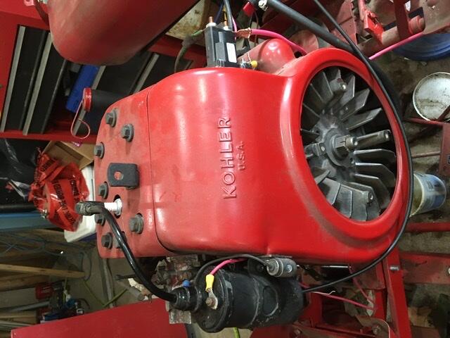

AHS 1,594 #5 Posted June 7, 2021 The Kohler has a solid stater ignition, it has a 12v coil and a solenoid on the tractor. I’m sorry, this should be in electrical, moderators. 1 Share this post Link to post Share on other sites

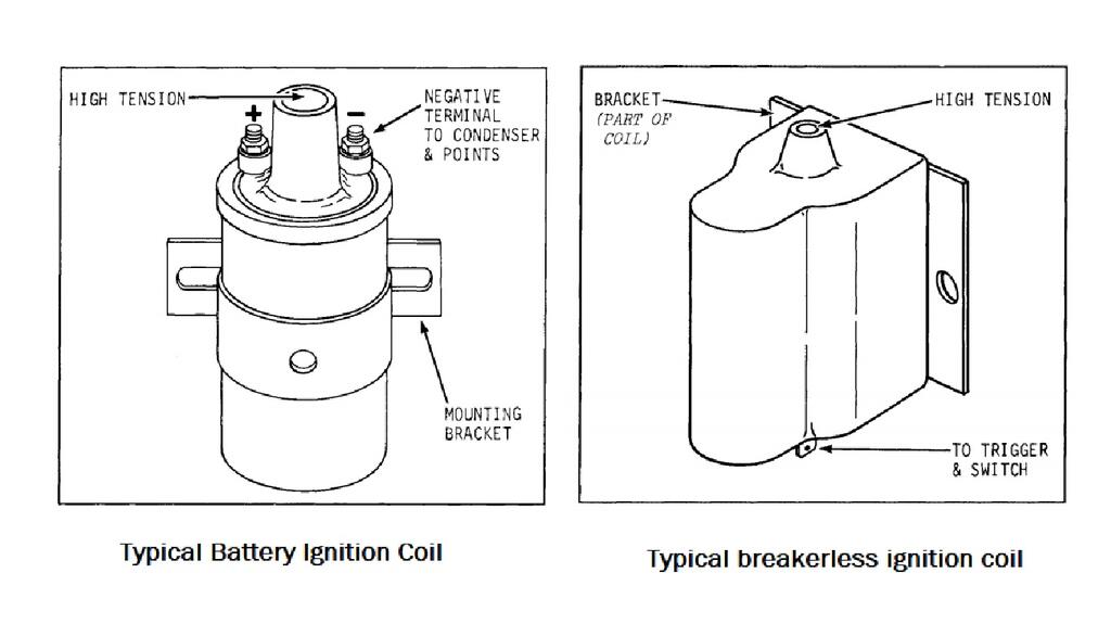

953 nut 64,087 #7 Posted June 7, 2021 1 hour ago, AHS said: Kohler has a solid stater ignition, it has a 12v coil Pick one from this picture. 3 Share this post Link to post Share on other sites
AHS 1,594 #8 Posted June 8, 2021 Sorry bout that! I added the solenoid because it had solenoid/key switch! Just a regular old Kohler! Share this post Link to post Share on other sites
gwest_ca-(File Mod) 11,995 #9 Posted June 10, 2021 The C-111 uses a battery type of ignition switch to control a kill relay to control the B&S magneto ignition. The Kohler with round coil is battery ignition so the C-111 ignition switch will work. You need to eliminate the kill relay and extend the ignition wire to the coil (+) terminal on the round coil. This is how the Kohler should be wired to the coil Garry Share this post Link to post Share on other sites
