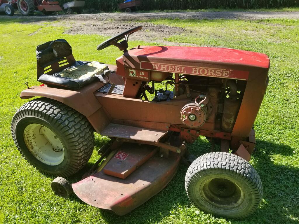

bellevillerod 835 #1 Posted June 5, 2021 Hey guys, I just saved another piece of old Iron from the scrap heap. A guy that works at my shop bought a small hobby farm from a deceased family member. He tried to use the tractor but broke a belt, so he parked it and went to Home Depot and bought a new unit. Got a call and was asked if I wanted it.....as my truck was being started I got the address. I have to say the OP must have cared for this tractor and maintained it well. Their are the normal things that go bad but it sure is in great shape for a 73. Having a hard time finding the belt sizes for it though. Sure one of you know offhand what they are. Need the belt for the 48in deck and for the drive unit. Thanks guys 1 5 1 6 Share this post Link to post Share on other sites
gwest_ca-(File Mod) 11,513 #2 Posted June 5, 2021 Click on the picture in the link. Drive belt is on the page that comes up. May not be the deck you have but the belts will be the same. Click on the fuzzy picture Garry 1 Share this post Link to post Share on other sites

Ed Kennell 42,130 #4 Posted June 6, 2021 Wow, your lucky day. Great looking tractor. 3 Share this post Link to post Share on other sites
paxz71usa 173 #5 Posted June 6, 2021 I have a '73 12 automatic and it is a fantastic machine. I think you'll really like this tractor! Gary 1 Share this post Link to post Share on other sites
1973Auto 80 #6 Posted June 6, 2021 I have a 12 hp 73. Got it with the electric pto. Great machine. Nice find 1 Share this post Link to post Share on other sites
8ntruck 7,877 #7 Posted June 6, 2021 Good find. I think you will like it. I've got a '73 14hp gear jammer. It has done everything I've asked it to do. 1 Share this post Link to post Share on other sites
bellevillerod 835 #8 Posted June 6, 2021 5 hours ago, gwest_ca said: Click on the picture in the link. Drive belt is on the page that comes up. May not be the deck you have but the belts will be the same. Click on the fuzzy picture Garry Wow lol I downloaded that file before posting and read it through....belt size is on the first page...DUH thanks 1 1 Share this post Link to post Share on other sites
bellevillerod 835 #9 Posted June 6, 2021 1 hour ago, 8ntruck said: Good find. I think you will like it. I've got a '73 14hp gear jammer. It has done everything I've asked it to do. I have a 75 C160 Auto and they are real close to each other. It needs a good tune up, pull head and clean carbon. Looks like there are some air leaks on the #30 carb. Small stuff. It also has the HD engine from what I have read, it has 13 fins on it. Don't know much about those other than you can really open up the bore on those if you wanted to. 2 Share this post Link to post Share on other sites
ebinmaine 72,951 #10 Posted June 6, 2021 6 hours ago, bellevillerod said: I have a 75 C160 Auto and they are real close to each other. It needs a good tune up, pull head and clean carbon. Looks like there are some air leaks on the #30 carb. Small stuff. It also has the HD engine from what I have read, it has 13 fins on it. Don't know much about those other than you can really open up the bore on those if you wanted to. Great save on that one Rod!! Should be a near identical machine to the C-160 other than name. Where are the air leaks on the carb? Likely can be fixed with a proper washer in the top of the bore. Best to rebuild and repair that one, not get new. 12 vs 13 fin for a stock tractor engine isn't a concern. For rebuild and high performance however those 13 fin blocks are desirable to some. I've no real experience with that but have read that a 13 fin can be punched a fair amount which can certainly do interesting things to the power output. Glad to see you floating around here! Looking forward to seeing what you do with that rig. Definitely a "bucket list" tractor for many folks... And you have two!! 1 Share this post Link to post Share on other sites
bellevillerod 835 #11 Posted June 6, 2021 1 hour ago, ebinmaine said: Great save on that one Rod!! Should be a near identical machine to the C-160 other than name. Where are the air leaks on the carb? Likely can be fixed with a proper washer in the top of the bore. Best to rebuild and repair that one, not get new. 12 vs 13 fin for a stock tractor engine isn't a concern. For rebuild and high performance however those 13 fin blocks are desirable to some. I've no real experience with that but have read that a 13 fin can be punched a fair amount which can certainly do interesting things to the power output. Glad to see you floating around here! Looking forward to seeing what you do with that rig. Definitely a "bucket list" tractor for many folks... And you have two!! The shafts have worn the carb body some, you can wiggle the main throttle shaft back an forth. I know you can get a China Carb for next to nothing. but I'd rather install a bushing in an original. Runs really well but has a slight miss here an their. I still have to do the points and set the governor.....Not looking to make a puller so the 13 fin does nothing for me, ya read it has a thicker wall than a 12 fin. Neat to have in the herd. Still floating around been real busy around here, about to finish up the 854. 1 1 Share this post Link to post Share on other sites

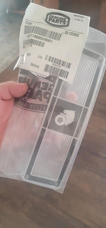

haydendavid380 759 #17 Posted June 6, 2021 8 hours ago, bellevillerod said: Has a neat headlight lens on it. I haven't seen one myself, chrome horse with a black wheel. It's in great shape makes me want to remove it and stash before I go and break it. Wonder when they stopped using that lens and went to the "cheaper" looking lens. They're still available NOS Share this post Link to post Share on other sites

Thor27 835 #19 Posted June 6, 2021 (edited) 4 minutes ago, Thor27 said: That is the newer style. The 3D chrome horse is hard to find. image is not mine, found on net... Edited June 6, 2021 by Thor27 3 Share this post Link to post Share on other sites
