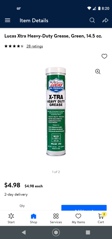

peter lena 9,471 #3 Posted June 4, 2021 @rmarnard, if you use a polyurea based grease like the lucas extra heavy duty , with anti sling additives , available at wallmart for $5 , it will stay with the gear unit . this grease retracts on itself after use , insuring its gear protection . use in all my bearing areas , with no noise or bearing failures. just slapping on any grease will make a mess , as it has no anti sling additives . also a 560 drop point just my own experience , pete 3 2 Share this post Link to post Share on other sites
rmaynard 16,591 #4 Posted June 4, 2021 Is this what you are recommending? 1 Share this post Link to post Share on other sites

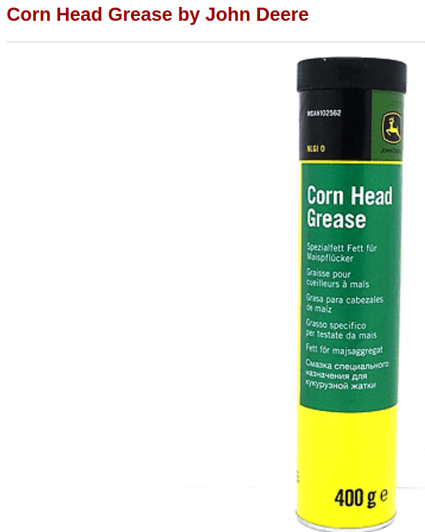

peter lena 9,471 #11 Posted June 4, 2021 @RMARNARD, yes that is the stuff, since converting over to it on all my bearing , and lubrication areas , its been bombproof . it stays with just about anything , its got a similar rating to the john deere polyurea grease above , that polyurea rating is terrific. when I do over my bearings , simply pop off the side rubber shields , carefully wipe out existing grease , and refill with the hi temp. no whining bearing noise just solid quiet bearing performance , no failures since change over , pete 2 Share this post Link to post Share on other sites
