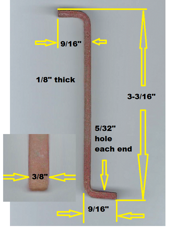

Chrishar 974 #1 Posted June 3, 2021 Trying to make the bracket that go from the hood stand to the plastic dash on a 701 a picture of it and the measurements of the bracket any help on this thanks it been a three year project it was in bad shape and missing parts when i bought it but I'm almost done with it still looking for parts for the motor but it runs for right now this has been the heards one to find parts for pard to my other wheel horse tractor i have thanks for the help y'all have help me on this 701 wheel horse so far i can see the light at the end of the tanal on this project 6 Share this post Link to post Share on other sites
Achto 30,967 #2 Posted June 3, 2021 (edited) The bracket is fairly simple. A flat piece of steel about 3/8" wide by 1/8" thick with a 90 degree bend at each end (one bend down, one bend up). You could measure from the hood stand to the dash to obtain the length. I will try my best to get you an exact measurement after work today, unless someone beats me to it. Edited June 3, 2021 by Achto Share this post Link to post Share on other sites
rmaynard 16,860 #3 Posted June 3, 2021 Here you go. 3 1 Share this post Link to post Share on other sites
