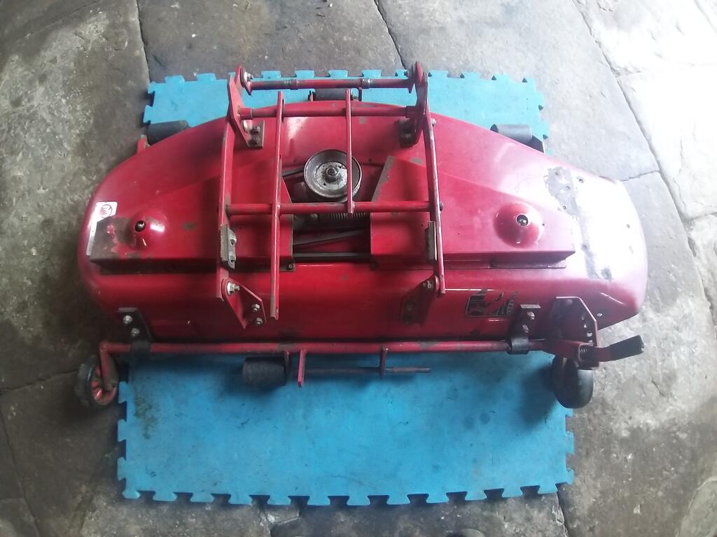

Bertie 314 #1 Posted June 2, 2021 (edited) This is my 42" side discharge deck off the 416-8. The serial number is missing and want to set it up properly re cutting etc, I presume the steel bar is something to adjust so want to download the correct manual any idea guys.. Edited June 2, 2021 by Bertie Share this post Link to post Share on other sites

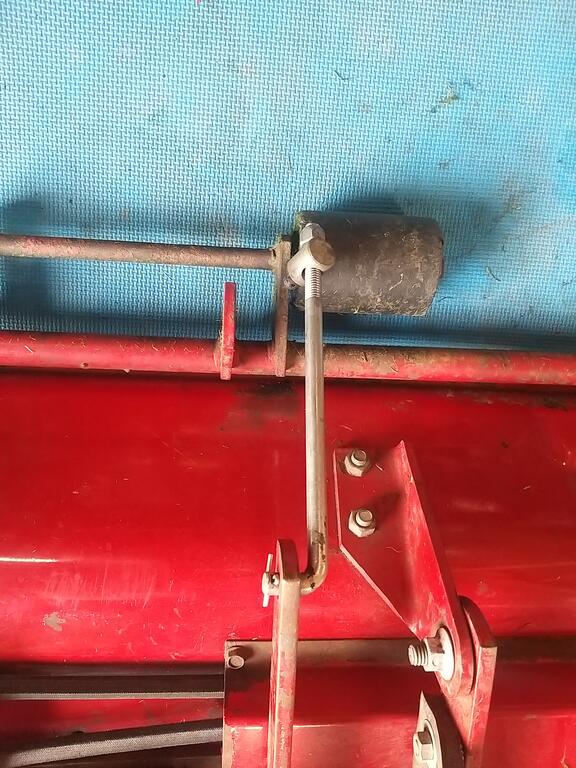

Jeff-C175 7,207 #3 Posted June 2, 2021 (edited) @Bertie That bar is for leveling the deck when it's on the ground. You've got it on backwards though: Basically, you put the deck at the mid position on the height adjustment, with the deck on a flat surface you measure the front and back of the blade from the floor. Adjust the nut on the bar so that the front tip of the blade is just slightly higher, maybe 3 mm or so, than the rear. There is a 'manuals' section here that you can certainly find the manual for your deck with more explanation. Edited June 2, 2021 by Jeff-C175 1 Share this post Link to post Share on other sites

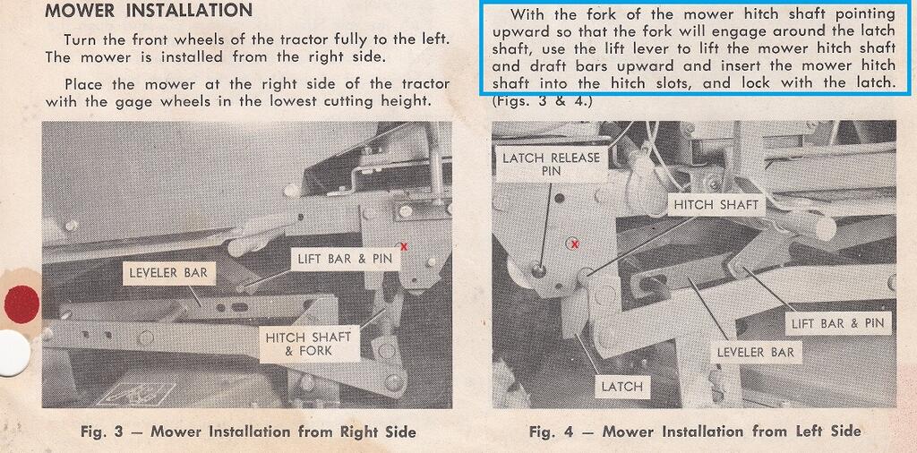

daveoman1966 3,881 #5 Posted June 2, 2021 Be sure to mount the deck correctly. Here are a few pics. 1 Share this post Link to post Share on other sites
