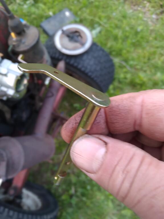

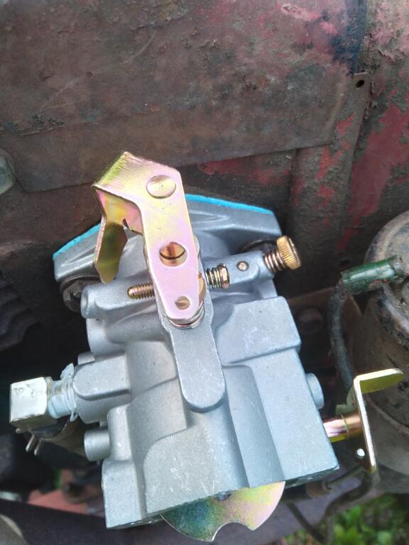

steader 26 #1 Posted June 1, 2021 I put a new carb in the B 100 and there is no ball on the throttle linkage ?? I was so close!! What do I do?? Share this post Link to post Share on other sites
roadapples 6,987 #2 Posted June 2, 2021 I'd use a small screw with the head about the same size as the ball and a nut above and below your linkage... 2 Share this post Link to post Share on other sites

Bill D 2,598 #10 Posted June 2, 2021 3 hours ago, steader said: I put a new carb in the B 100 and there is no ball on the throttle linkage ?? I was so close!! What do I do?? My local hardware store has a selection of ball joint rod ends. They have one with 10-32 threads. Check your local hardware store. Bill 2 Share this post Link to post Share on other sites
pacer 3,179 #11 Posted June 2, 2021 Apparently that is the shaft from the new carb you have in your hand?? If so just take the shaft out of your other carb and put it in the new one. I have to switch out the choke shaft on bout all the import carbs. 3 Share this post Link to post Share on other sites
ebinmaine 77,346 #12 Posted June 2, 2021 41 minutes ago, pacer said: Apparently that is the shaft from the new carb you have in your hand?? If so just take the shaft out of your other carb and put it in the new one. I have to switch out the choke shaft on bout all the import carbs. That's a great idea but it didn't work on the one I bought for the c-160 a couple years ago. I can't remember which way was which but the shaft diameter was just a hair off size. Share this post Link to post Share on other sites
Howie 900 #13 Posted June 3, 2021 What he is holding is a choke shaft I think. Share this post Link to post Share on other sites
pacer 3,179 #14 Posted June 3, 2021 21 minutes ago, Howie said: What he is holding is a choke shaft I think. You are so right!! Another look and its plainly the choke shaft!! Share this post Link to post Share on other sites
