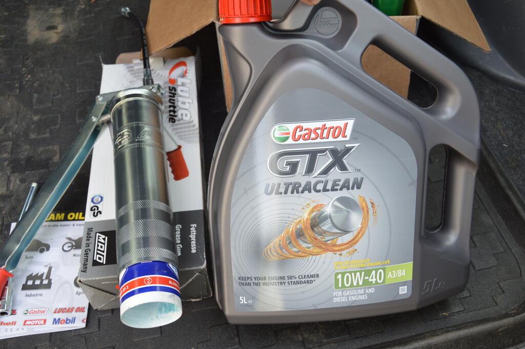

Maxwell-8 4,367 #3 Posted May 28, 2021 (edited) Got me some Castrol 10w40 synthetic. Has mineral oil in it now I guess (but very clean!). Once I get mine running, after the first couple hours I will change mine again. Edited May 28, 2021 by Maxwell-8 2 Share this post Link to post Share on other sites
