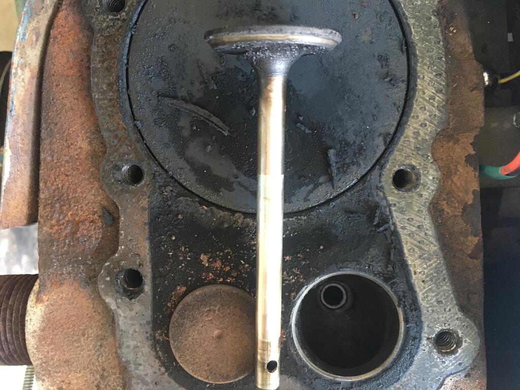

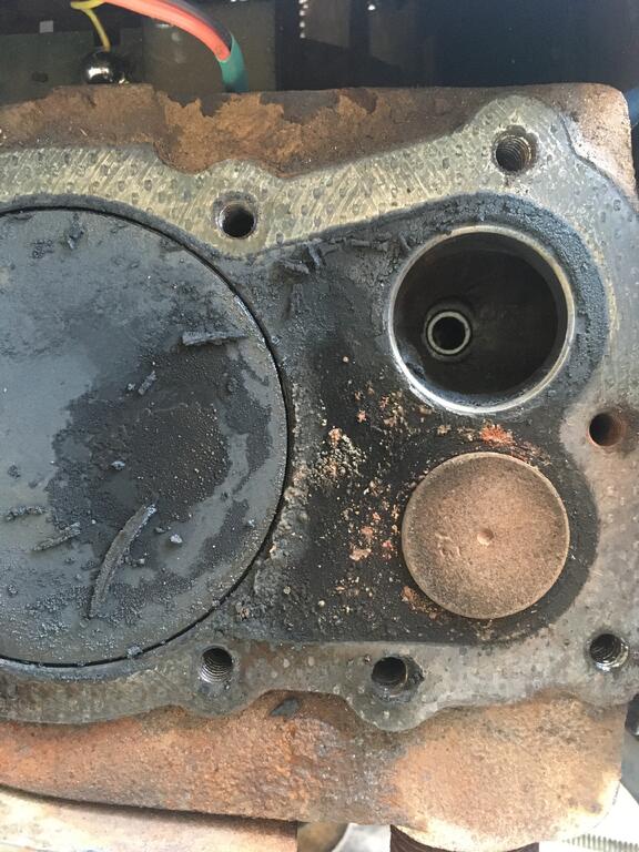

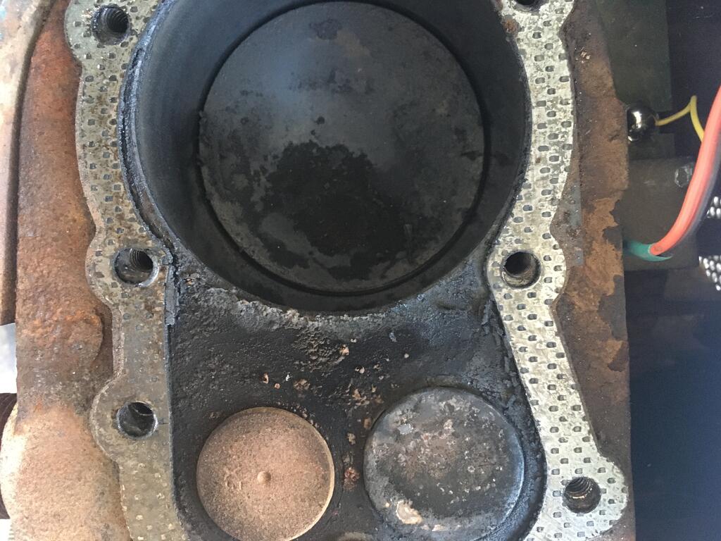

Anthony P 5 #20 Posted August 20, 2021 (edited) Here we GO! OK, I pulled the head. Carbon build up, but nothing really glaring...UNTIL... The intake valve lifted right out of the sleeve...that ain't right is it? Edited August 20, 2021 by Anthony P Add pictures Share this post Link to post Share on other sites
Gregor 4,847 #21 Posted August 20, 2021 Looks like you retainer pin either broke, or came out. I would hope for broke. If it simply came out, then you have to figure out why. Unless this is a common occurrence on the HH120 1 Share this post Link to post Share on other sites

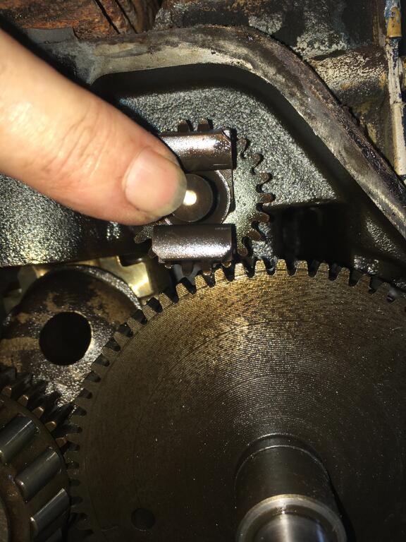

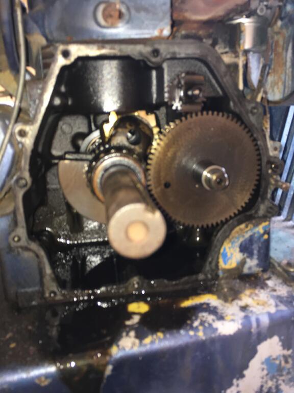

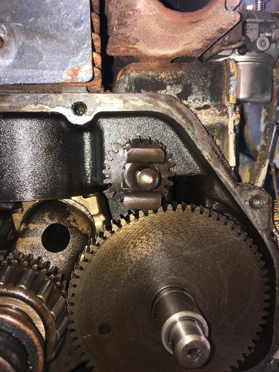

Anthony P 5 #22 Posted August 20, 2021 Busted open the crankcase...nothing seems wrong. No pieces parts in the bottom. Oil looks good... Now I need to know about match marks before I go any further AND to understand what I'm looking at. The little gear up in the right-hand corner does not seem to be attached to anything (held in place by the crankcase cover?) and will easily pull out. What is it? Do I need to put in some match marks before I pull it out for proper timing when I put it back together? Share this post Link to post Share on other sites

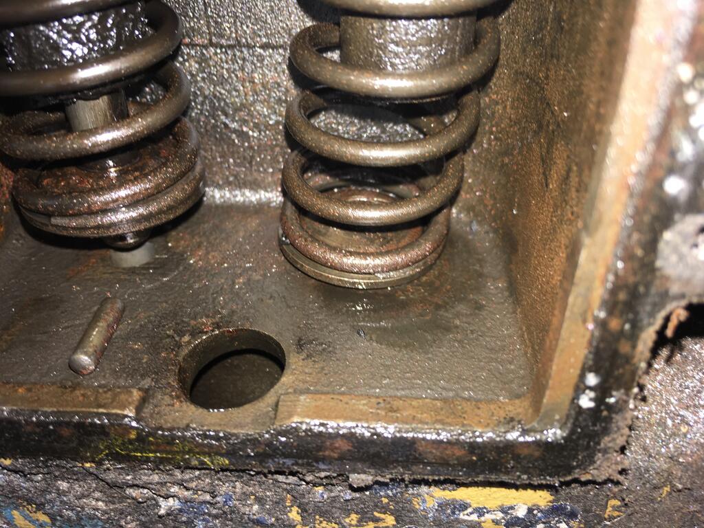

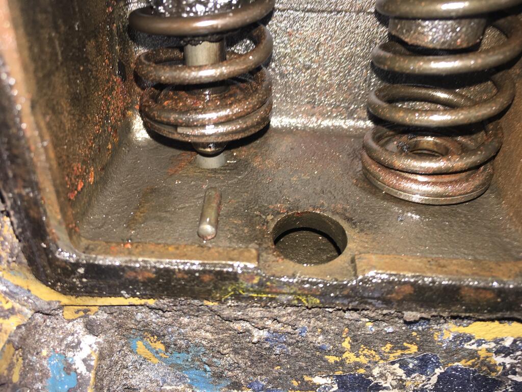

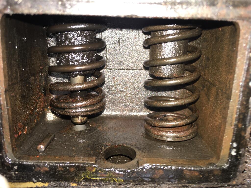

Anthony P 5 #23 Posted August 20, 2021 1 hour ago, Gregor said: Looks like you retainer pin either broke, or came out. I would hope for broke. If it simply came out, then you have to figure out why. Unless this is a common occurrence on the HH120 Do I have to take it completely apart to replace the retainer pin? Share this post Link to post Share on other sites
Anthony P 5 #24 Posted August 20, 2021 56 minutes ago, Anthony P said: Do I have to take it completely apart to replace the retainer pin? Pulled the valve cover and answered my own question...shoulda started there... 1 Share this post Link to post Share on other sites
Anthony P 5 #25 Posted August 20, 2021 Mystery solved!!! I know WHAT BROKE! Now wish I had started with the valve cover... Still need to know how to fix it and get it back together though... Share this post Link to post Share on other sites
