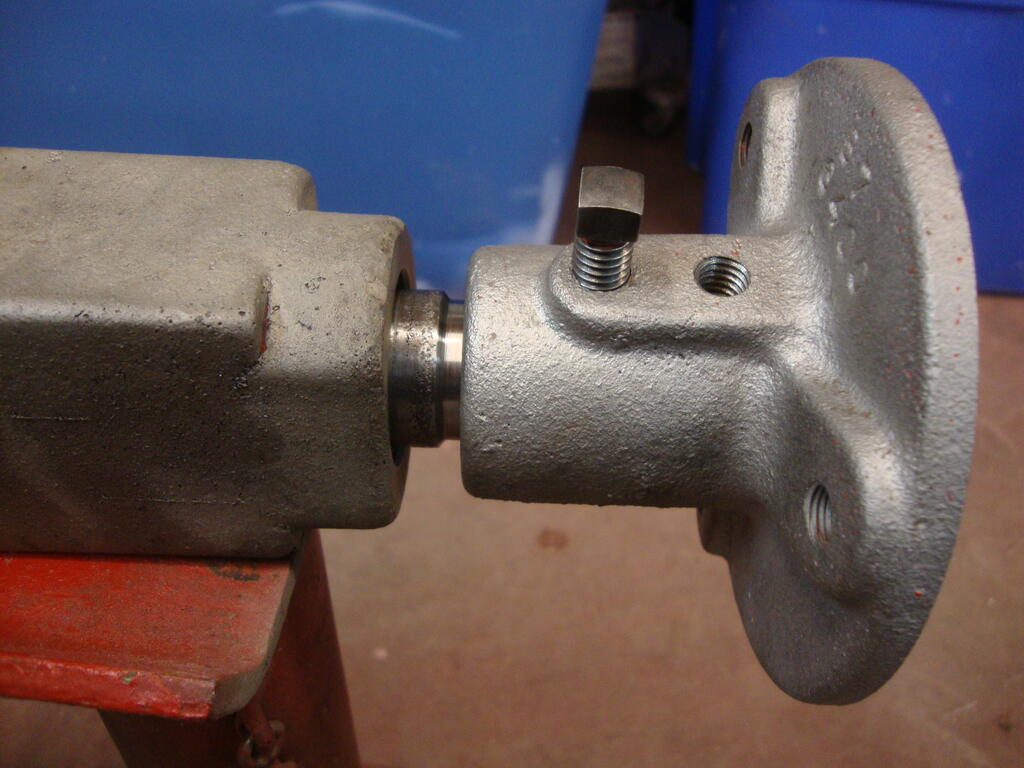

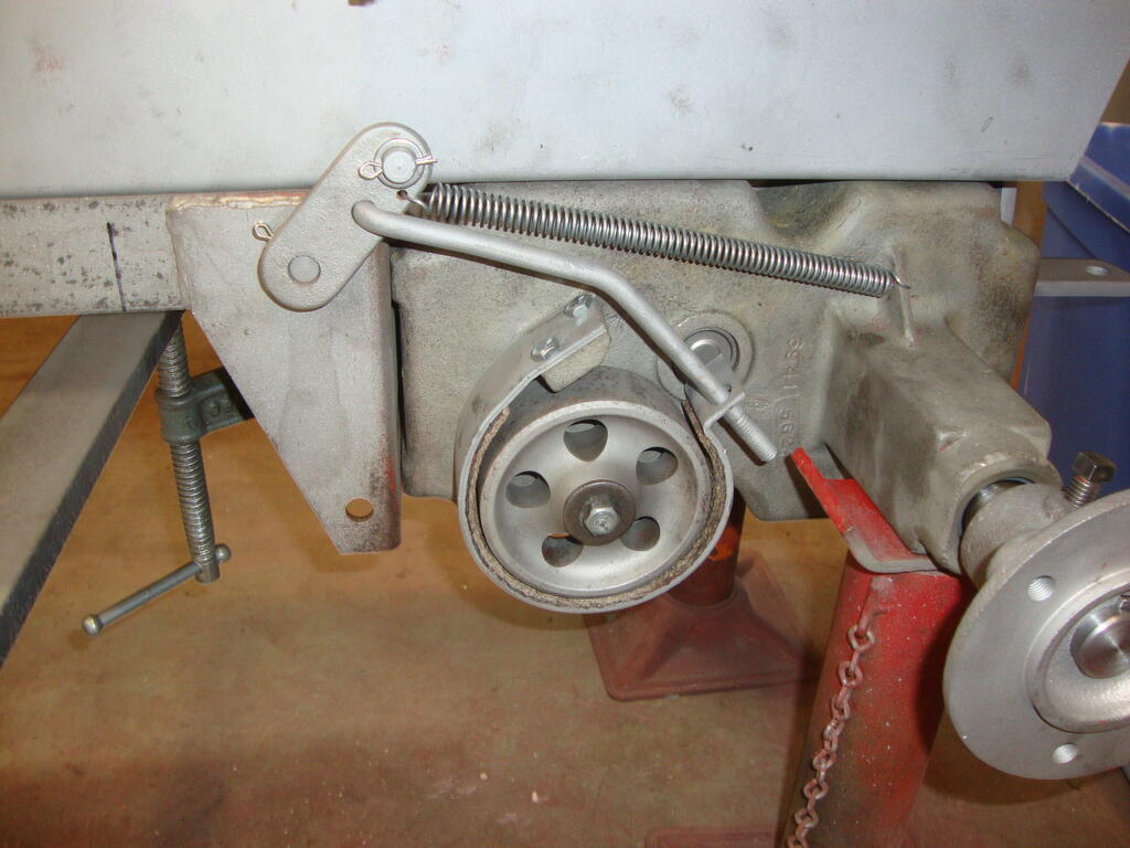

dclarke 4,113 #10 Posted May 26, 2021 I have an 8 speed in my Ranger, I had the 1-1/8" axles turned down and used the Ranger hubs. Here's a pic of the brake rod setup I used with the 8 speed. 2 Share this post Link to post Share on other sites
kpinnc 16,691 #11 Posted May 26, 2021 2 hours ago, dclarke said: I have an 8 speed in my Ranger, I had the 1-1/8" axles turned down and used the Ranger hubs. Here's a pic of the brake rod setup I used with the 8 speed. Nice! That's one way to do it! 1 Share this post Link to post Share on other sites
