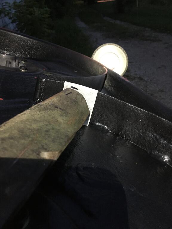

PbFlinger 107 #56 Posted June 28, 2021 So, I went to work with the press, some V-blocks, and a dial indicator. I wasn’t too optimistic, but what’s to lose? Amazingly, after an afternoon of inventing new words I got them pretty good. Within about .003 on the worst one. Proof’s in the pudding, these pics are of the worst of the two. The vertical disparity between tips on this one is now about 1/16”, the other pretty much dead on. For clarity this is a piece of tape on the deck wall with a reference mark, each blade tip aligned with it in turn. Share this post Link to post Share on other sites

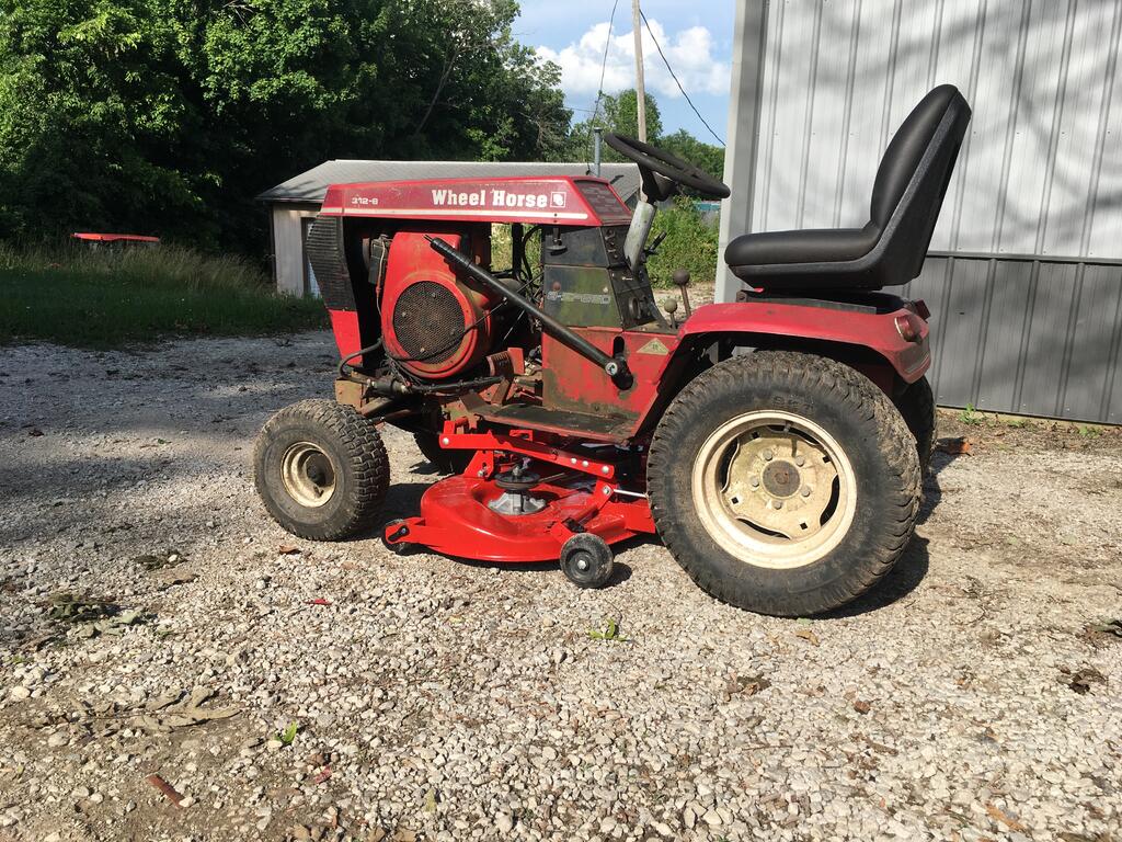

PbFlinger 107 #60 Posted June 28, 2021 Mounted on the now even sadder looking tractor. 1 Share this post Link to post Share on other sites
PbFlinger 107 #61 Posted June 28, 2021 I know the book says to level it in the middle height selector hole, but we only ever run it in the highest position so that’s where I’m going to set it up. Plus it’s easier to get under like that, Ha. Share this post Link to post Share on other sites

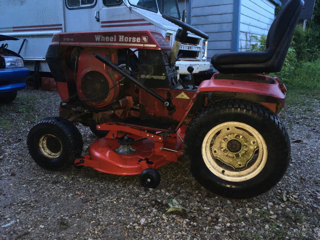

PbFlinger 107 #62 Posted June 28, 2021 Well this just doesn’t look right to me. I haven’t tried to level it yet. This is in the mow position, height selector set at highest setting. Front gauge wheels are 3” off of the ground. I’m going to get in the tractor manual & see if the deck lift assy is rigged correctly. Looks to me like it’s not dropping the deck far enough. Any suggestions appreciated. Share this post Link to post Share on other sites

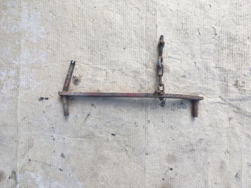

PbFlinger 107 #63 Posted June 28, 2021 Here’s part of it. Deck lift arm. Evidently at some point somebody was driving it around with no deck on it and the lift arm down, ran into something with the arm and bent the hinge been pretty bad. This was causing the top of it above the hinge pin to hit the structure above, and not letting the arm drop all of the way. Share this post Link to post Share on other sites

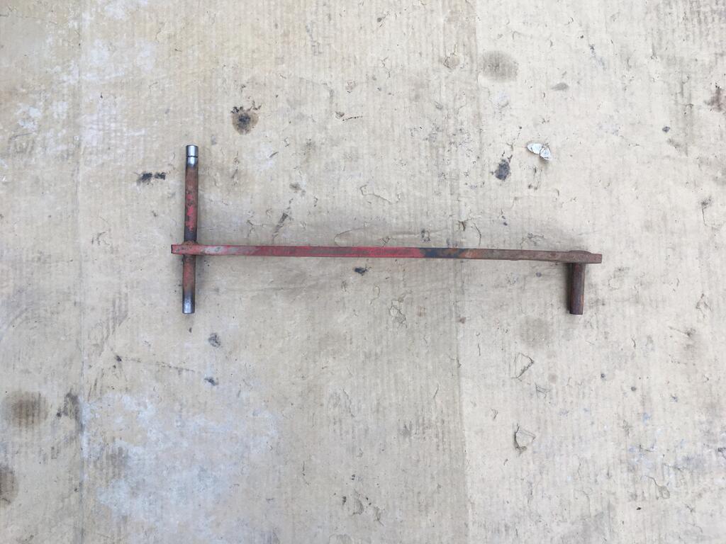

PbFlinger 107 #64 Posted June 28, 2021 Mucho bettero. I clamped it down to a steel table in my shop & went after it with a piece of pipe. Share this post Link to post Share on other sites
Tuneup 1,459 #65 Posted June 28, 2021 Looks good to me, though I'm not experienced with the later decks. Odd for me to see anti-scalp style gauge wheels. Are they standard? Used to grease zerks and good rubber with tread. The fronts are always anti-scalp and normally not near the ground. Looks fine to me and you'll be more confident when you have the time to level it. Share this post Link to post Share on other sites
Jeff-C175 7,211 #66 Posted June 28, 2021 1 hour ago, PbFlinger said: Mucho bettero Y'all got some good skills there! Si Senor, mucho! Share this post Link to post Share on other sites
PbFlinger 107 #67 Posted June 28, 2021 Thanks! Tuneup, as far as configuration goes I’m not sure of anything on this tractor. It was a complete heap when I got it, not running. I got it good enough, and we’ve been mowing with it for about 10 years. Slowly getting it straightened out. Share this post Link to post Share on other sites

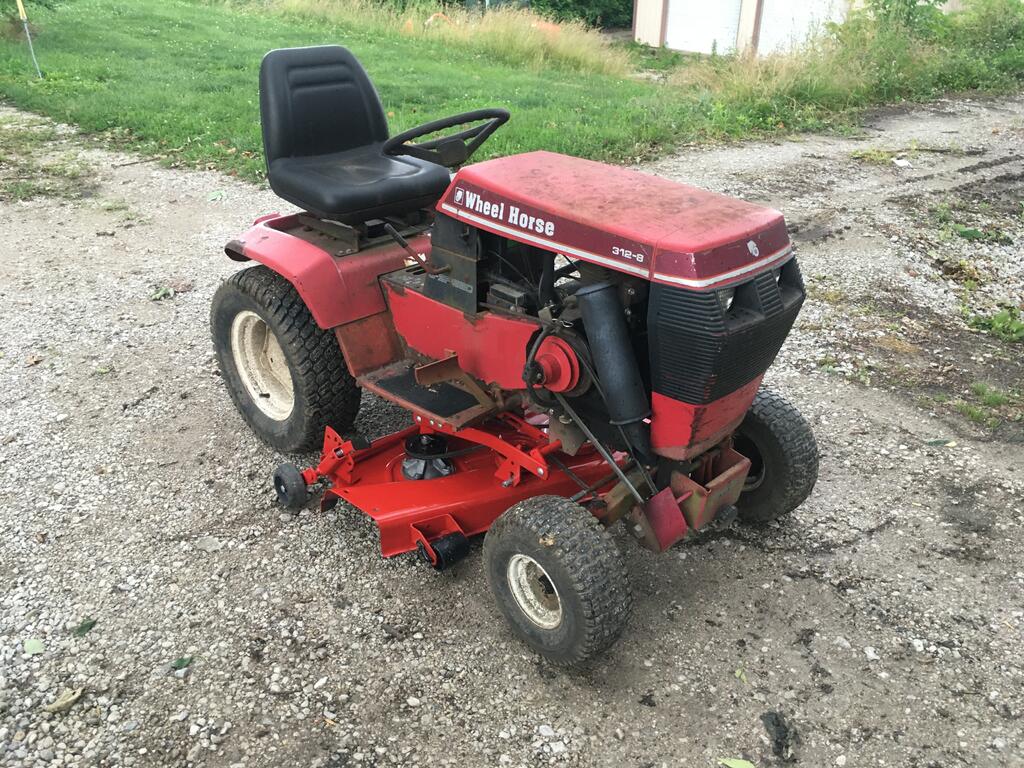

PbFlinger 107 #68 Posted June 28, 2021 This looks much more natural to me now. This is with the height adjuster in the middle position. The rear wheels are on the ground, the anti-scalp wheels are about an inch off of the ground, and notice the front hanger bar that goes into the hitch is now near vertical; it was near horizontal before. Share this post Link to post Share on other sites
PbFlinger 107 #69 Posted June 28, 2021 Puzzling; it mowed ok before, and that lift arm has been bent the whole time. ??? The lift assy was pretty stiff & sticky, so I lubed it all up. Maybe it was just a combination of things. Share this post Link to post Share on other sites
