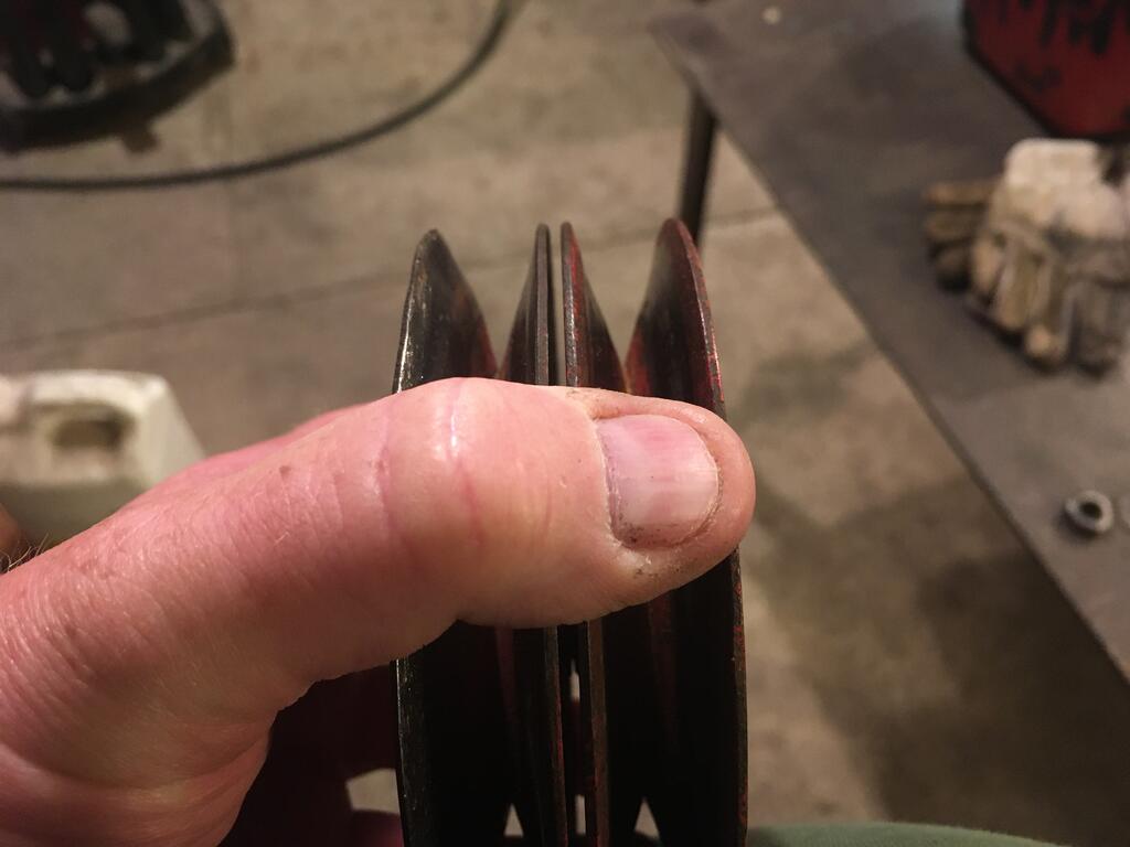

PbFlinger 66 #26 Posted June 1, 2021 I tried to straighten out the spindle drive pulley that got damaged. No joy. Although I was able to get it pretty uniformly opened back up to its original width, looking at it edge on it just wasn’t the same profile. It would probably run, but I’m afraid it would probably wear the belt pretty quickly. It’s partner had been slipping on the spindle shaft, and had some irregular wear on the hub surface. The much harder shaft is ok. If I had to run them I would; but I don’t. New ones on order. Share this post Link to post Share on other sites

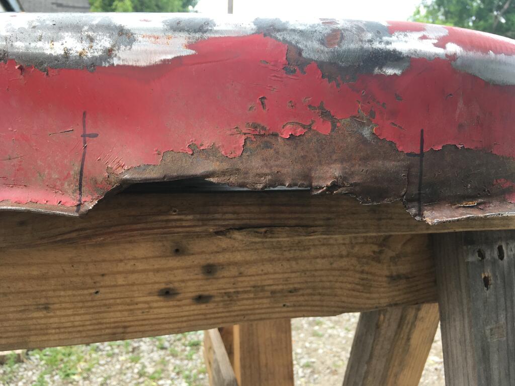

PbFlinger 66 #31 Posted June 6, 2021 Thinking I’ll cut this out. It would probably run like this for years, but I’ll just keep cracking & get worse. Share this post Link to post Share on other sites

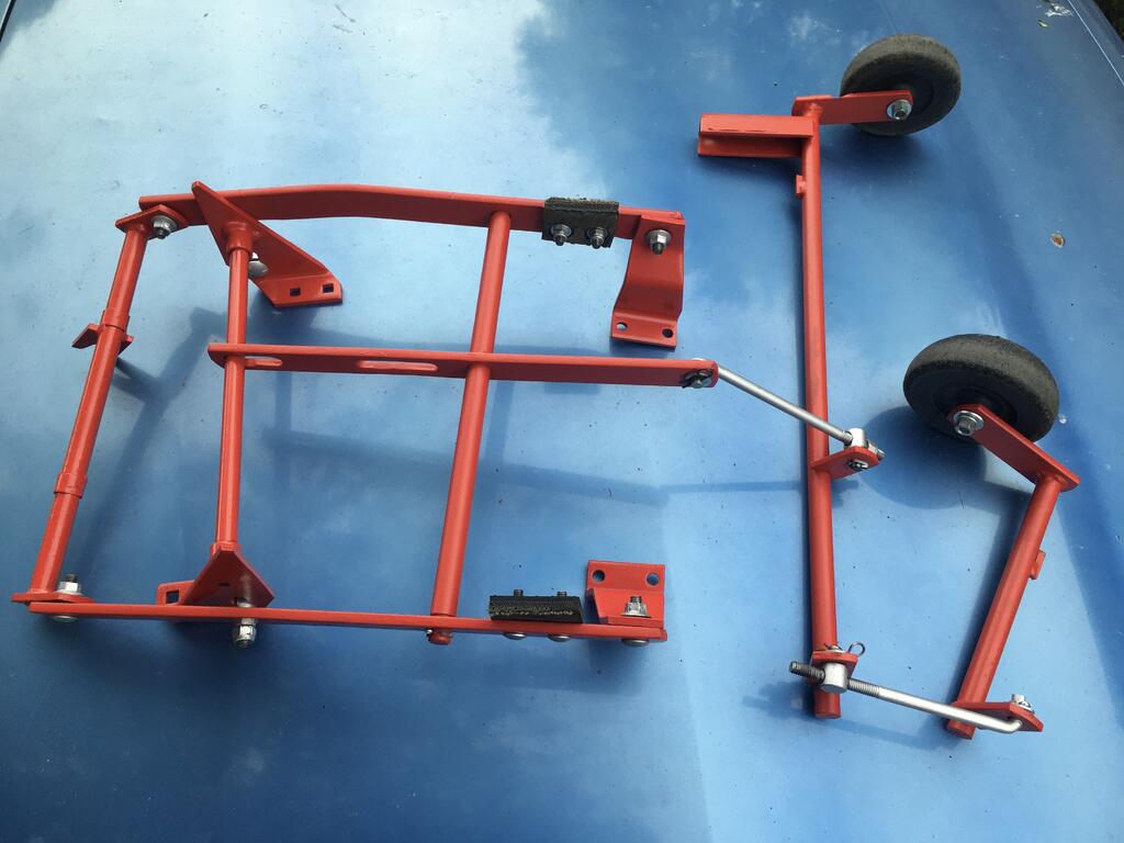

PbFlinger 66 #32 Posted June 7, 2021 Hanger assy done. Looks better. I know I said this isn’t a cosmetic rebuild, but I always get carried away... Share this post Link to post Share on other sites

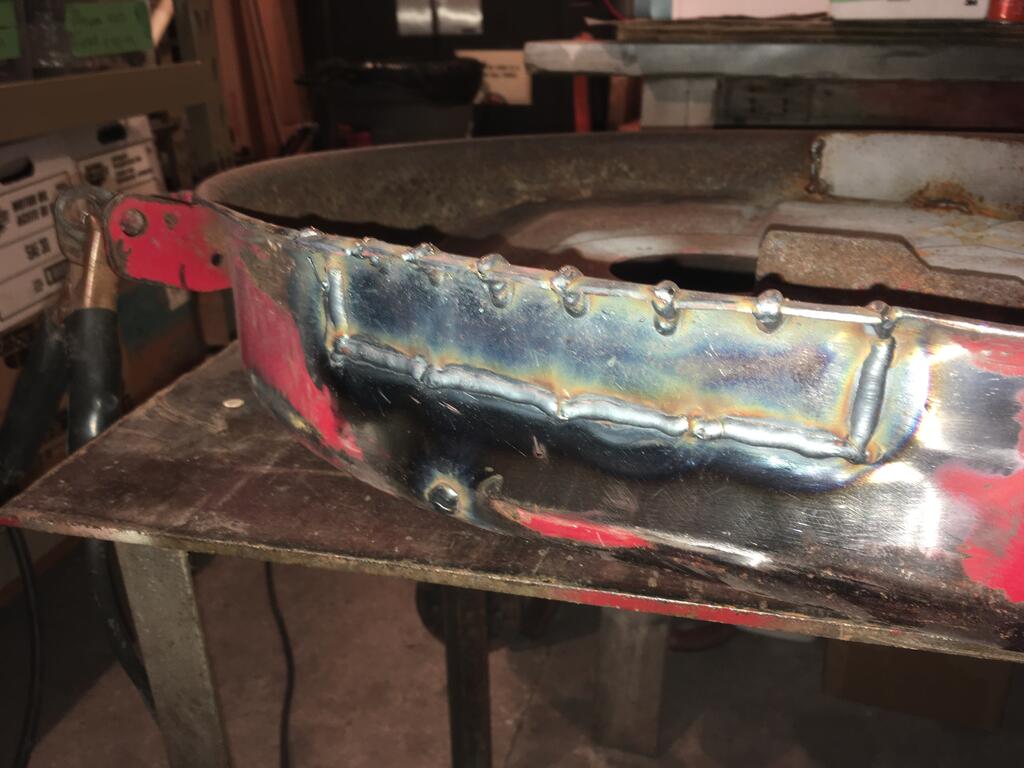

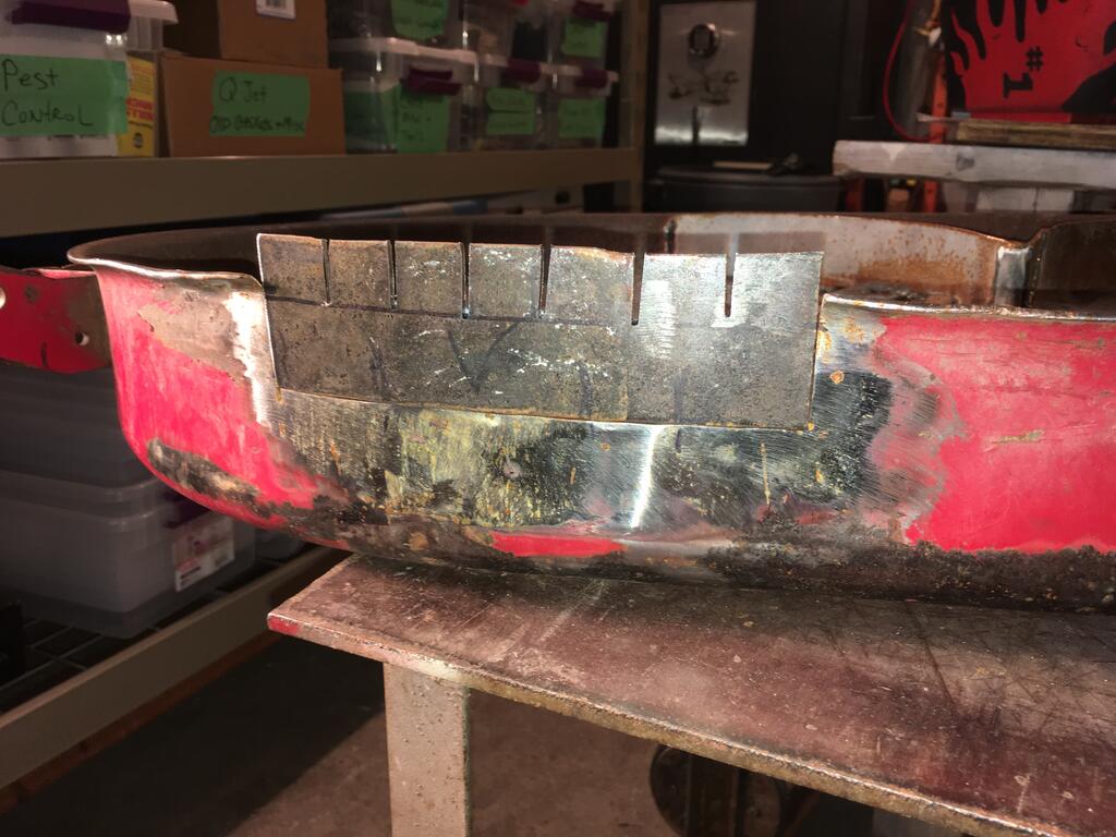

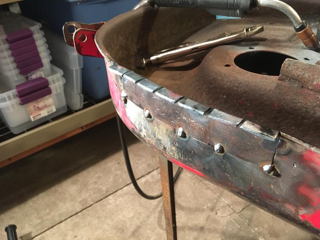

PbFlinger 66 #34 Posted June 13, 2021 Finally got back to working on this. Repair filler fitted. It’s on a compound curve. The front of the deck is curved, and the edge is rolled forward. I elected to bend the filler to match, and segment the top so I can bend it. Share this post Link to post Share on other sites
PbFlinger 66 #35 Posted June 13, 2021 Tacked in & bending tabs. An old Chevy pushrod is about the right radius. Clamped it in there a piece at a time, heated the tabs with oxy acetylene torch, and hammered over. Share this post Link to post Share on other sites
PbFlinger 66 #36 Posted June 13, 2021 Came out decent. Share this post Link to post Share on other sites

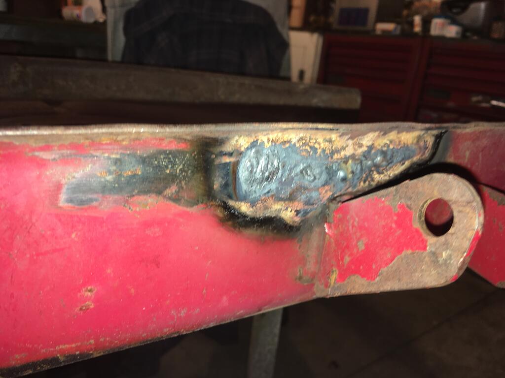

PbFlinger 66 #37 Posted June 13, 2021 Full welded & ready to finish. It should be evident to the most casual observer that I’m not a professional welder. Thank god for grinders. Oh well, it ain’t falling out. Share this post Link to post Share on other sites

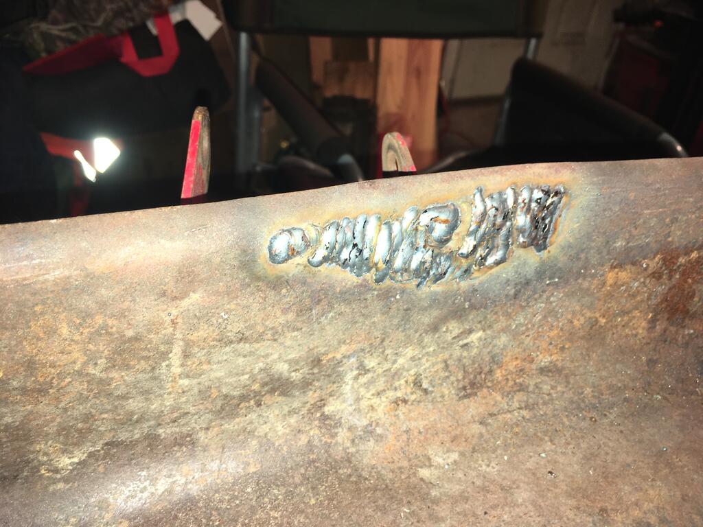

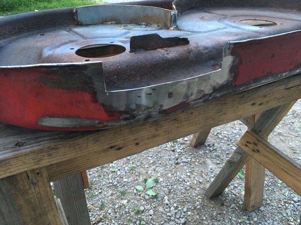

PbFlinger 66 #38 Posted June 13, 2021 The deck edge in front of the other blade was bent in from impacts, and completely eaten through by the blade. To properly repair it, I would have to cut off the roller bracket, and do a similar repair. Due to the complexity of this, and the scope of the job, I elected to just weld it all up and grind it down. Not too elegant, but it’s a working mower deck and not Kindig job. Flame on, ha. 2 Share this post Link to post Share on other sites

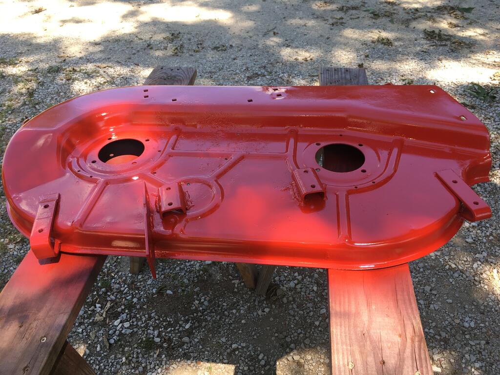

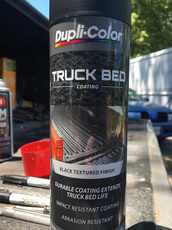

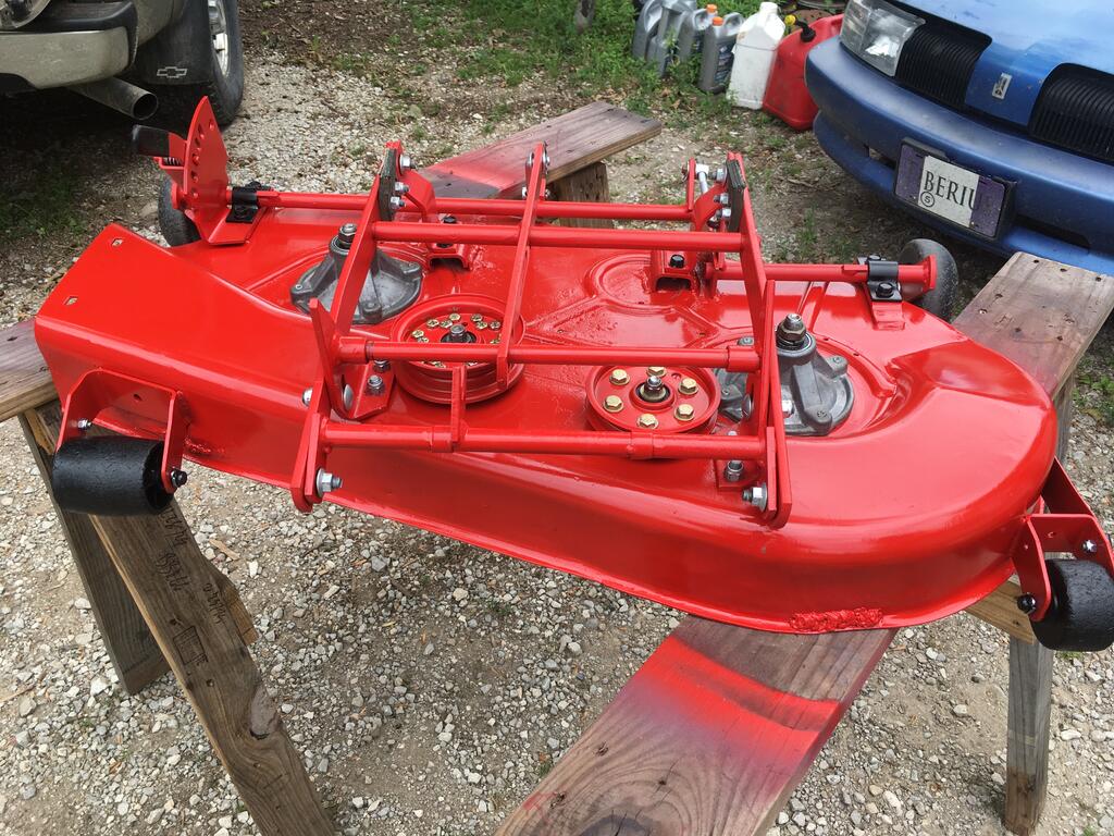

PbFlinger 66 #44 Posted June 22, 2021 I did the bottom with Dupli-Color TR-250 truck bedliner. Looks fabulous, nice and slick. I fully expect it to blow off right away, but I’ve been surprised before. $25 experiment. Probably better than paint- we’ll see. 1 Share this post Link to post Share on other sites
PbFlinger 66 #45 Posted June 22, 2021 I have stumbled upon a method to precisely match the elusive Wheel Horse red. It’s incredible; it’s exactly the color of my deck. 1 1 Share this post Link to post Share on other sites
PbFlinger 66 #46 Posted June 22, 2021 Looks acceptable to me. Share this post Link to post Share on other sites

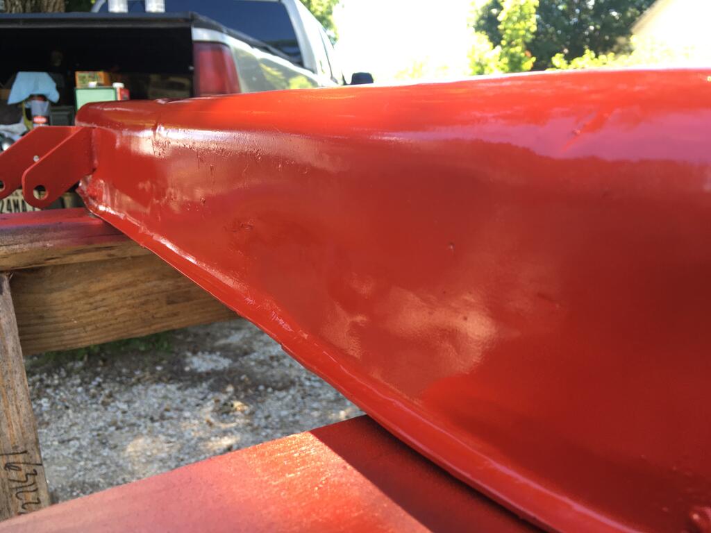

PbFlinger 66 #47 Posted June 22, 2021 The repaired section: Share this post Link to post Share on other sites

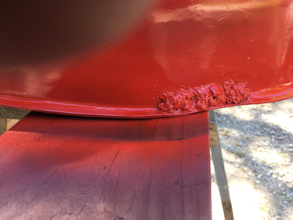

PbFlinger 66 #48 Posted June 22, 2021 Now for the unabashed truth. Honesty will put you on the back row every time. I should have cut out a bit more. After finishing the repair section I noticed a crack & thin section next door. I tried to fill it & it just kept running away. About 3am, after several weld/grind sessions and about a quart of Kentucky’s finest, I said, “Look here. I’ve got 100lbs of wire, another quart, and we can keep this up till noon.” After 5lb or so, we came to this agreement. It’ll outlive me, and only you jokers will ever see it. 🙂 1 Share this post Link to post Share on other sites
pfrederi 20,532 #49 Posted June 22, 2021 Some days are like that. You have more patience than I Share this post Link to post Share on other sites
PbFlinger 66 #50 Posted June 23, 2021 Aye, ‘tis a ting o beauty, as Paddy ‘O Furniture would say. Getting there. Share this post Link to post Share on other sites
